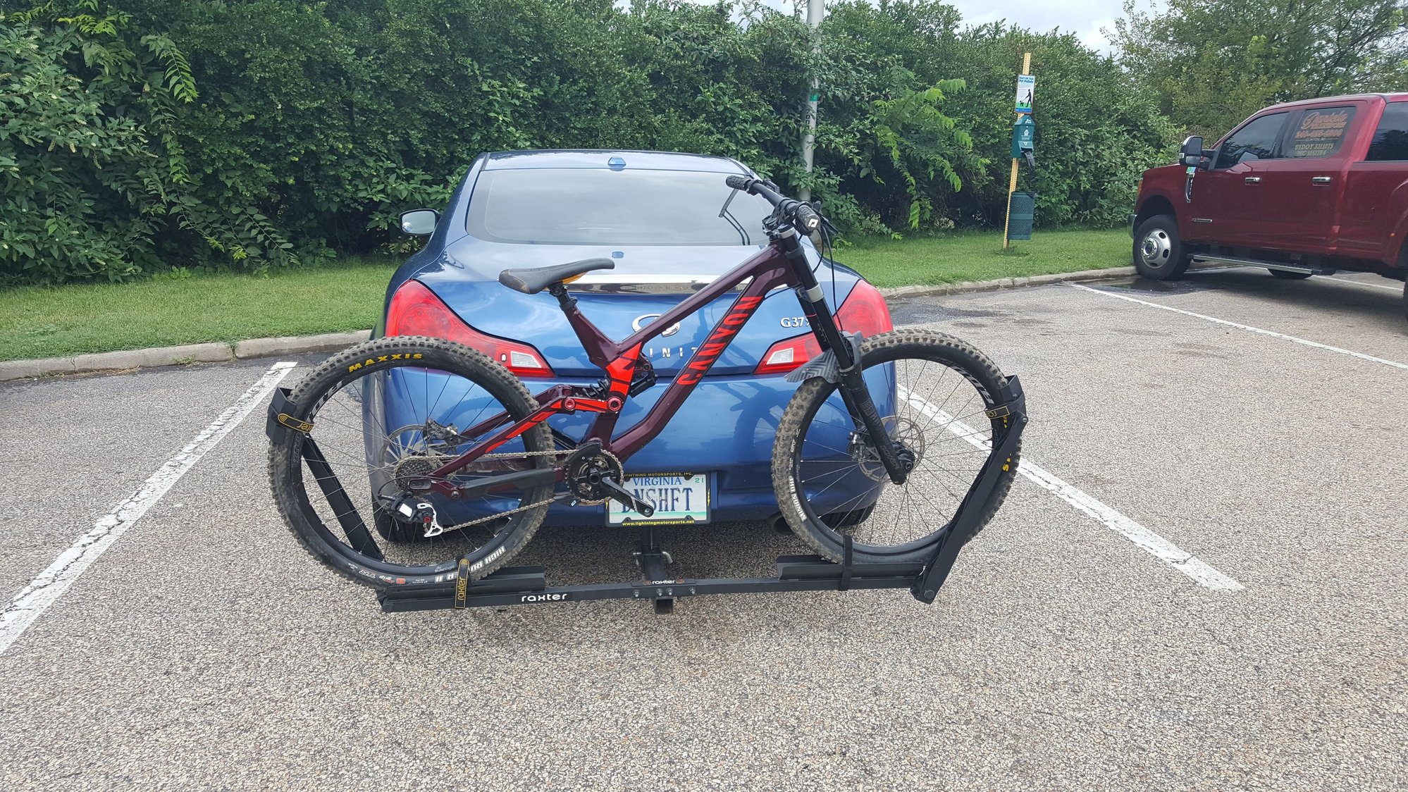

I thought I'd throw this out to this thread for some input. I've gotten to the point that my kid wants to ride with me! So i need a hitch that will fit two bikes..which means its going to get heavier. Since this DIY is mounted to the aluminum bumper, I am thinking not a great idea. I am toying with the idea of having a frame mounted hitch installed; it will let me carry a heavier bike rack and tow my motorcycle to track days.
The alternatives is to possibly get the hidden hitch welded/re-inforced or go back to SUV land. Anyone have experience putting more then 1 bike on this DIY? Thanks for the input.

Well, thats great to hear. I wasn't sure how solid the bumper connection was: I currently have a Raxter Single Racker (20lbs) and a trail bike (30lbs). I have tranported my DH bike several times, but I thought that might be the limit.
Which Saris rack did you use?

I had a similar setup on my RX8, which had an almost identical aluminum bumper reinforcement to the G37. I could jump up and down on that thing (250# at the time) without a problem. 2 bikes on a carrier would be a cinch. Remember, the thing is supposed to survive a 5mp impact with zero damage.
