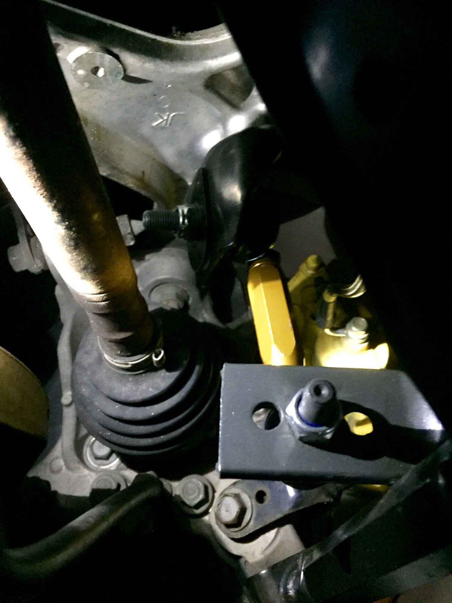

I recently heard a loud pop while pulling into my driveway. A few day's later I looked under my car and noticed one of my rear swaybar endlinks was hanging off. Apparently this is common with sedans with aftermarket swaybars. Hopefully I can help you to resolve this issue. I only worked on one side at a time and I suggest you do the same.

With your 14mm wrench, reach past the brake and loosen the nut (or two if yours aren't broken) on your existing endlink. You may need to use your vice grips to stop the shaft from spinning.
Remove old endlink and discard it and the nut(s).
DIY: Rear Swaybar Endlink Install-lulwvpq.jpg
Moog branded driver's side:
DIY: Rear Swaybar Endlink Install-kjuqmny.jpg
Moog branded passenger side:
DIY: Rear Swaybar Endlink Install-axvh9hk.jpg
Take the new endlink and push it through the TOP mounting position on the car and put the nut on with just a few turns.
Now, you'll notice that the other end of the endlink is not QUITE lined up with the sway bar. This is where I took the jack from the trunk and used it to help push the suspension up and thus allowing me to push the other end of the endlink in.
DIY: Rear Swaybar Endlink Install-n1tjdcs.jpg
Use the vice grips to hold the shaft-side of the endlink. Then tighten the 15mm nut with your wrench. The documentation with the endlinks said to tighten to 27 ft lbs. I did not use a torque wrench. You probably should.
Now repeat the process for the bottom endlink nut to tighten it as well.
DIY: Rear Swaybar Endlink Install-ubzudyi.jpg
