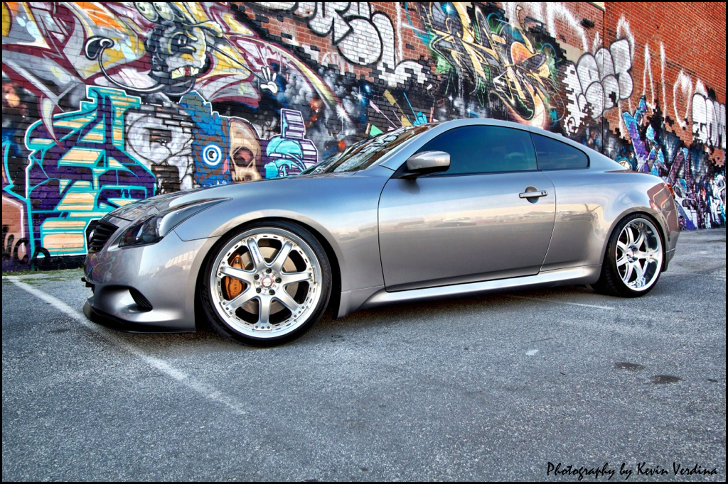

TEASER! ... Lemans Sunset Akebono Brake Calipers.*
Look what I did today .... Teaser,... Flame on!
Been trying to pick a paint color for a while. Finally decided to go with 2003 Nissan 350z Lemans Sunset.
I'll have more pictures soon once I finish ... only did the front calipers today because I ran out of paint for the rears, but I can already tell this is a total transformation. This paint turned out great in person and in the sunlight you can really see the metallic flakes.

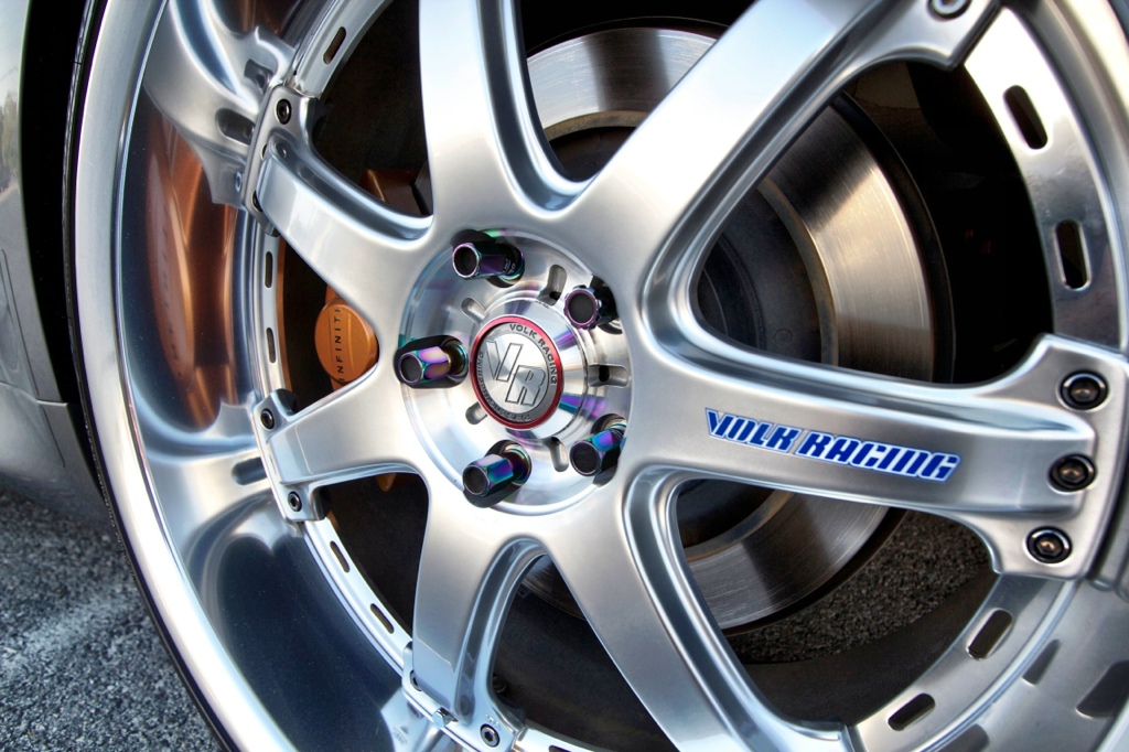

Finished Pics:

Here's another shot of the finally product. Photoshoot will come once I'm finished. Also updated in original post.
