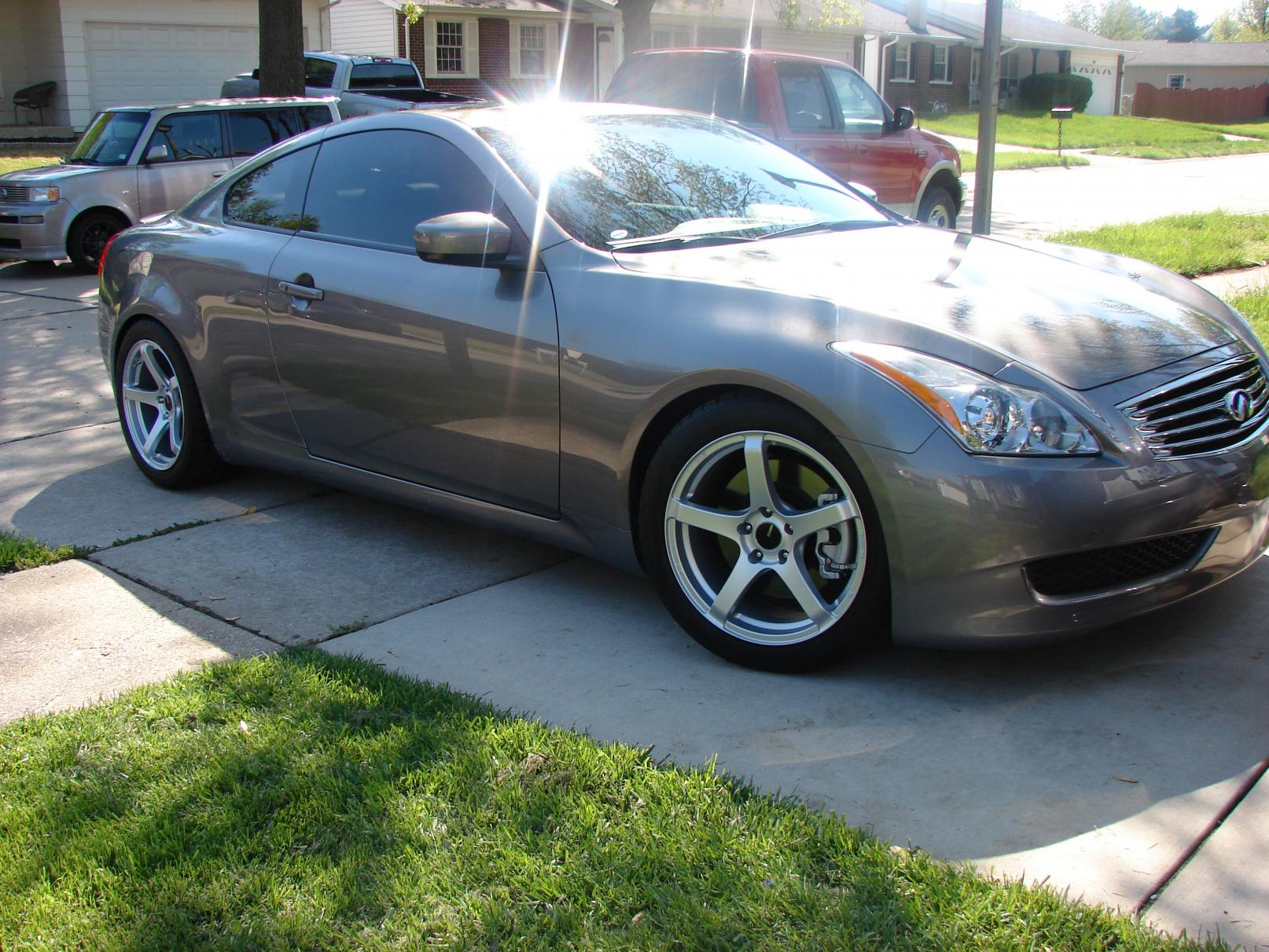

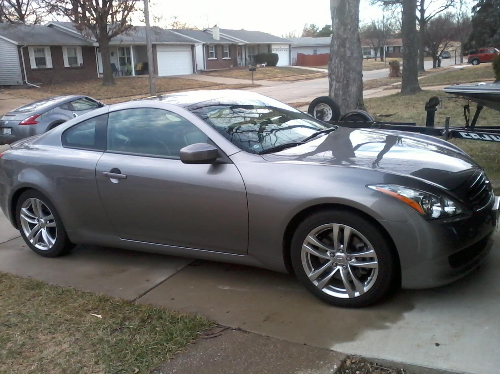

No, don't sand it. The hyper silver finish is a three stage application, if you sand through the silver anywhere on the wheel you're screwed. A mobile rim repair service can get a close match but nowhere near perfect. Google hyper silver wheel finish, and you'll have a much clearer idea of what you're dealing with. My wife just had all 4 wheels powder coated on her 370 for right around 500 bucks. That was in a dark metallic silver finish, not hyper silver though. Good luck! The clear was all jacked up on my OEM wheels, I just used it as an excuse to put something different on there. Before and after
