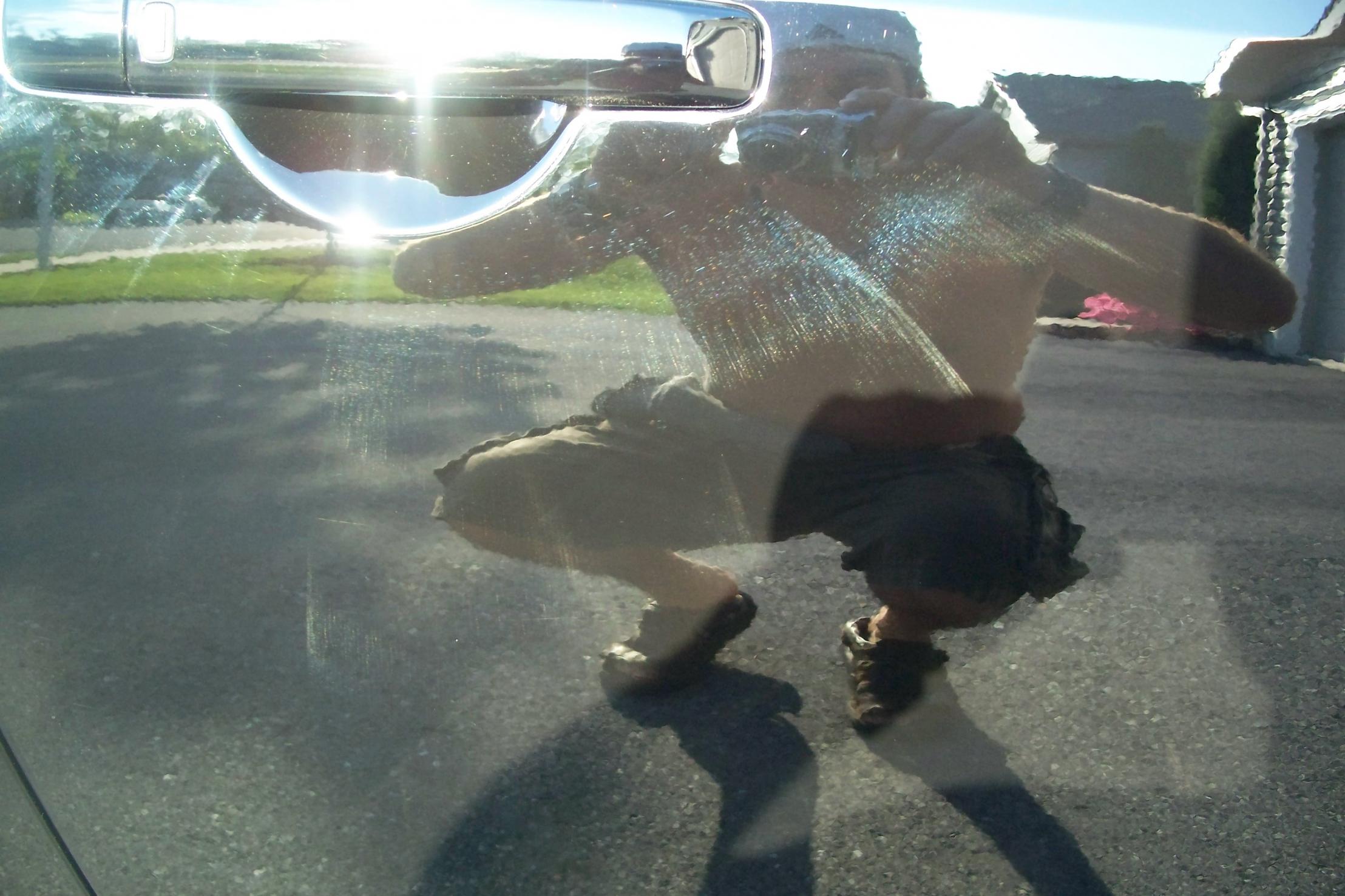

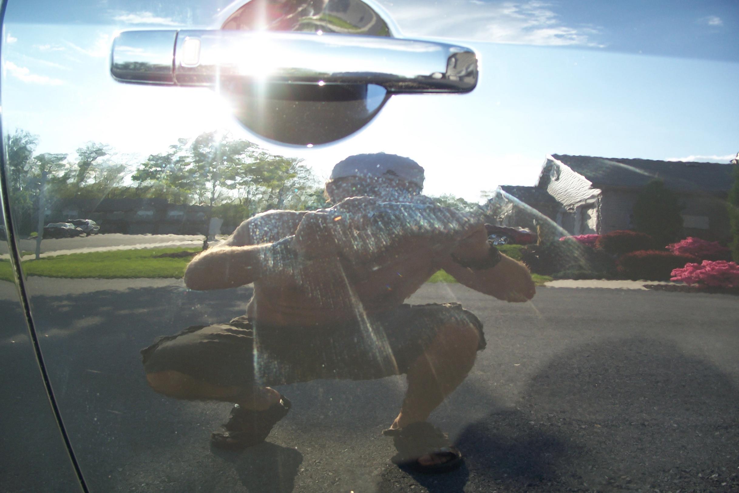

I just had my car detailed and I got a case of buffer burn. Any hints on how to get them out easily? He spent numerous hours on my car, but unfortunately he didin't get it right. What products shall I recommend and what are the steps the get them out?
Thanks.

Use some Menzerna Final Polish II (or any light cutting polisih) and a white pad. Should get rid of the micro-marring.
I can't believe he left the car looking like that

As a general rule of thumb, you should always ask if a detailer is using a rotary buffer on your paint. Any detailer who charges $125 for polishing probably doesn't know what they are doing and will leave behind swirls, holograms, etc. like you experienced. Most skilled detailers start their buffer work around $250 ~ $350 because they know how easy it is to screw up the paint.
Back to answer your question, following up with a finishing polish, such as the Final Polish II Gamedog mentioned or PO106FA, should take care of the holograms you are seeing. The problem is, they should be applied with a quality buffer and not hand applied. Your best long term solution is to invest in the proper products and tools to do the job right yourself. It will pay for itself in the first couple details you perform, it just takes a good amount of time to do right.
Hope this helps,
George
