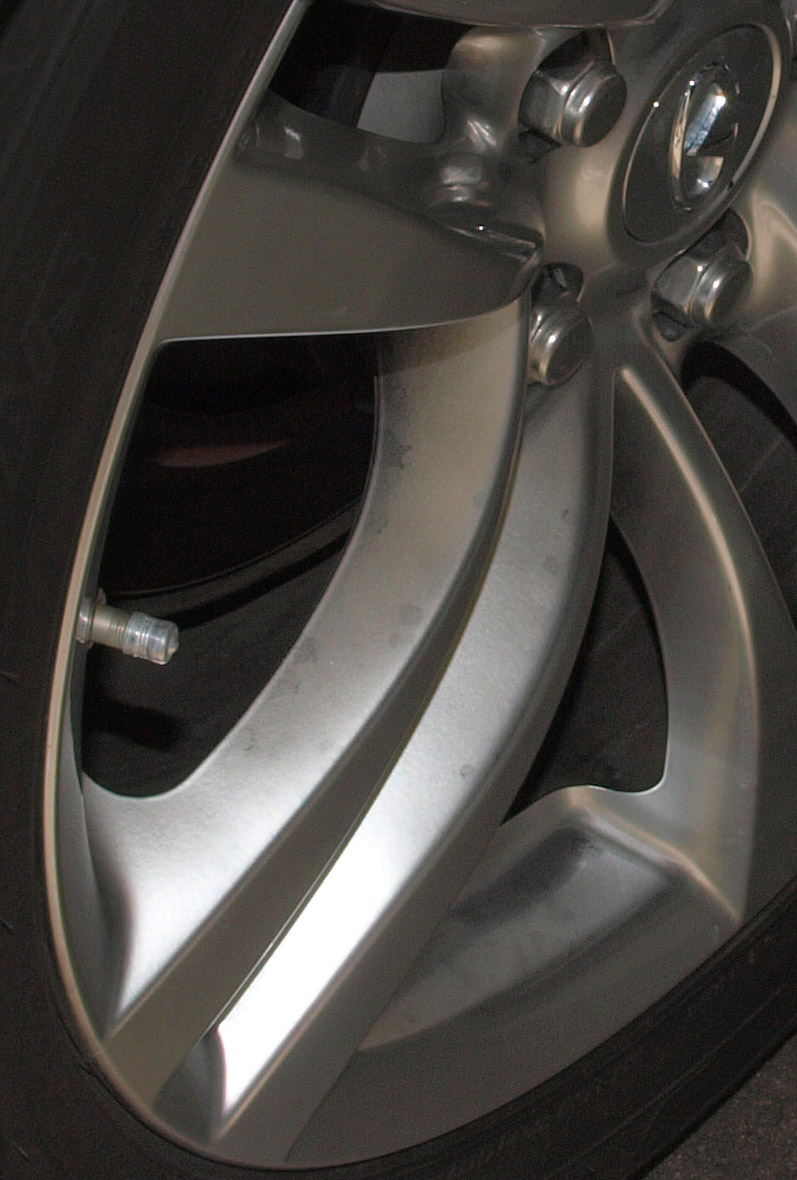

wheel black spots: remove via warranty replacement
Rec'd four new 18" wheels today from dealer via Infiniti warranty. service writer wrote "replace four wheels under warranty due to poor factory paint finish, primer bleeding through" p/n aluminum wheel-D0300-JL048. I wonder if black primer was put on w/ thick spots that the "titanium" paint could not cover properly? "Before" picture attached of typical spotting.

This happened to me today grrrrrr. It is from the wheel cleaner and it really ticks me off because I have been using it for years on my stock audi rims and have never had a problem. To anybody trying to fix this problem give up because your only gonna make it worse.The black spots are from the primer and the only thing you can do is to repaint them. I highly advise anybody with stock wheels not to use wheel cleaner on them. I guess this gives me an excuse to paint my rims black haha.

your center cap looks like crap too, looks like a harsh cleaner . good luck with results though.. worth a shot.
