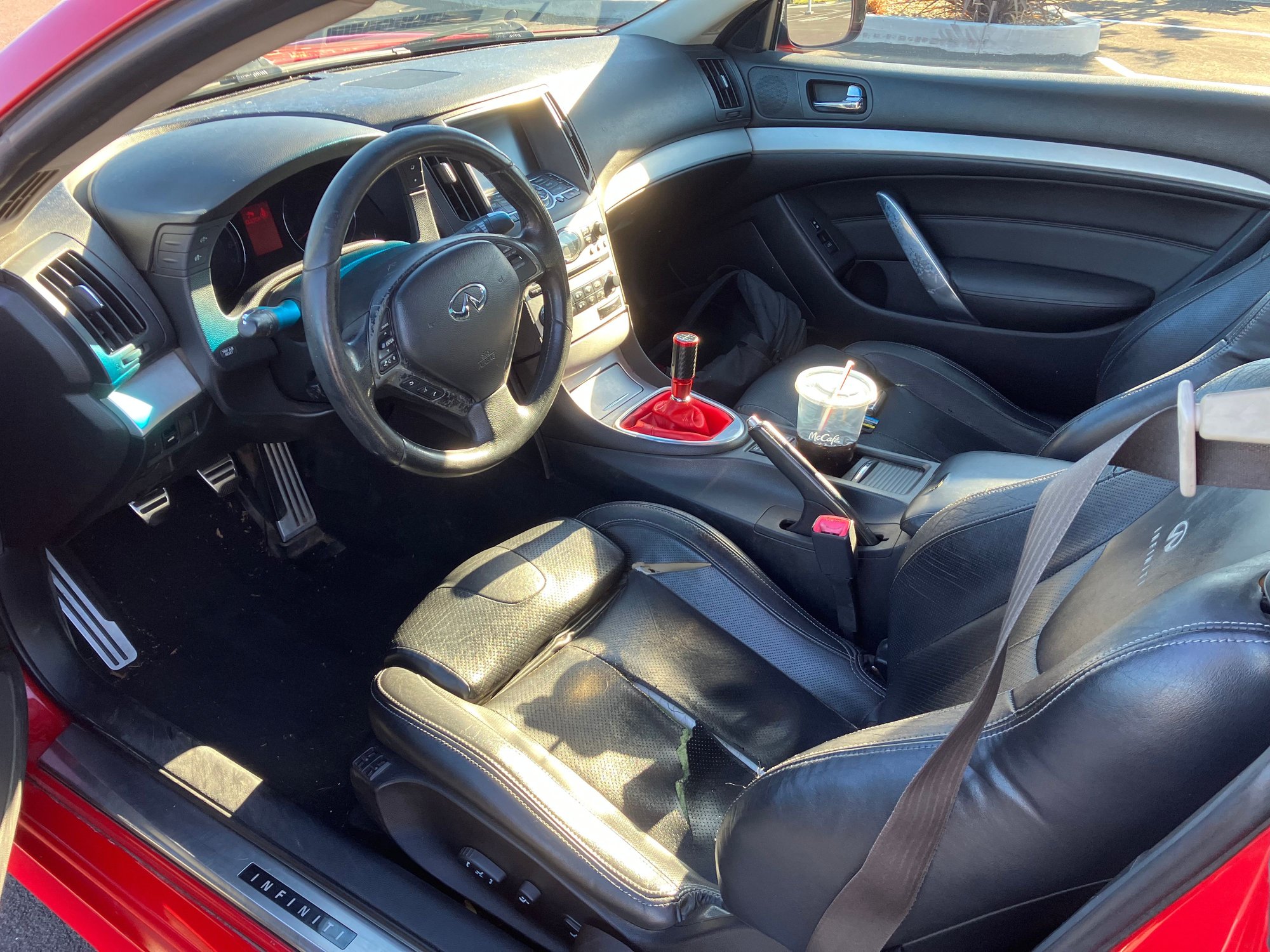

I'm digging the shift **** with the red accents, but not so much the red boot. Check out Redline Goods for quality leather, aftermarket boots. They also sell a leather wrap for the steering wheel, but wrapping the wheel is kind of a learned skill.

Thank you! Both seats will be redone eventually by a buddy that does upholstery and it’ll only cost me parts and a 6 pack lol the red shift boot and **** was in the car at purchase and no…I don’t dig the boot one bit. It’s very ricer to me so it will be addressed soon. I would eventually like to wrap the silver moldings in maybe a semi gloss black and re do the gear selection sticker. The steering wheel will one day be replaced with something tasteful.

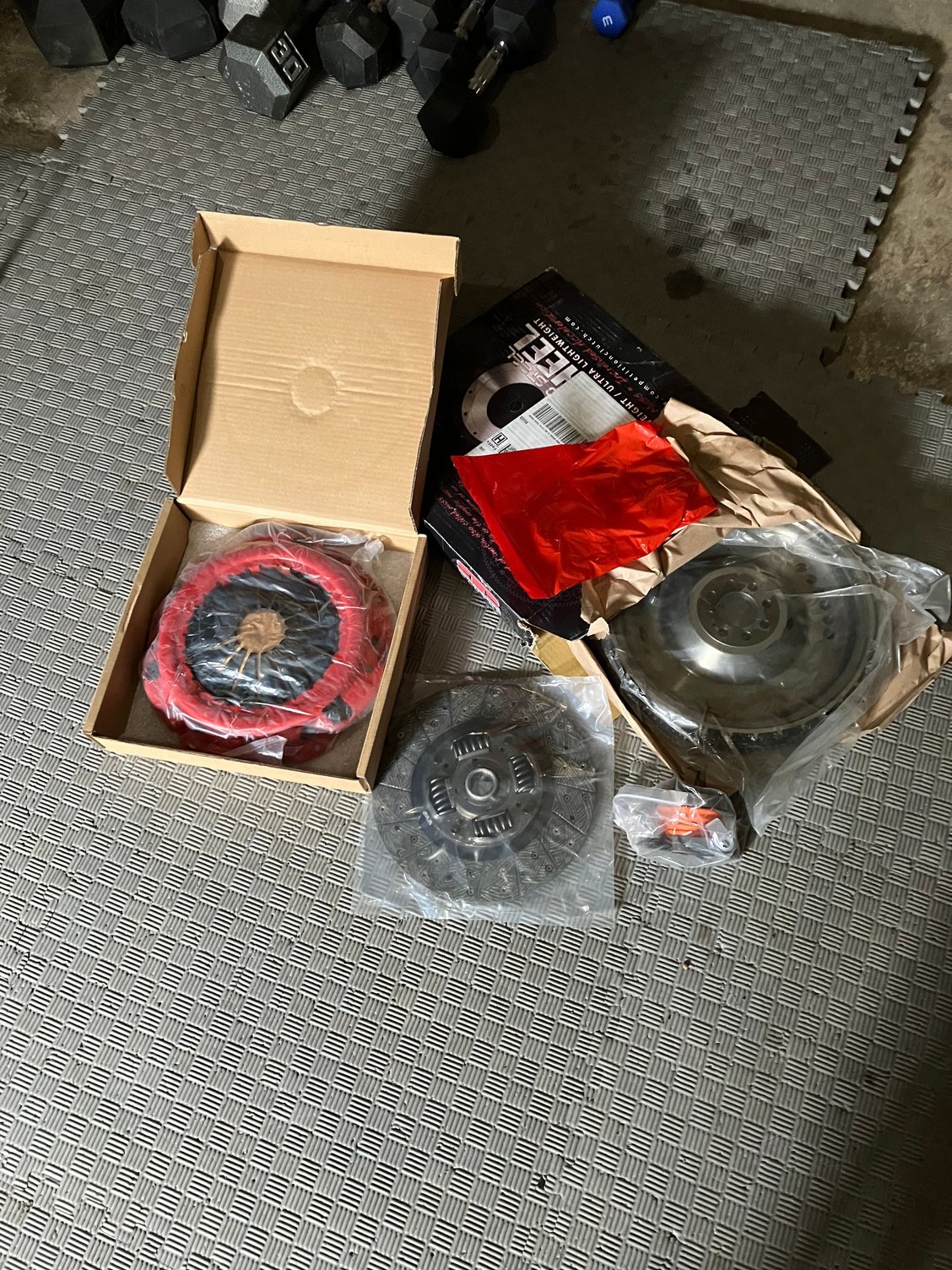

It’s that time! I have the z1 clutch and pressure plate, iron flywheel weighing in at 27lbs (I don’t want the chatter) JIT CSS and a new transmission mount that I forgot to put in the picture. In the next few months I’ll get rid of the ugly red shift boot, install a short shifter and a new shift ****

New clutch & flywheel, and a short shifter. The only thing missing from that list is the RJM clutch pedal assembly. The price is right, the product is darn near perfect, and the install is (probably) DIY. All those components together, and your driving experience will be next-level compared to stock.

i forgot to mention that I also purchased a rear main seal and new flywheel bolts (red bag in picture) I heard some people say I could reuse the bolts and others said don’t do it. They’re cheap so I figured why not. All of this will be going in tomorrow so I’ll be back with an update within a few days.

I actually went with Z1’s street performance clutch and pressure plate, an iron flywheel (27LBS) for noise and comfort since it’s my daily, JIT CSC, a new trans mount, rear main seal and new flywheel bolts. I didn’t go with CZP just because when I asked the rep if it would handle full bolt ons, he said it should… no this won’t be boosted or anything crazy but down the road I want CAI, headers and full exhaust and eventually a cam. The Z1 setup is rated for 500TQ which I’ll never get close to but I wanted that extra safety net for when I decide to add performance mods. I put K&N drop in filters in it but I don’t really count that as a performance mod. I didn’t do the line or the master cylinder but if it goes out I’ll get it done.
I’m pretty much done with the break in period and I can say that at first the clutch pedal was much stiffer than stock but after breaking it in it’s softened up to where I hardly notice it. I notice the bite it’s got more than anything haha the way I would describe it is if you’re learning or not familiar with a MT don’t do it. If you know what you’re doing then it’s very streetable. My 9 year old son says it feels like the car just wants to go I’m very happy with the new setup and before summer I’ll have a short throw shifter installed which I’m very excited for.
