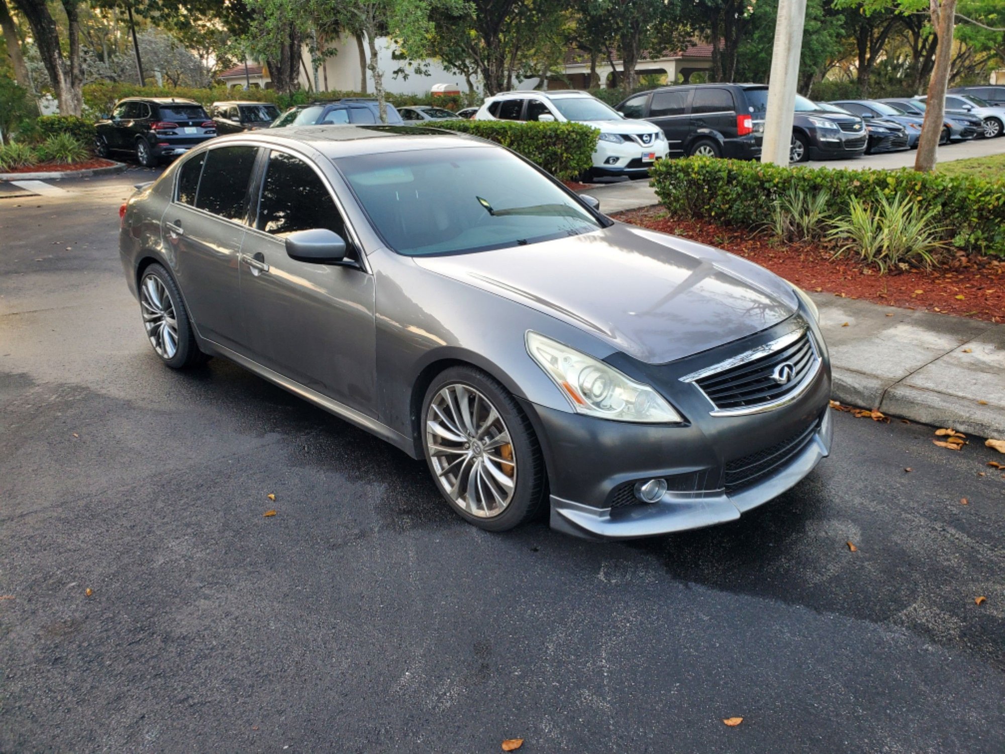

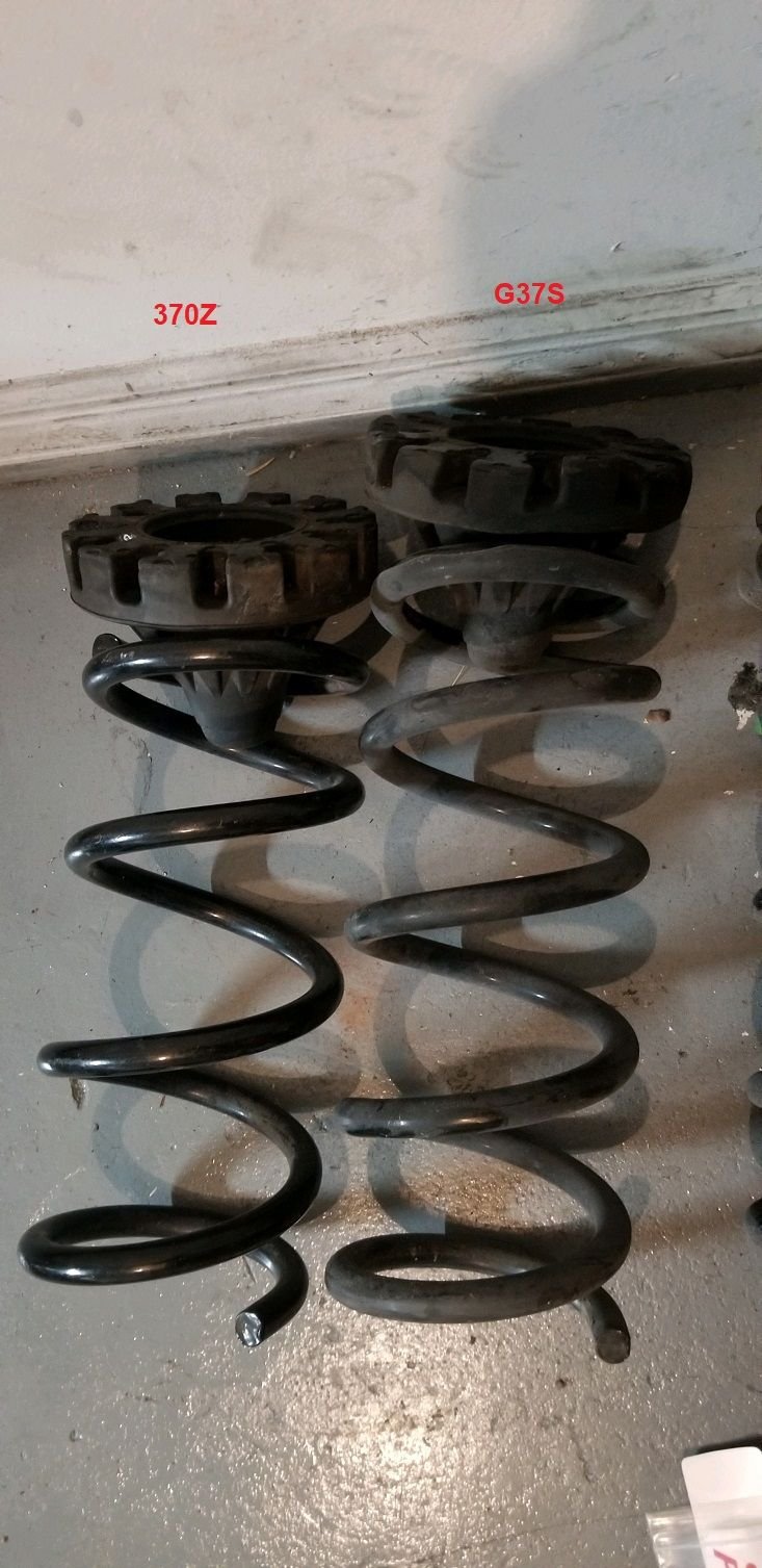

Here's an update from the dead:
Added Z suspension, this was to replace the blown fronts I've had since I bought the car. I went with camber and rear toe bolts for more angles at the rack since my toe was maxed.
Here it is with the Z suspension
And with just the front Z
Old Jun 17, 2021 | 09:58 AM

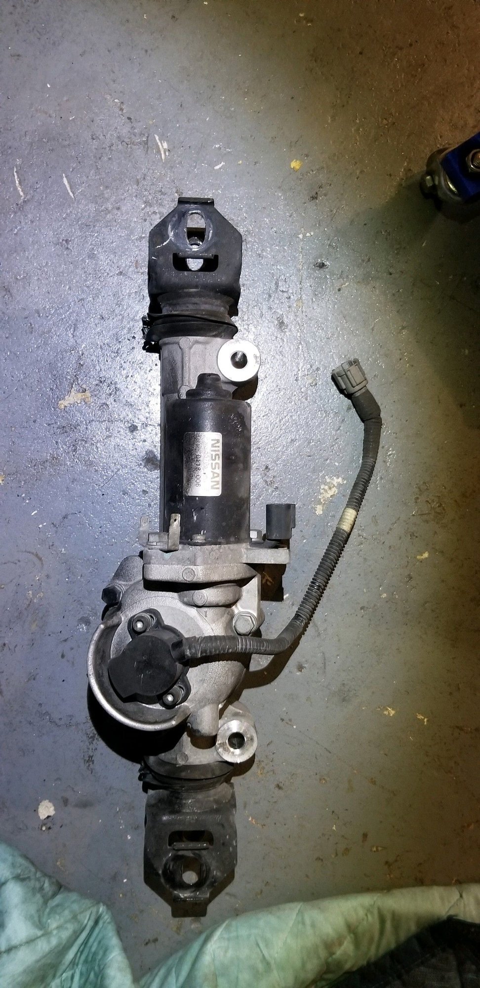

On another note, It looks like 4WAS strikes again in differences. I bought a toe bolt kit for 370z/G37 only to find out they're a bit short. I left one of the shims out for now to get enough clamp however I'll have to contact SPC to determine how to move forward. Will need a longer bolt
On another note, here is what a 4WAS rack looks like:

Originally Posted by deep0542
Z suspension looks perfect on the G! Is this regular base model strut/shocks/springs or did you go for sport/Nismo?
Its Base model suspension.
In my opinion the Rear looks amazing but then the front looks too high. I suspect Nismo Front springs and Base rear springs would give that badass drop and level it at the same time.
