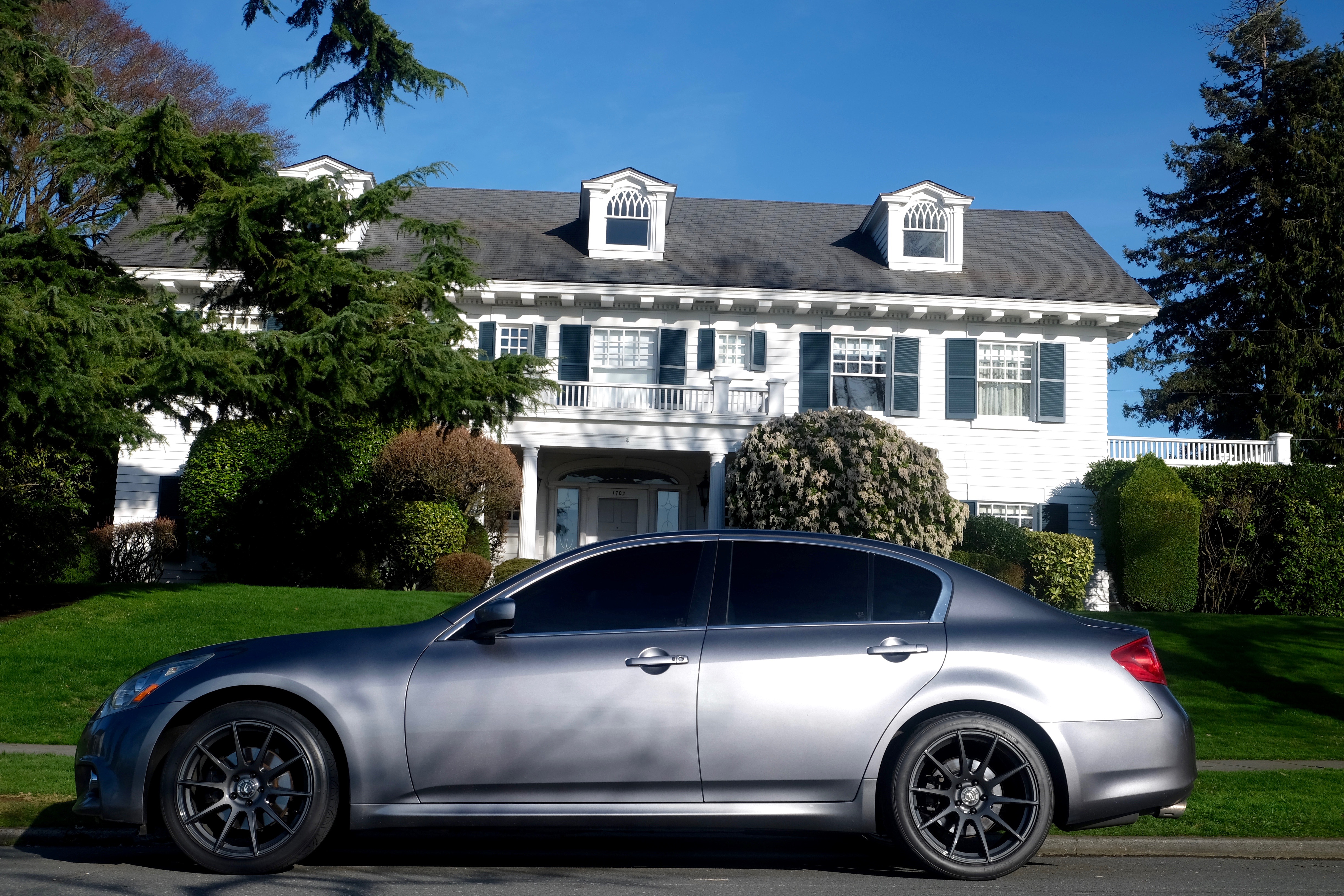

So it begins...Ignoring that nagging voice, that never ceases in my head, experiencing some apprehension about tampering with a G AWD sedan, today I've thrown caution to the wind - No guts, no glory.
2010 Graphite Shadow higher mileage AWD G. A former traveling salesman's car, 114k - Amazingly the car still feels tight...already owning a 2008 G35x since new, and stock, I decided to acquire a 2nd G to tinker with...yeah, that's it.
Hanging out on the forum since acquiring the '10 last week, and undecided just yet about springs, and or coilovers, and wheels, I somehow instinctively followed that voice which said - Hey, check craig's for some used 19" 370Z wheels.
No luck - But there was an ad from a guy who apparently acquired a set of Forgestar CF10's and new Nitto Invo's for his G37 sedan 5k ago - He'd sold his G two weeks ago. In all my life, some 30 plus cars/trucks, and a heckuva lot more years than I care to remember, have I ever considered buying used wheels/tires....well, aside from the set that came attached to my first ride, a '56 Chevy. But this combo checked out, complete with the buyers original purchase receipt - just last year the combo had set him back some $2800 - New
Being further incentivized by a sellers discount, I wondered, hmm perhaps every used car deserves used rims/tires?

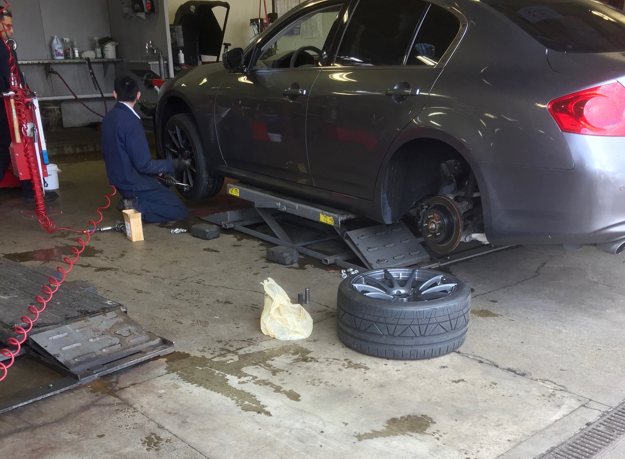

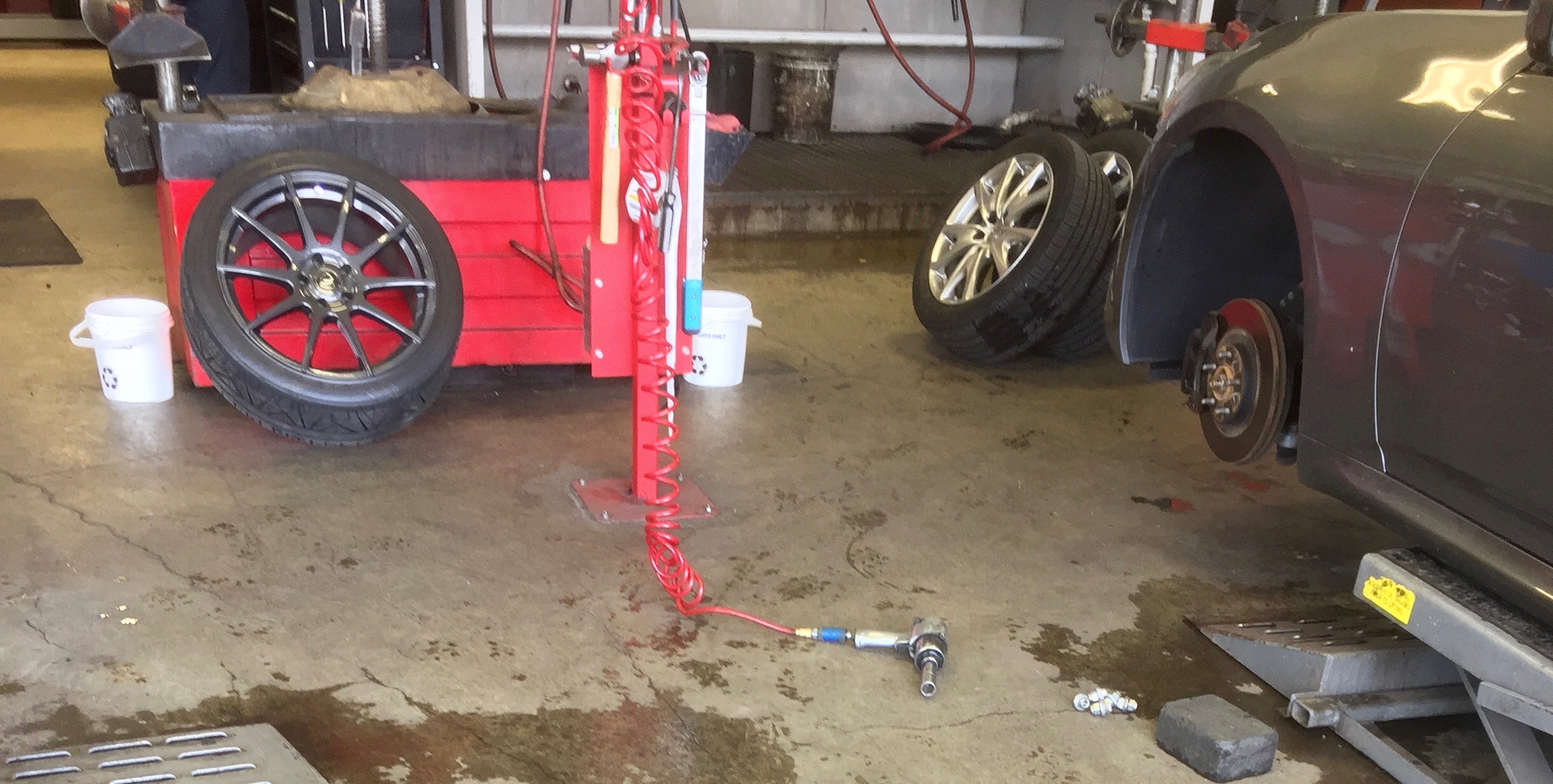

Seller and I agree to meet at Les Schwab, who for a price, agreed to do the wheel swap.

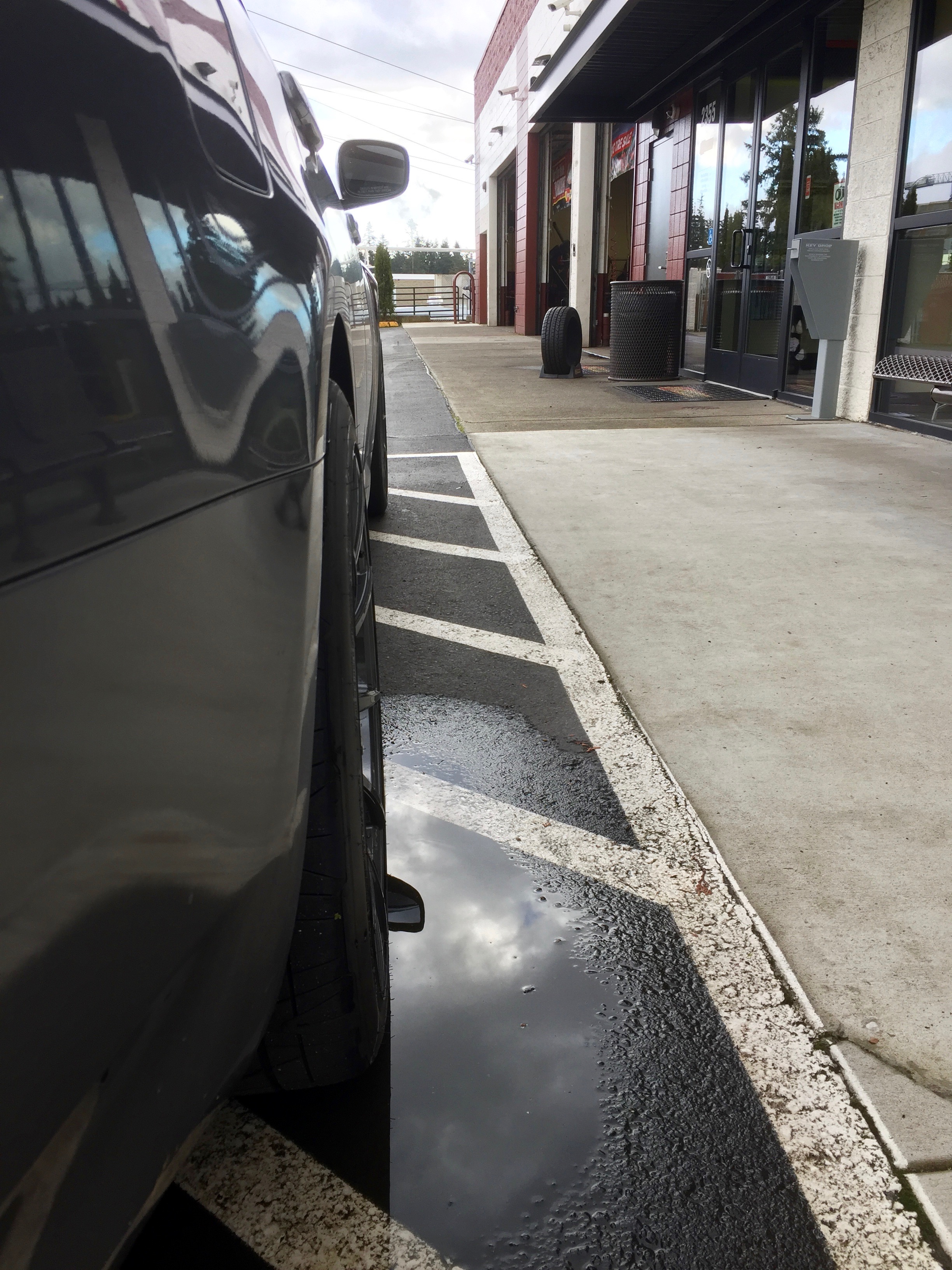

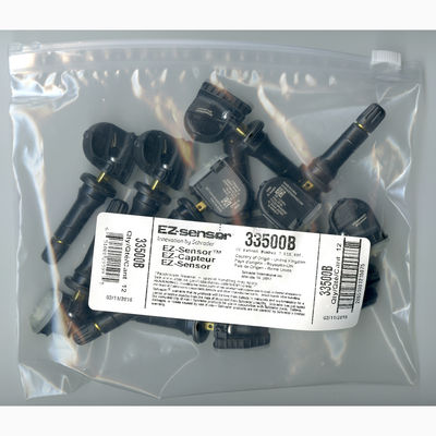

Since I'm keeping the duckfeet, for winters, at the shops suggestion I opted to install Schrader 33500 TPMS "EZ Sensors" - programmable at 315/314.9/433MHz
$245 for the set? - Okay, not so "easy" on the wallet I thought...Having never replaced sensors and having no idea what OEM sensors cost I agreed to the Schrader's. Returning home I would later discover Amazon has them for $43 each, but Les is warranting them for an additional year.
New Black tuner lugs and hex key, a $26 per wheel swap, and an additional $403 later it's duck feet no more.

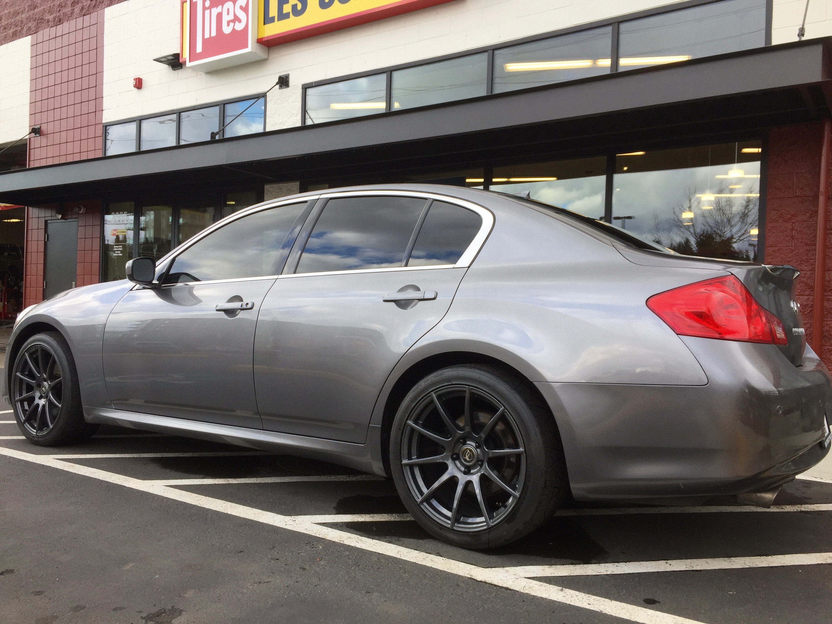

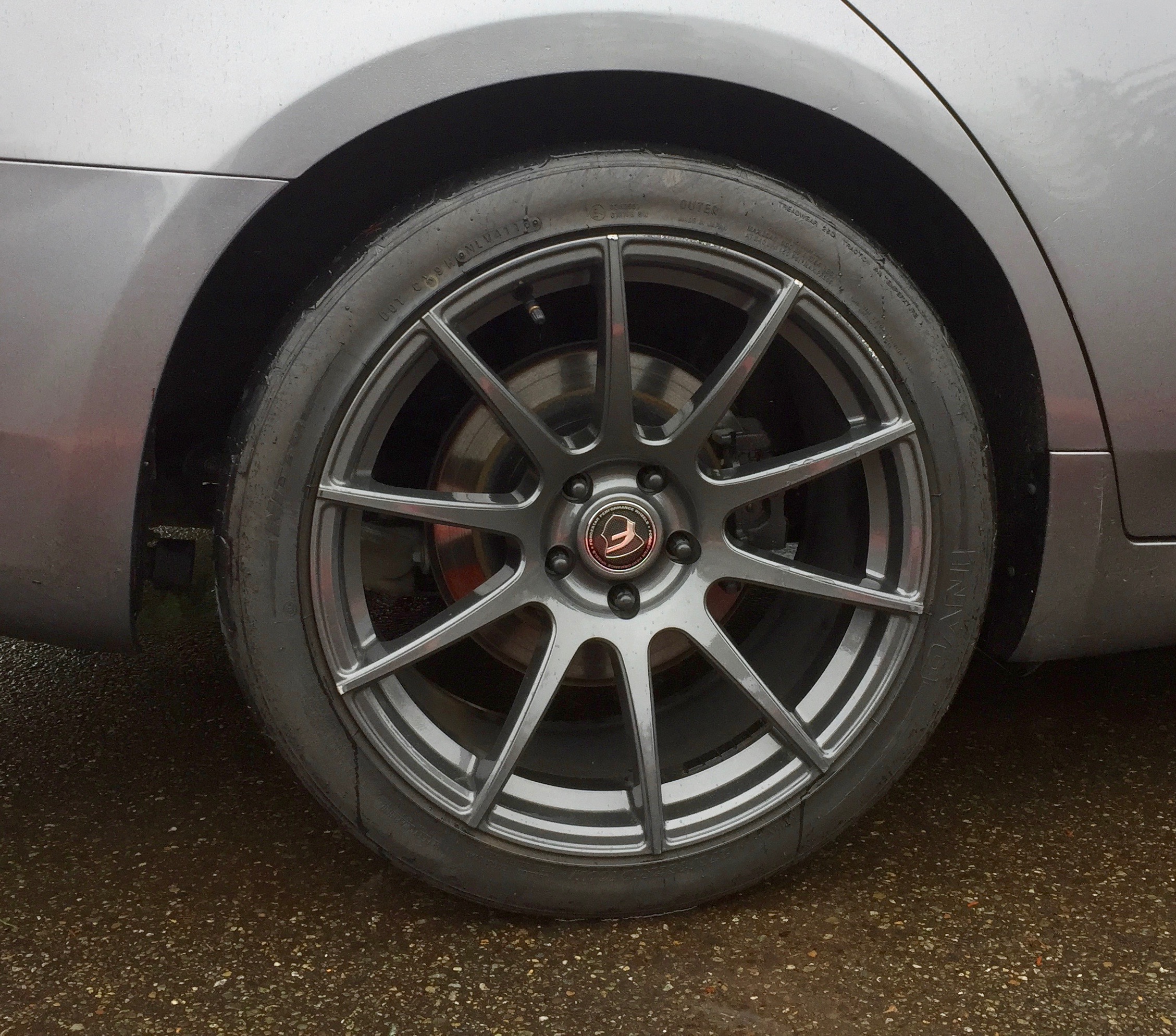

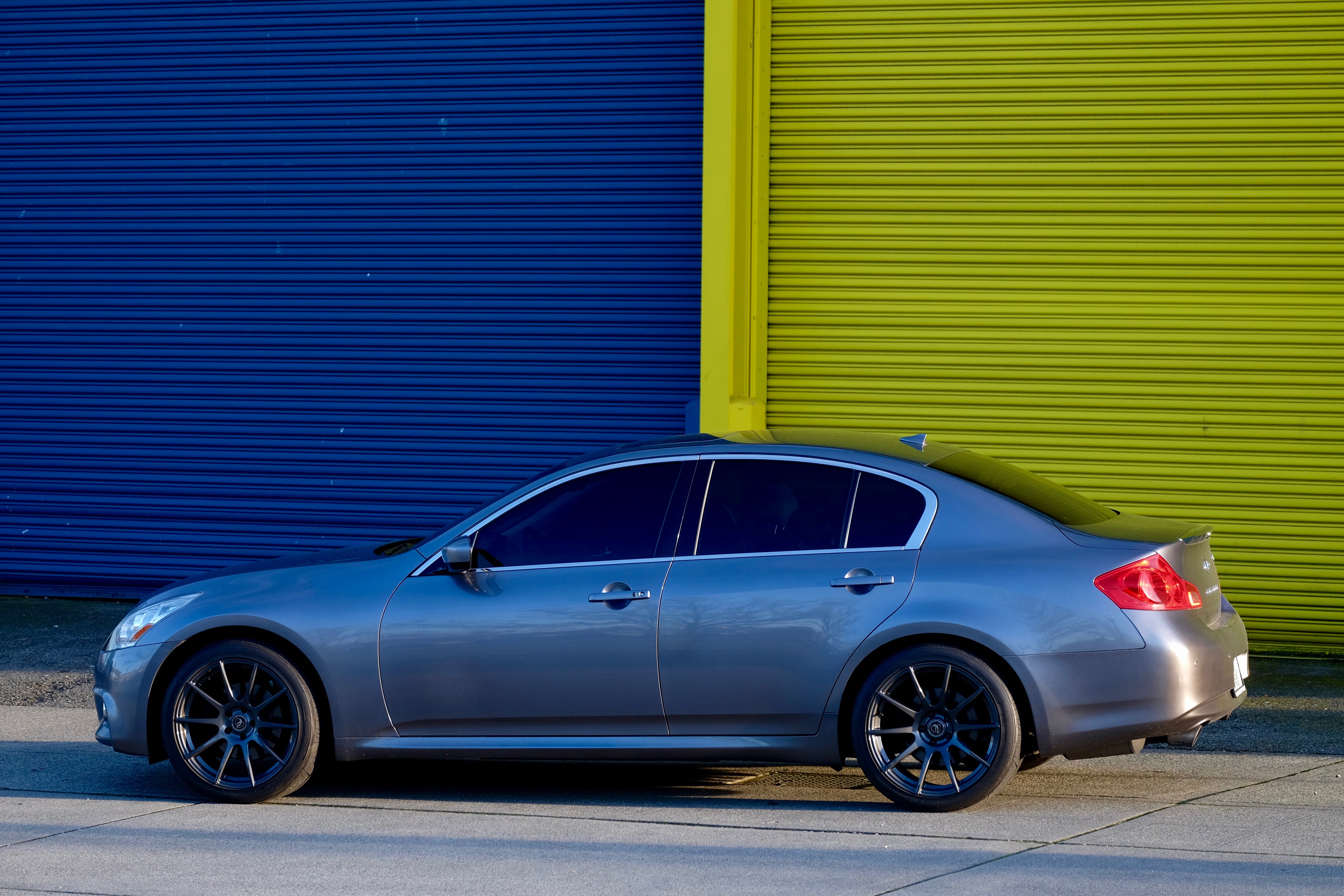

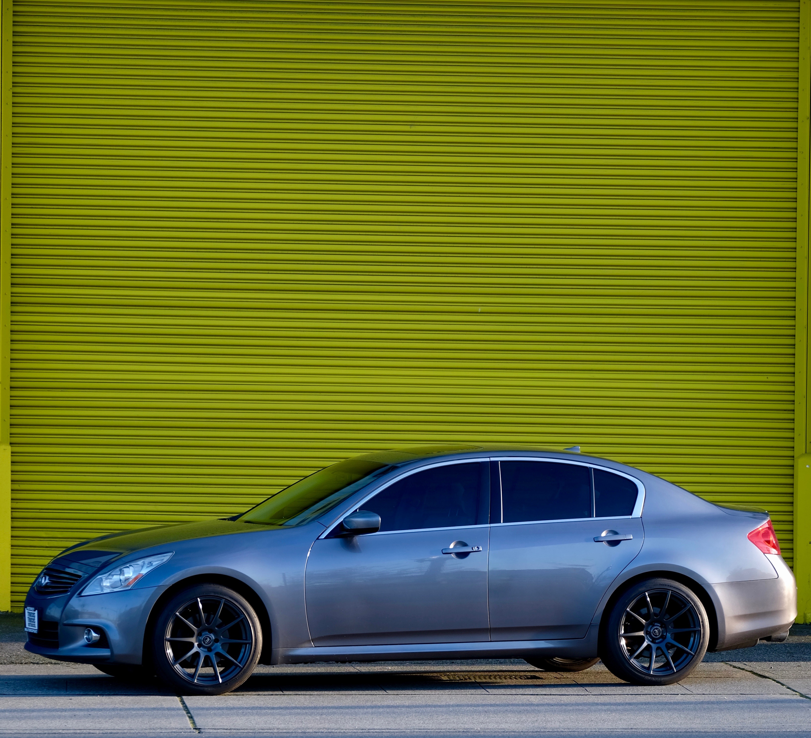

setup:
Forgestar CF 10
Nitto Invo
F: 19x9 - 245/40/19 ET35
R: 19x10 - 275/35/19 ET41

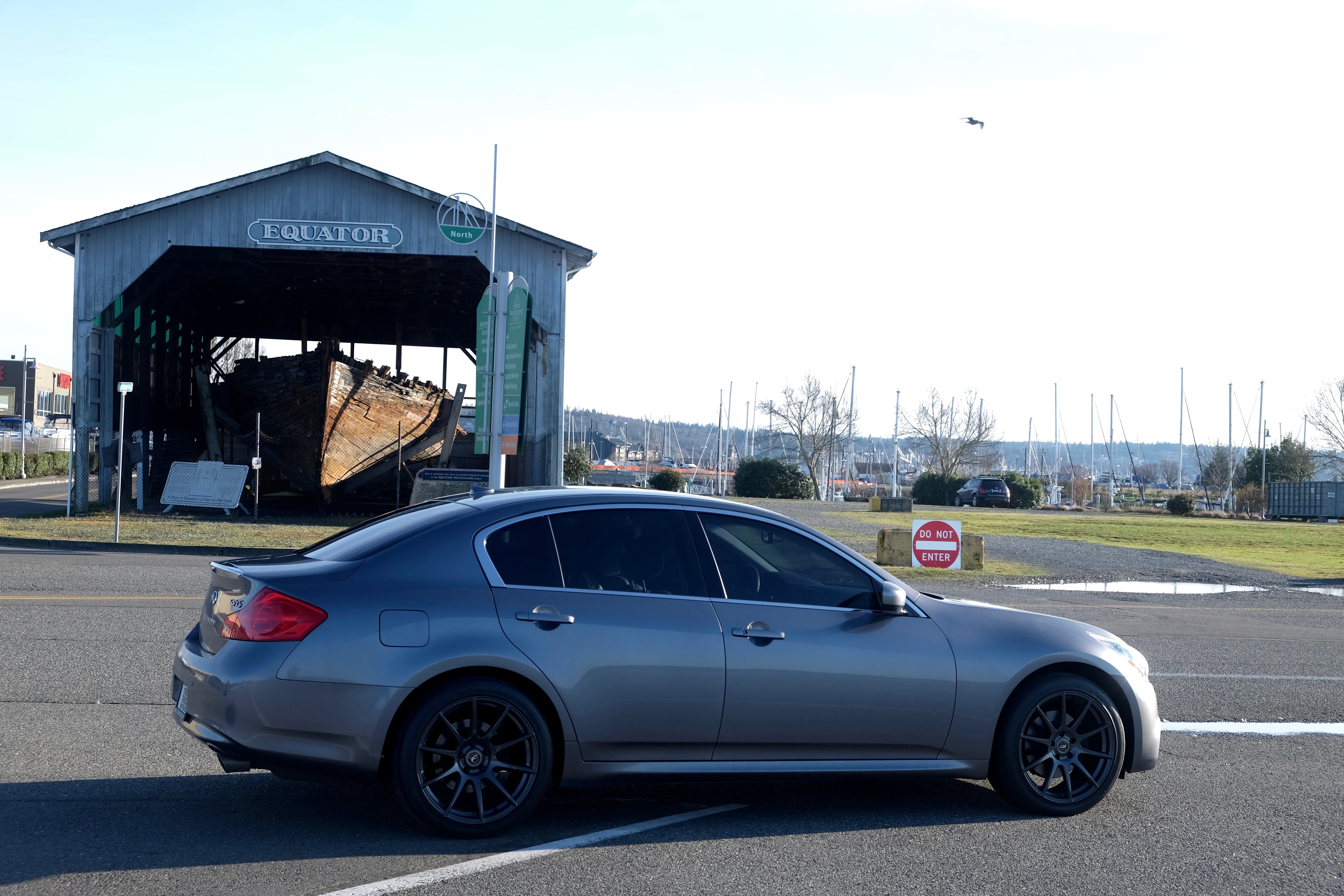

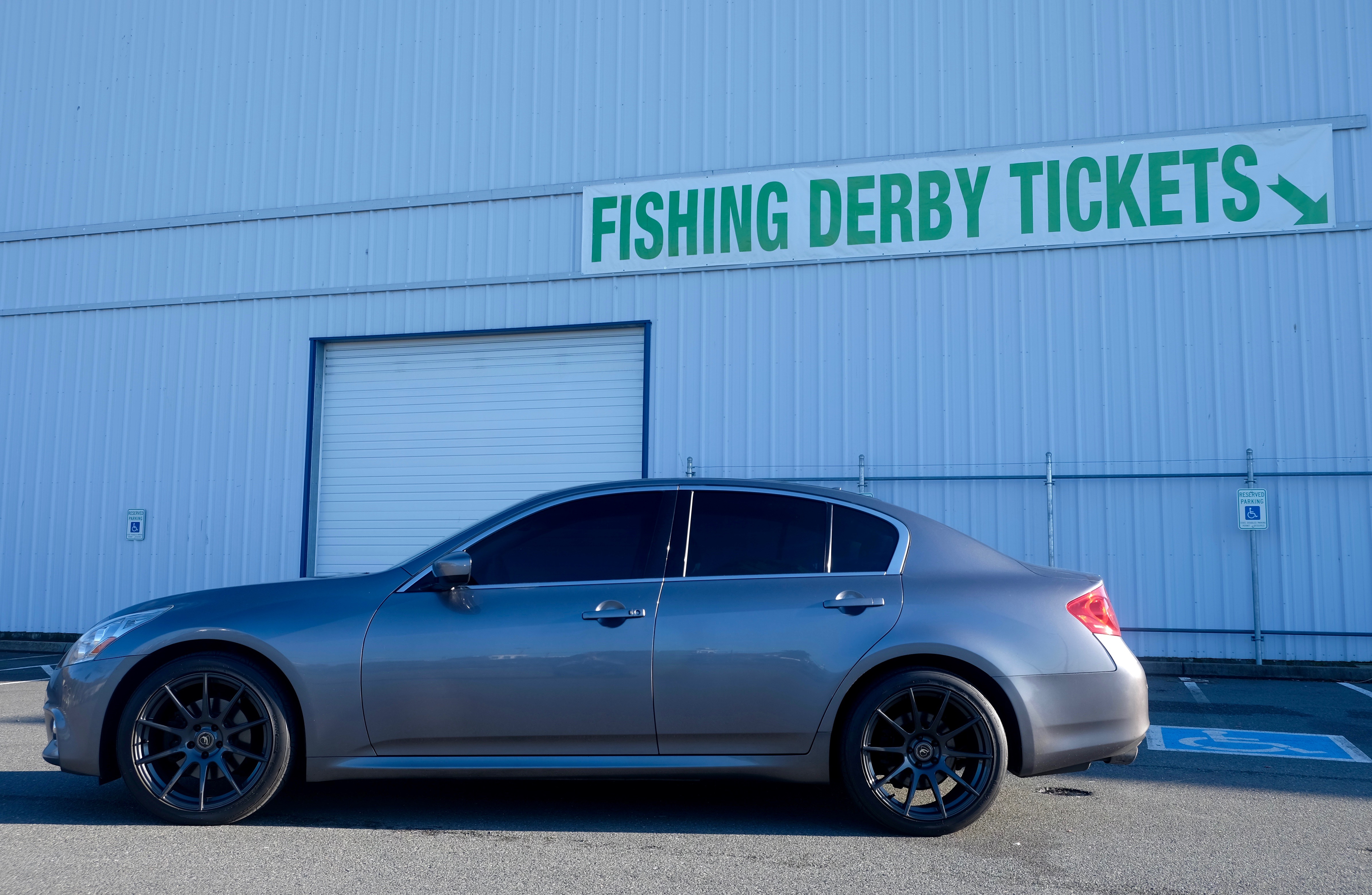

With a stock suspension and departing Les with a shorter sidewall than I'd arrived with, I anticipated a slightly taller wheel height gap...but not this gap. Okay, I'm now offically incentivized to place more money into the pit for springs and/or coilover's sooner than anticipated. Feel free to tell me now that this is the part where like my first Boxer named Humphrey I begin to get owned...this time, by a CAR
....it's okay, I've been here before...I can handle it.

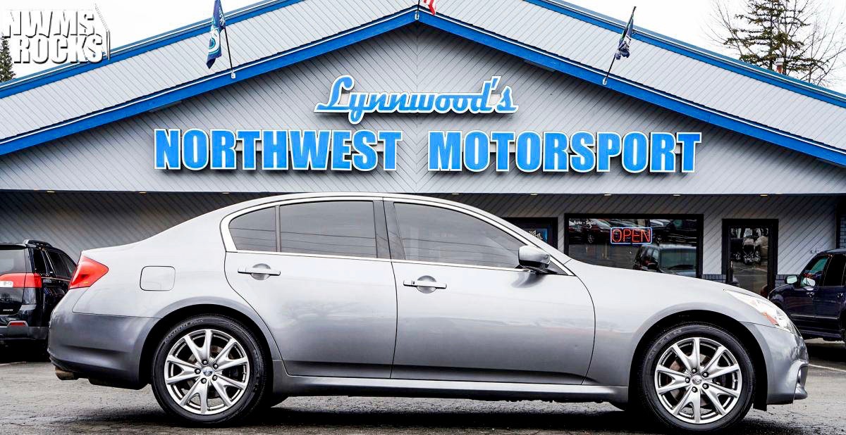

1 week ago - the 2nd owner am I

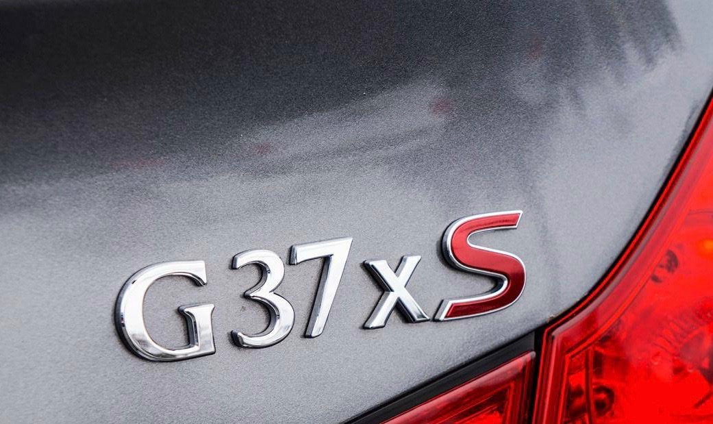

new rule - a sport is not a sport when it's preceded by an X

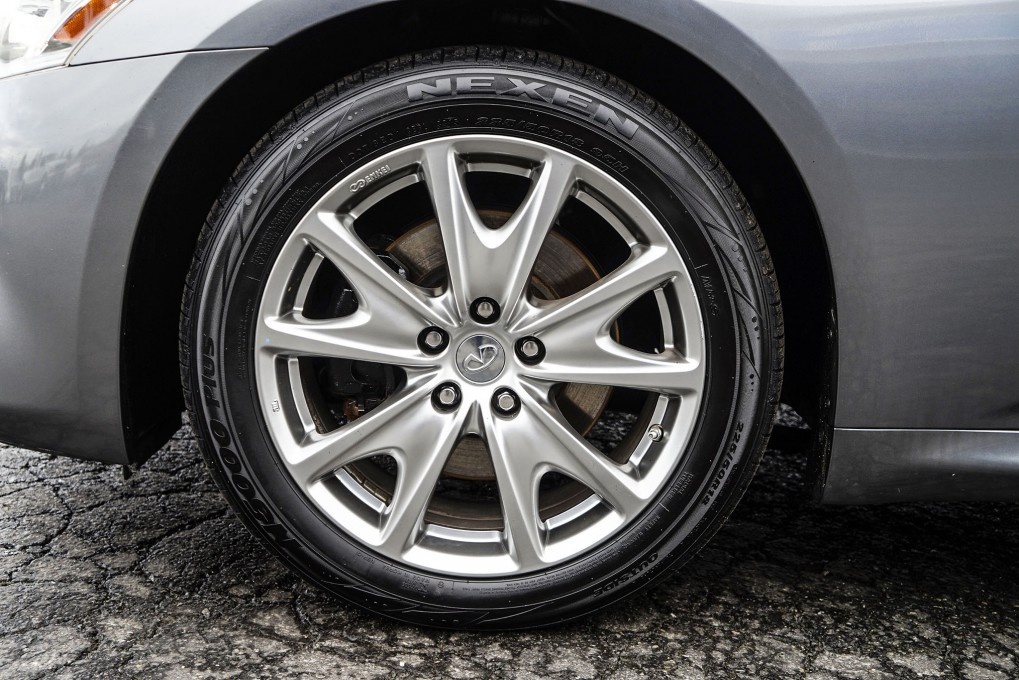

after 114k can a duck get a rest?
not so "ez" is holding a secret
let's get this party started
extra meat
les lot1
les lot2

Rear
Front

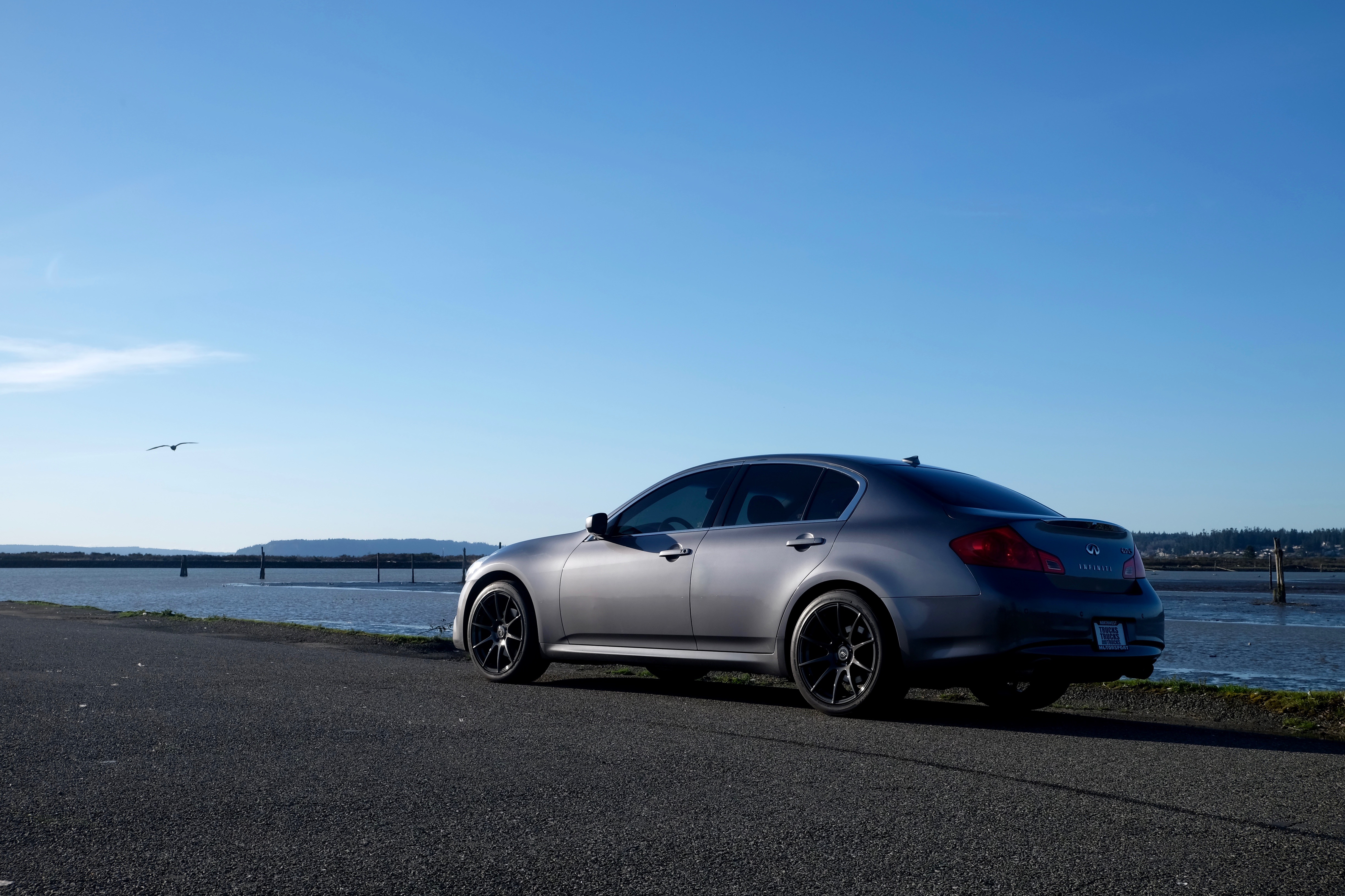

and of course no car trip could ever occur without that obligatory stop for a walk by the neighborhood lake...demanded of course, by Humphrey4...H....uh we're here H.

Okay, I returned home higher than when I left...but she's absolutely positively much more fun to drive now.

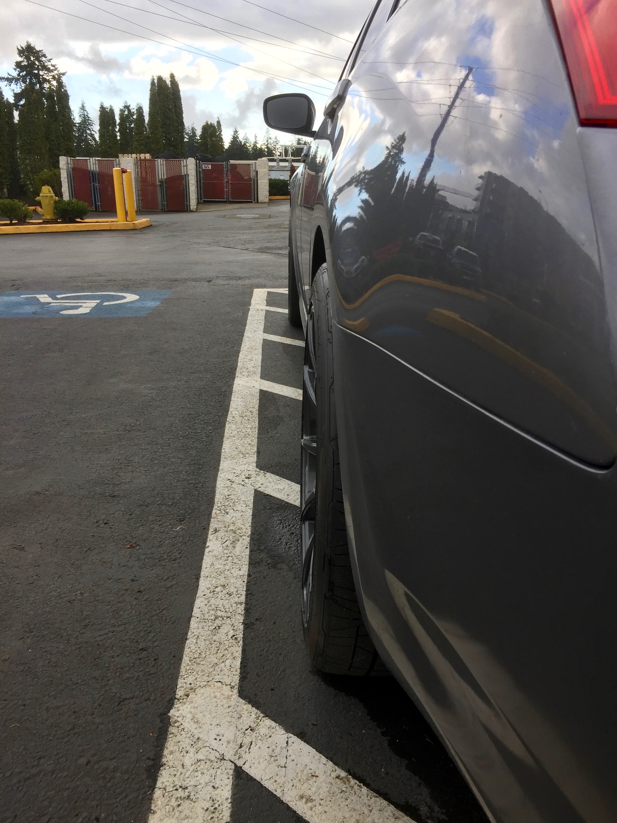

When looking out your driver's side-view mirror as you drive, do you see the rear wheel/tire? Because you really shouldn't. Car looks great, but will look better lowered 1.5", closing the gap to a reasonable consistency, and pulling in that rear poke.
Swift lowering springs on the AWD Sedan... least intrusive, least expensive drop-mod available for your car.

Everything I've read here on the forum suggest the most I could expect from Swift coils is a 1" drop in the rear. Obviously that won't present the visual drop I'd prefer. If there is a coilover that allows a further drop for AWD applications without compromising ride or AWD I've yet to discover it, and I'm very open to suggestions.

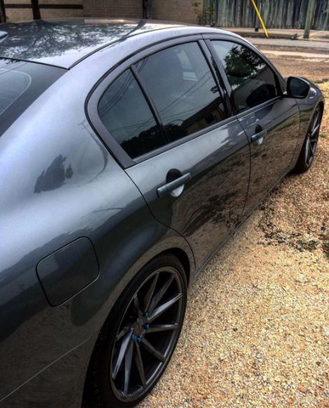

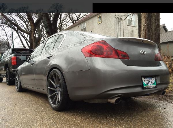

If you are looking for something minor that may affect the overall look. Springs as already referenced, or a set of coil overs depending on how much of a pit you are wanting to turn this car into or what your end goal is, as they allow for much more fine tuning than springs would.
As much as I may get shot for saying thing, if it's done right a very thin layer of night shade on the tail lights barely affects the light output of the tail lights (which is already brighter than most vehicles anyways) makes the tail lights blend in with the gray of the car more. The second option is to open them up and paint the inside.
Secondly, you may want to consider vinyl wrapping the chrome to black or to match your wheels.
I attached a couple pictures for you to see how it looked when I got mine done.
I also can't talk enough about how big of a change sway bars did. I personally had went with Hotchkiss

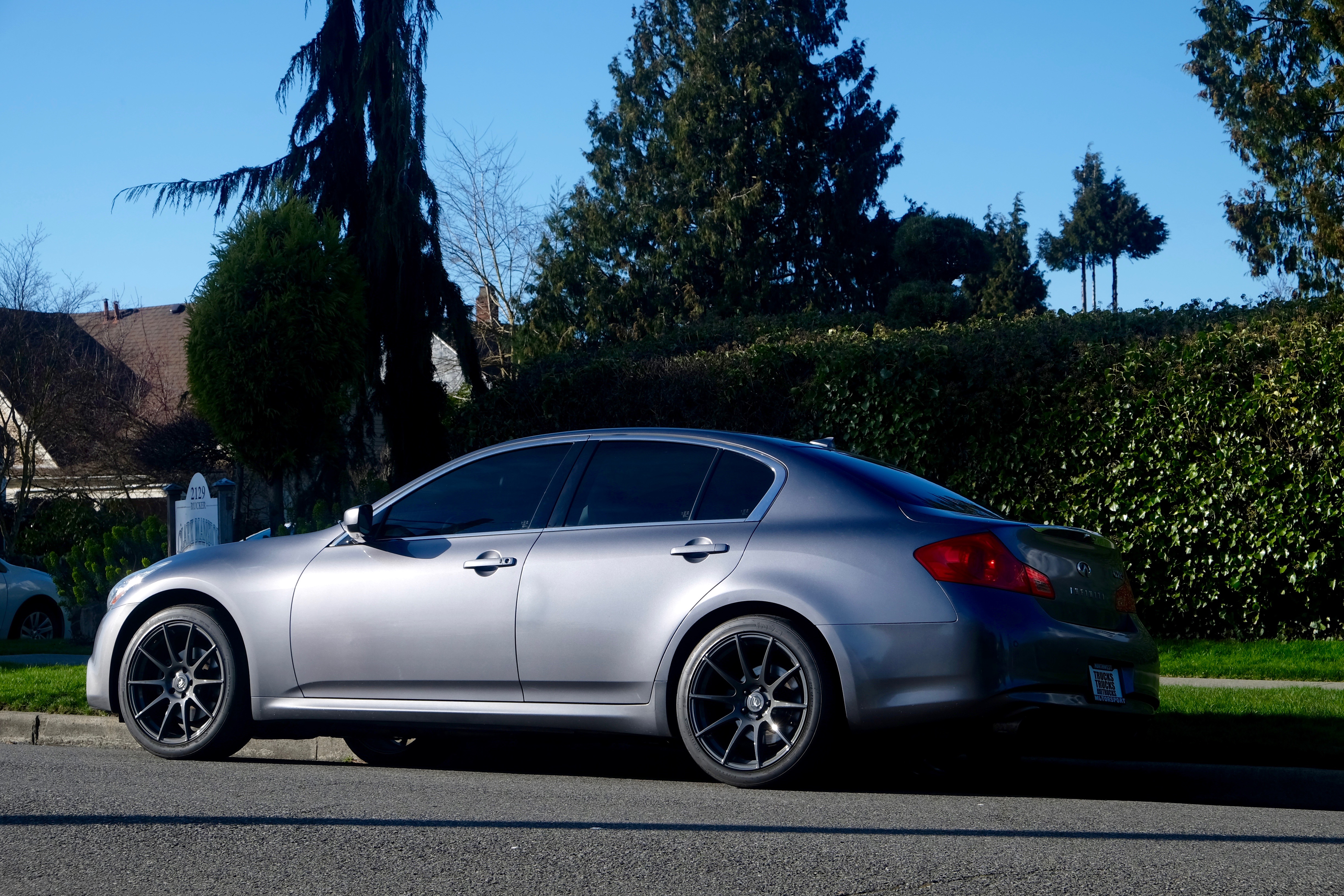

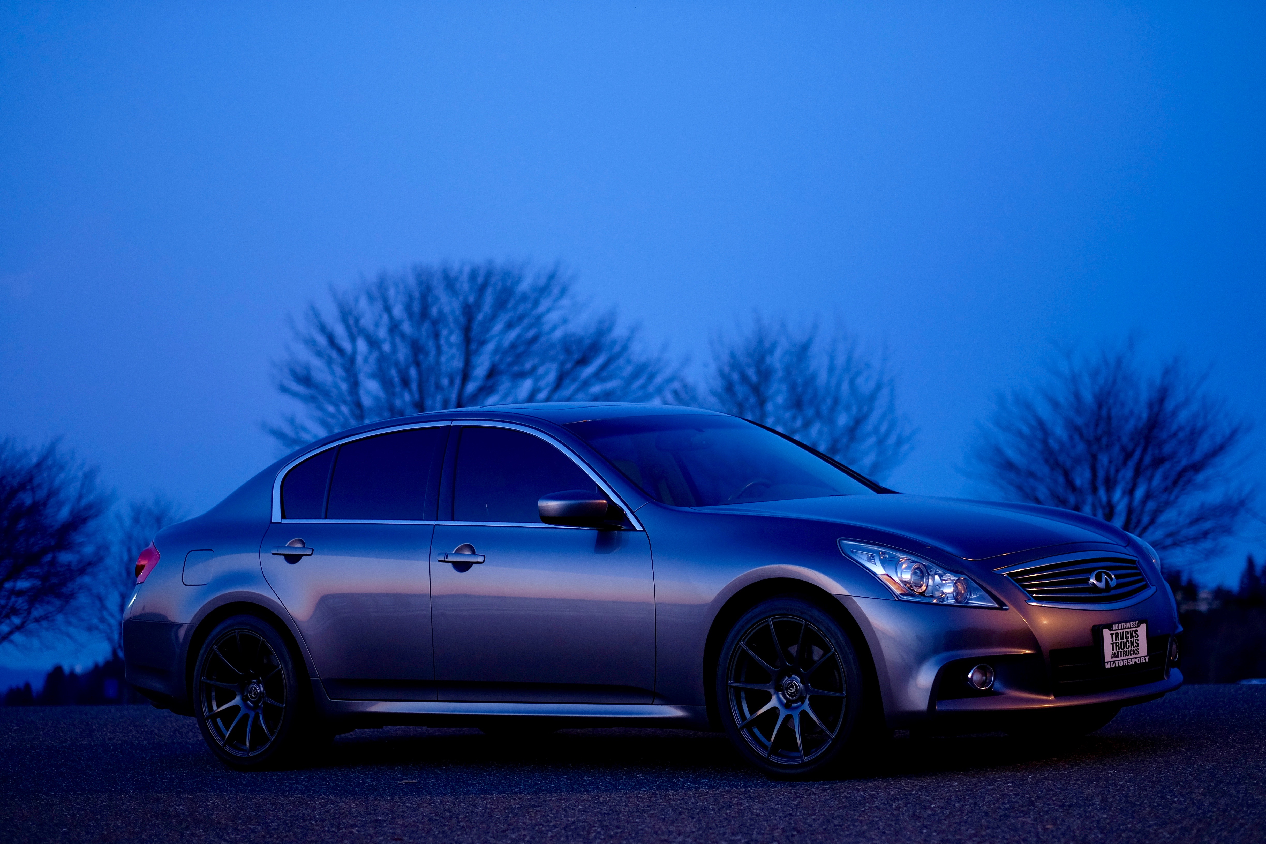

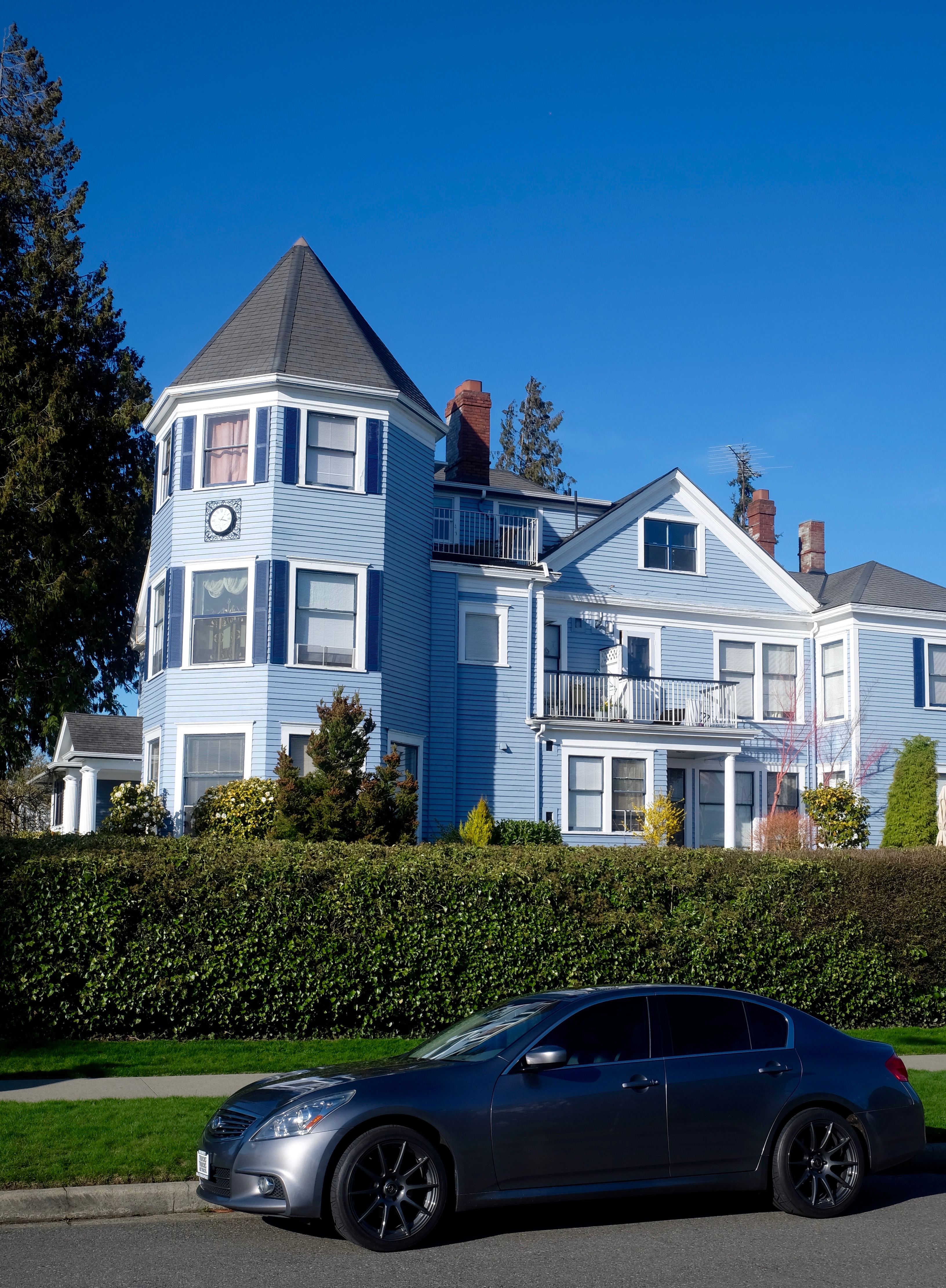

If you look through my instagram, @gavingwiebe I have a lot of photos posted on there from last summer. I was running about 2 inches lower for summer then an inch lower for winter. The picture I posted previously was before the coils settled.
I was running BC BR coils, which had quite a stiff ride. However, I've heard its a nice and day difference with the swift spring upgrade they offer which makes it feel nearly like stock stiffness, with the benefit of being low. I personally don't have experience with springs. However, I would say that anything over an inch will most likely need camber and toe arms to be brought back to OEM spec for the alignment, so keep that in mind for total cost. If all your doing is wanting an inch drop, you may be able to get away with just changing the springs, but keep and eye on the shocks and struts as there is some additional pressure being put on them.
My summer setup was 20x9+32 w/245/35/20 and 20x10.5+45 w/285/30/20 and winter 19x9+25 w/245/40/19, if you end up being curious after looking through the photos.
And given that your rear poke is minimal, I suspect it will pull that top-of-tire into the fender close to perfect.
