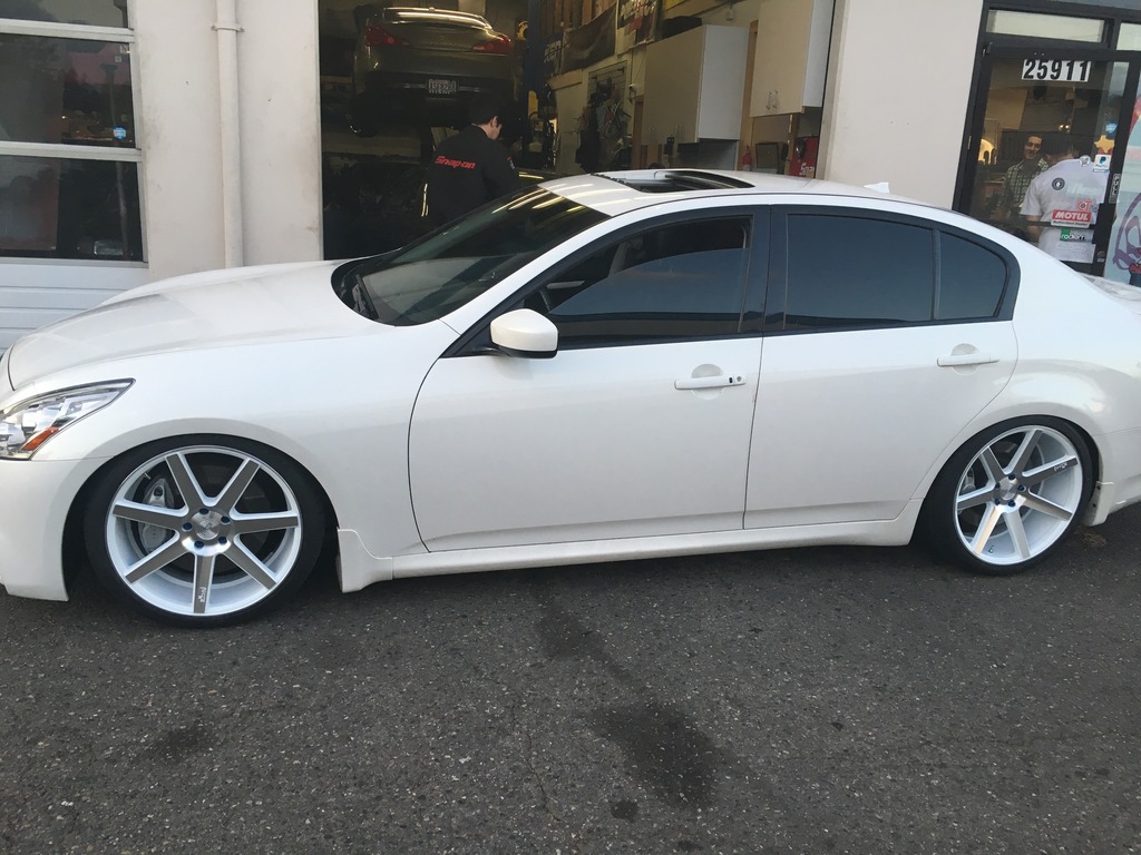

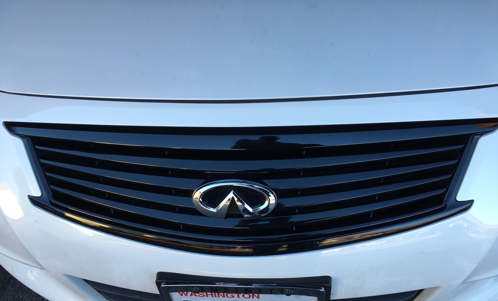

First step was tint and wrapping The window trim and grill.

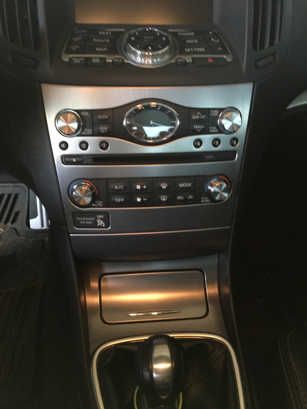

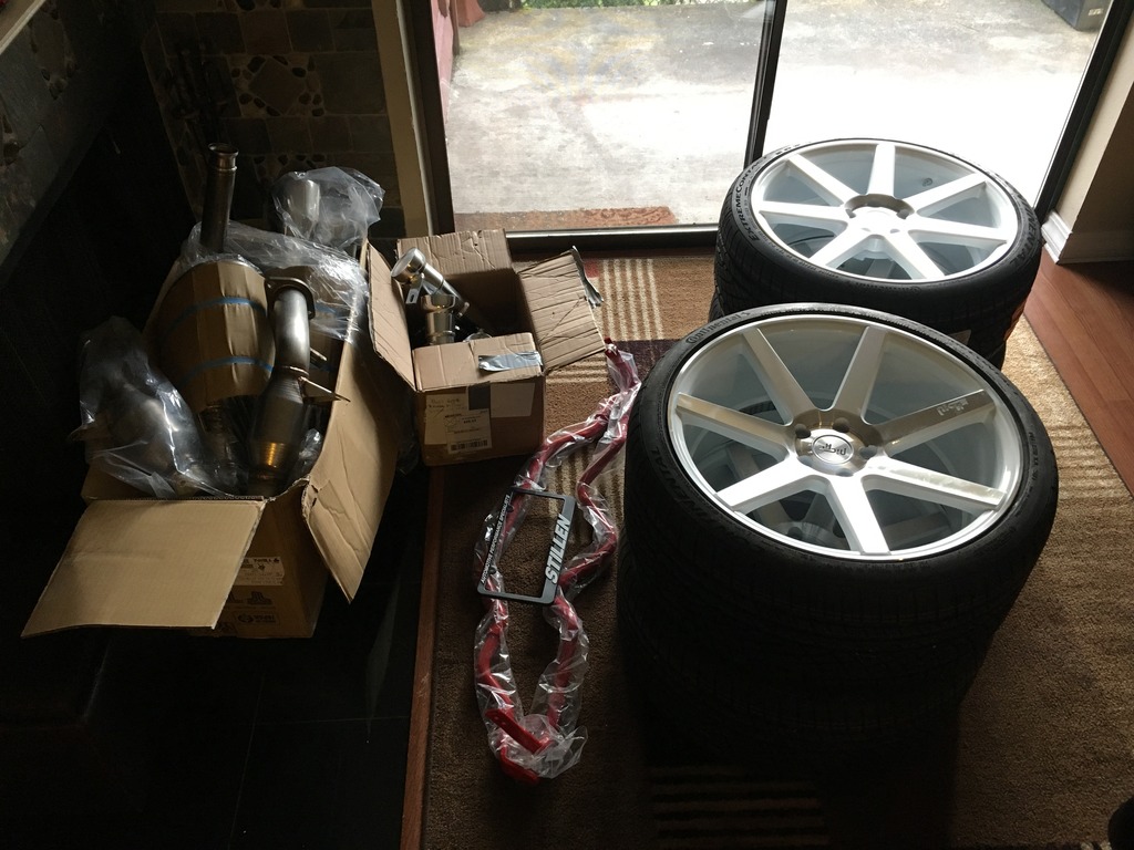

Then started reading everything I could here and learned a ton so began shopping with Kyle at importpartspro.com who is amazing. Slowly over the next 6 weeks parts arrived and stacked up.

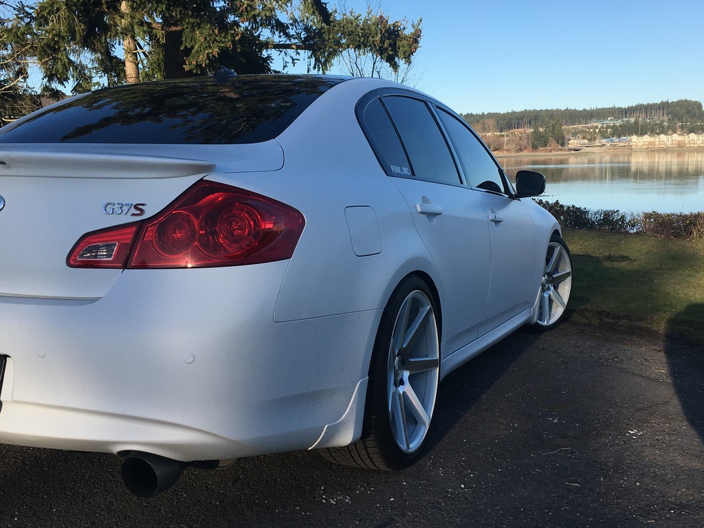

Next thing I did was jump on kennys group buy for carsmo *****. Probably the best $45 I've spent. Looks amazing and feels great.

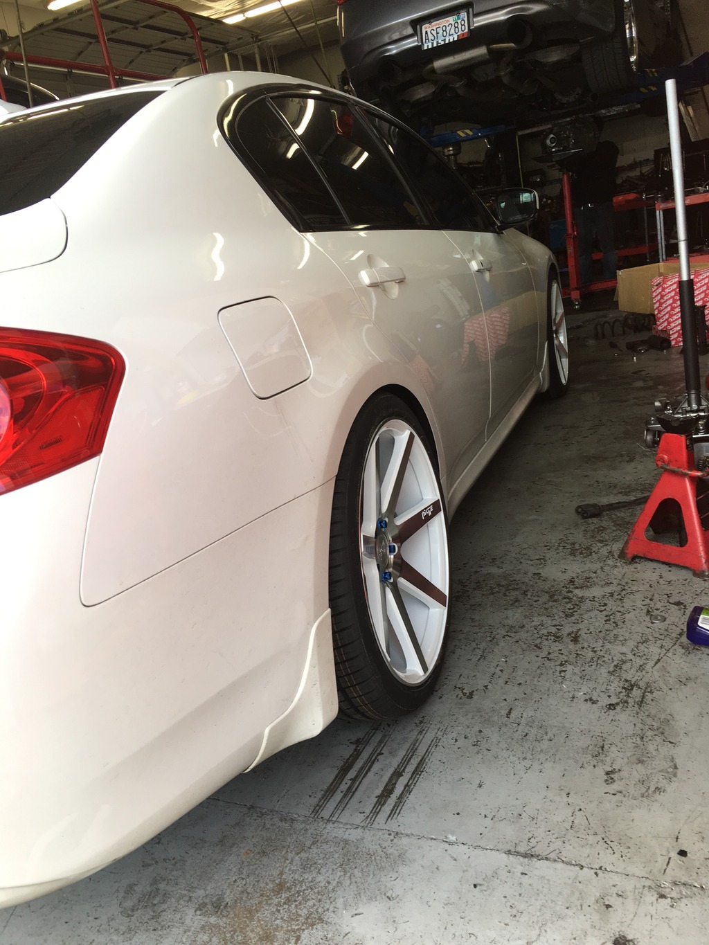

Yesterday I got a few pieces added that I've been sitting on.
Parts installed were:
Stillen f/r sway bars.
Tein Basis Coilovers
20x9 M151 Niche Verona wrapped in 245/35/20 DWS upfront and 20x10 wrapped in 285/30/20 rear.
SPC Camber kit with toe bolts and lockout washers.
Muteki Blue anodized lug nuts

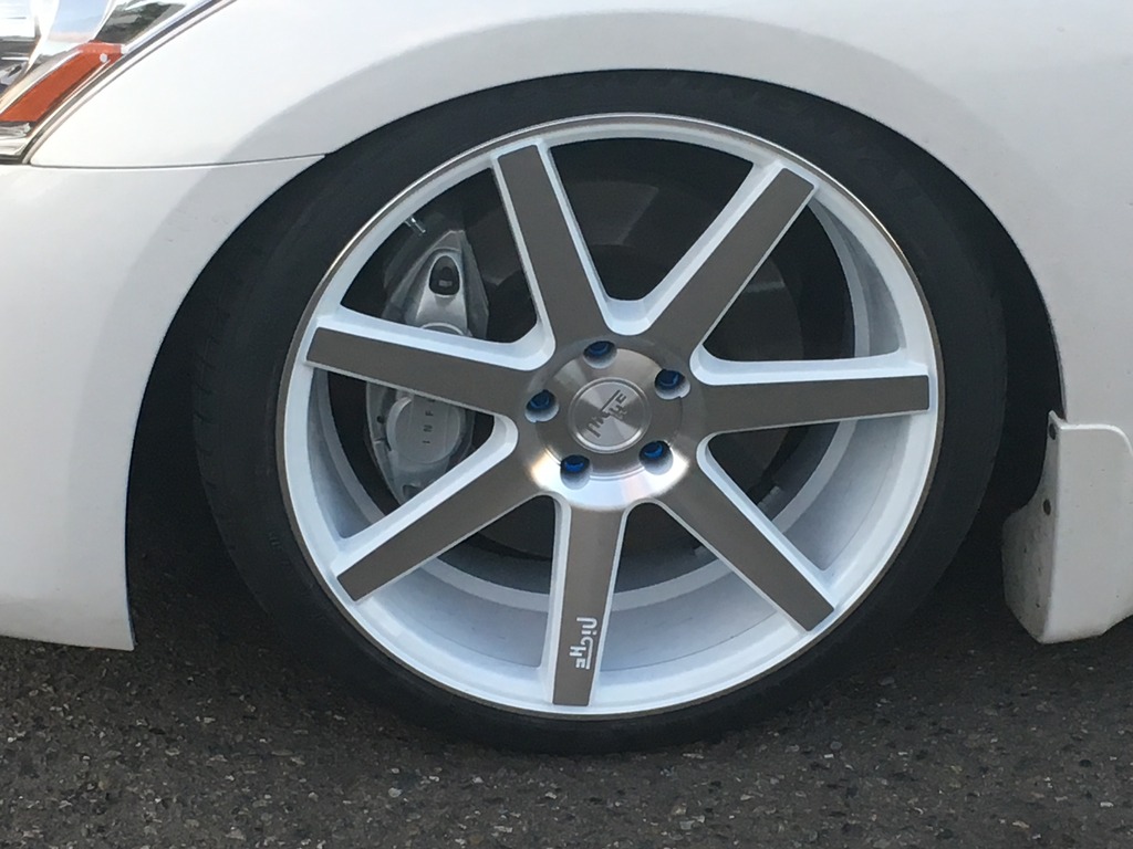

Springs settled over an inch from install / test drive til the time I got home about 65 miles away. Was sitting at 25.25 inches floor to fender when I asked for 26.25 - 26.5 range. Looked good but not Driveable.
What it was set at before driving:
What it settled to by the next morning:

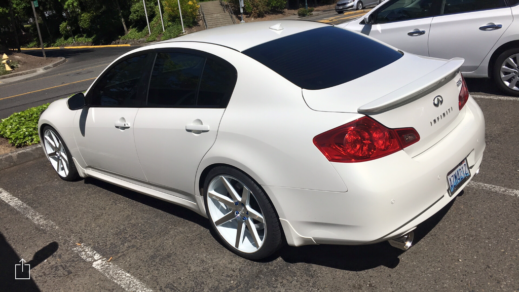

Clearly wasn't gonna work so I took it back and had it raised a bit and realigned. Also got the tanabe axle back installed too. Currently rides at 26.25 front and 26.5 rear with 1.8 deg of camber on all 4 corners. I am loving the raked look front to back.
Current look:

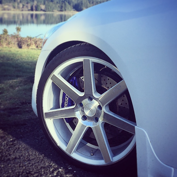

Irack, have you thought about painting those calipers, that wheel style is perfect for showing those Akebonos in full view. This would look pretty awesome IMO
