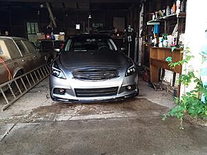

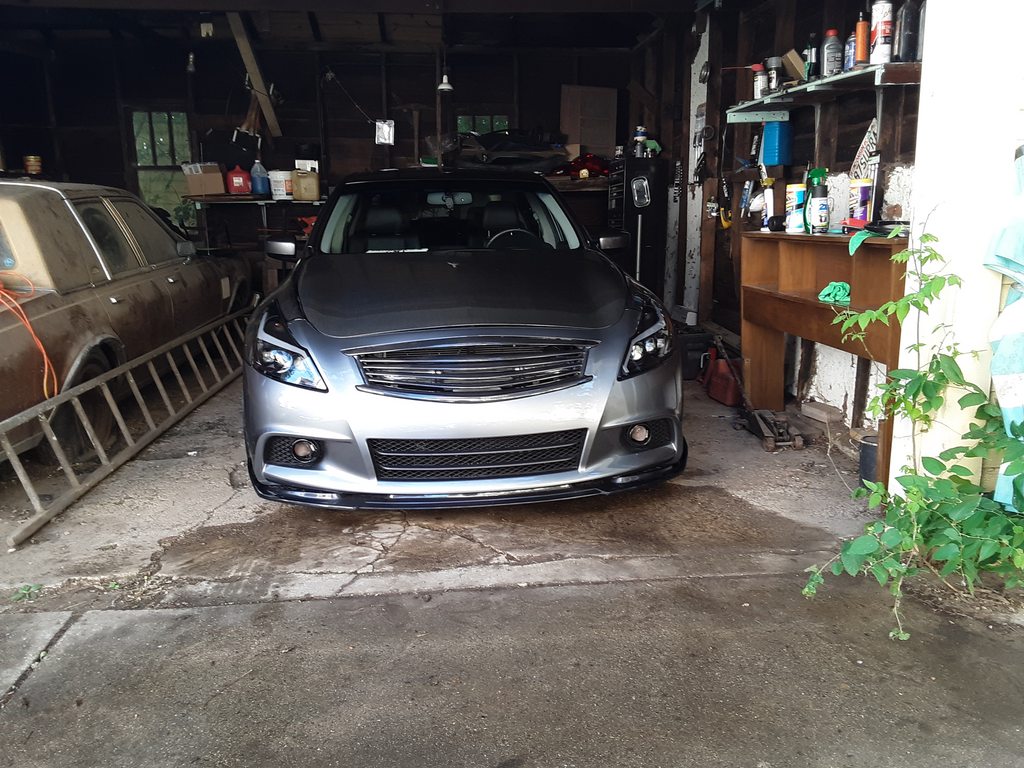

Doesn't Rochester have a pic of the naked underside of a G hood? IIRC there were more areas for venting than on the smaller 370 hood.
here we go:
Old Oct 17, 2019 | 11:42 AM
  #1199
Posts: 19,859
Likes: 5,149
Just what he was hoping for... a pic of my car in his thread. LOL
Good find, though. So there are 10 areas where it looks like there's nothing but outer skin. (2) and (4) are really tiny, so those are out. But the other sections are worth thinking about. Imaging a 1x12" vent running down sections (9) and (10) each, which would look like an inverted V on the topside: / \
Old Oct 17, 2019 | 12:07 PM
  #1200
rotarymike's Avatar
rotarymike
Moderator in Moderation
Joined: Feb 2017
Posts: 2,952
Likes: 598
From: Charleston
You know, I first found that pic (and still search for it) by putting "G37 Sedan Hood Blanket" in google. Took me a while to connect the website to your username.
From the pic and looking at my own car, the areas of the inner skin that are flat and parallel to the hood skin are not really structural. If those were Z-edged and bonded to the hood skin you would get quite a bit more room. Remember a very real function of the hood on a luxury car is to damp out engine and wind noise, hence the extra mass. I would thing triangular or trapezoidal vents in areas 2,3 and 4 would help cooling, and 6/9 or 8/10 areas too for pulling heat off the headers. Then stick GTR naca ducts in 1 and 5 to feed the intakes if you have short rams or just want more snoutiness.
