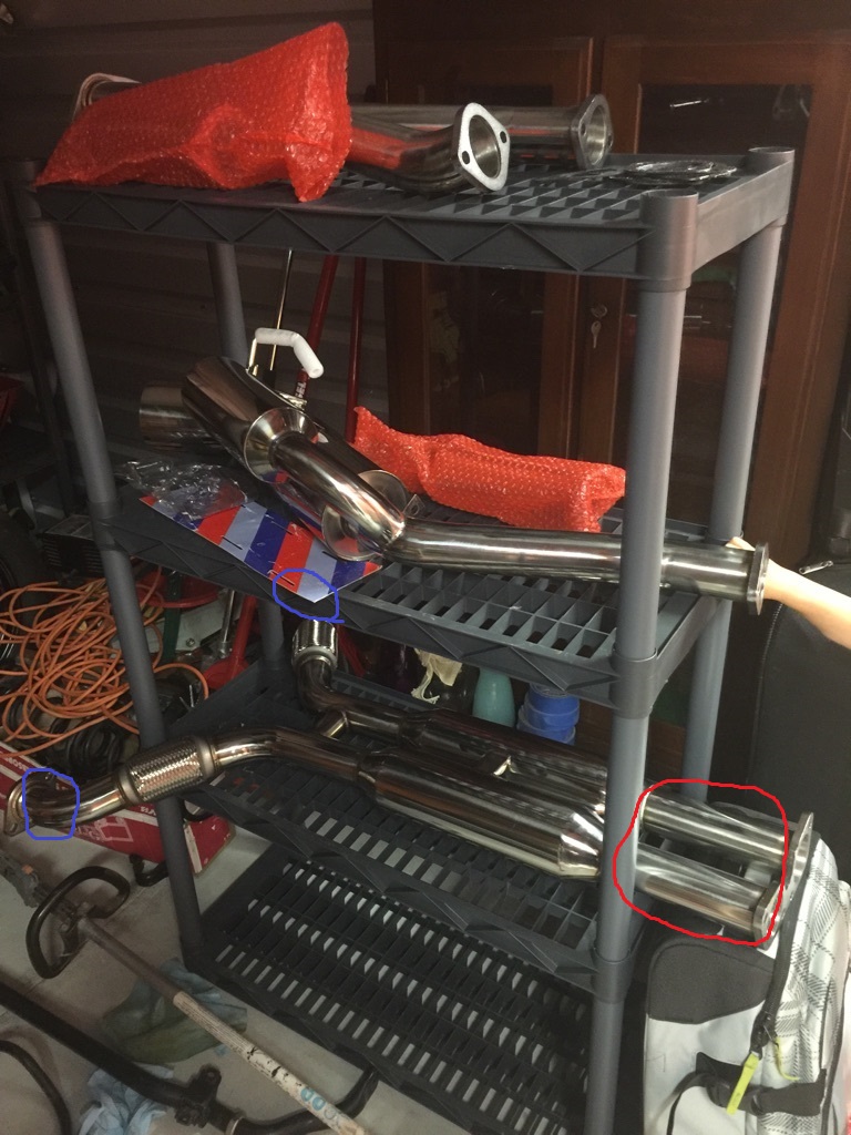

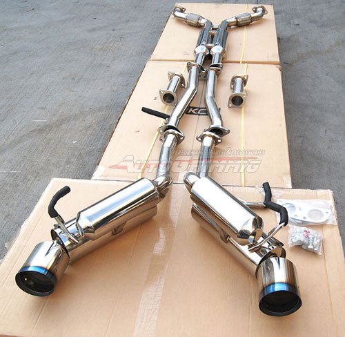

The fun part is going to be everything behind that. As of now it just seems that the rest of the exhaust will be used for parts as none of it is really anywhere close. The helmholz mufflers will need flipped around to the other side of the mufflers completely, similar to the Ark.
All I need is this:
Turned into this :

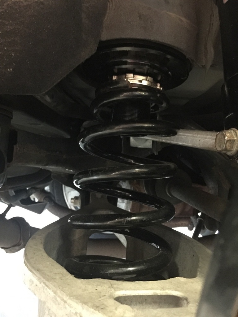

Got started on the BC coilover install last night. The rears are on and the height is adjusted. I still need to go back and set the actual shock preload. I do have the right rear clunk, but I think the shock preload will help with that:

Old Jul 19, 2016 | 04:12 PM
  #66
Looking good JF, I think they do have 2 different paddle colors, that's too bad that you had a sour transaction there
G/L w/ the BCs, that set preload should quiet them down hopefully.

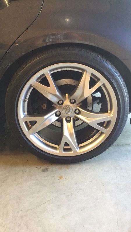

Ever since I sold my 370z sport wheels I always missed them. A set popped up locally for a really good price so I scooped them up a few weeks ago, had the TPMS from my old 19's swapped over and swapped over the center caps. The 370z 19's are about 4lbs lighter than my M45 19's and it made a considerable difference in performance.
19x9 Front: Rim 23.2lbs With tire/stock 52.2lbs
19x10 Rear: Rim 23.9lbs with tire/stock 56.8lbs

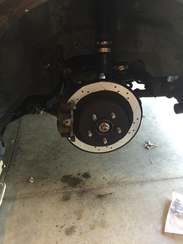

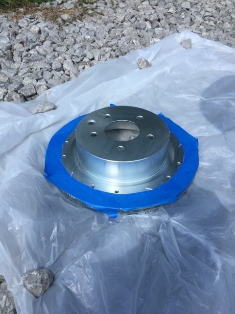

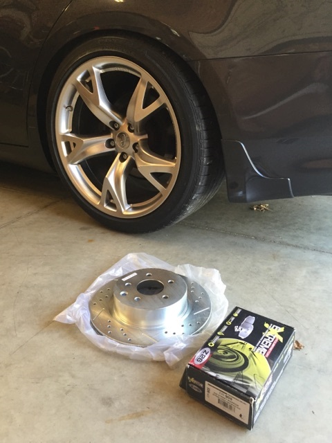

I also picked up a Powerstop K114-26 brake kit locally for a smoking deal. I really wanted Akebono's and I may get those eventually, but for the price I paid for these I couldn't pass them up. My car has 109k miles and I have no idea when the last time they were changed. I bought the car with 93k miles. The pads had plenty of meat, but the brakes pulsated pretty badly. I was only able to get to the rears. Fronts will happen this coming weekend:

Hopefully you'll get that rear noise ironed out, G/L, and nice job on painting those new rotors, that's what I do now too, makes them look SO much better for much longer.

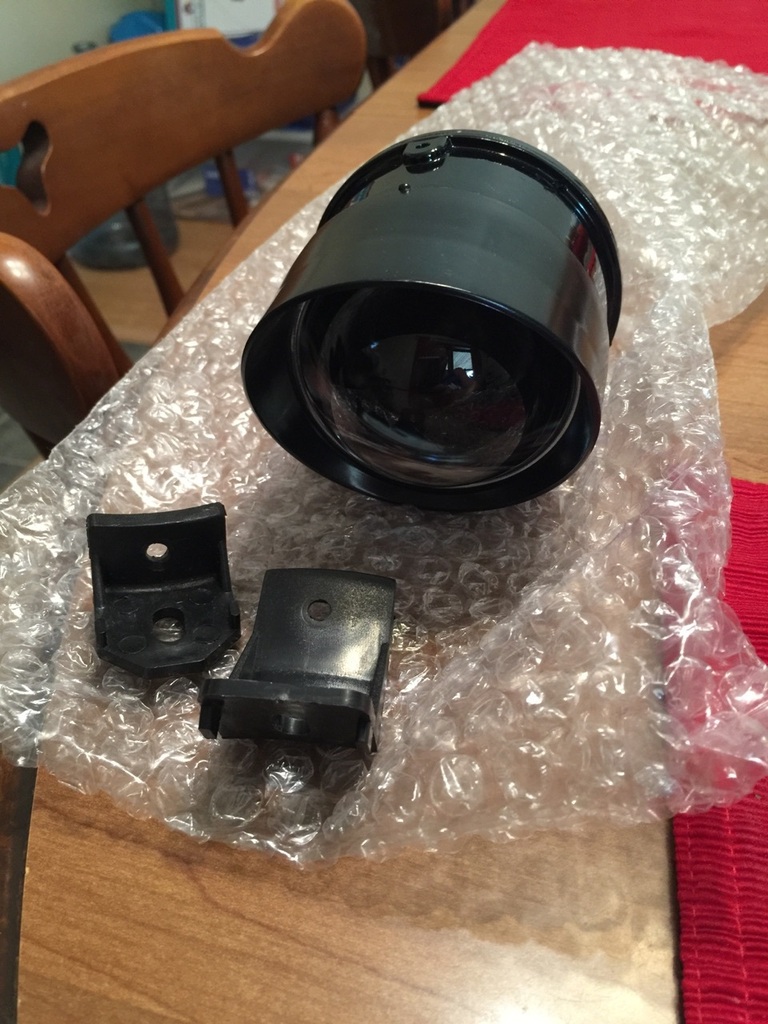

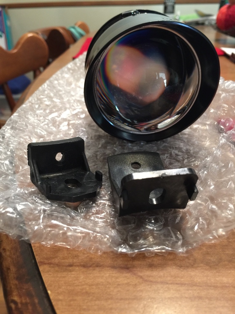

The fog lights have arrived. So far I'm pretty impressed with these. They seem very solid. Now I just need some time to pull the front bumper and install these as well as the lower grille insert:

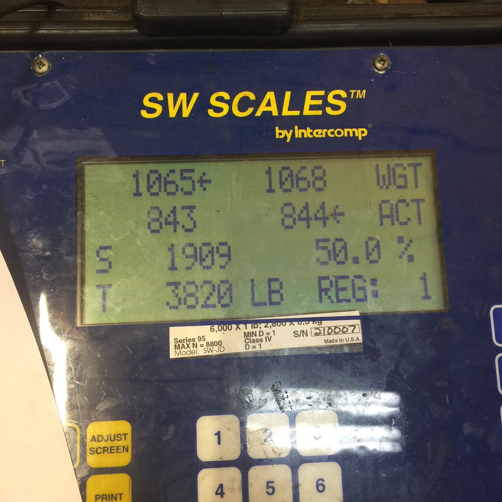

Had the car corner balanced and aligned earlier this week at a well known performance alignment shop. They do a lot of road racing stuff and high dollar cars.
What a difference over a chain tire store...
These guys blew my socks off with knowledge. I'm glad I waited / worked in the lobby while they worked on the car as anytime they had a question or ran into an issue they came out and got me and showed me exactly what they were referring to.
Good news and bad...
Bad news first. The ride height had to come up by probably .5-.75". The car isn't anywhere near as low as I like it, but after seeing the lack of travel in the Z1 front upper control arms it just wasn't safe. The good news is that the car is now almost perfectly balanced and drives as smooth as it did when it was all stock. It looks slightly higher in the front, but the car is truly level. The ride is harsher with the BC coils and sways, but no more pulling to the left, unpredictable braking, slightly offset steering wheel and a rock solid feel. The car really is fun to drive again. I do still have the clunking in the rear so a new set of V2 shocks from BC will be ordered and I'll use the OEM top hats.

Awesome work! I just went down the same road as you with corner balancing her; loved the difference. One question: when you were weighed how much gas was in the tank and is that with you in the car? Just wondering because your like about 250 less then mine, which makes me jealous. Granted I know I've added a fair amount of sound deadening but nowhere near that much.
