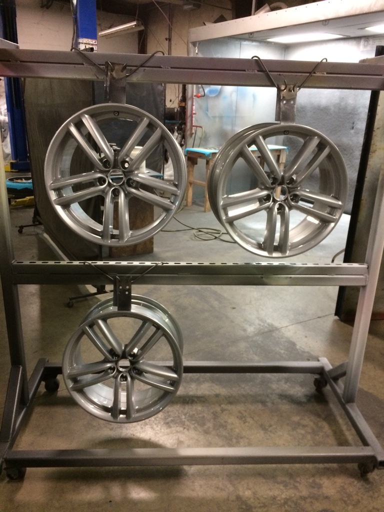

If I didn't have bad luck I wouldn't have any luck at all
While trying to repair the bent M45 wheel it started cracking and bending in other places. It wasn't safe to keep trying to fix the wheel so I ended up having to order another wheel. But the other 3 are looking good!
I'm in search of a set of OEM lug nuts as I let mine go with my stock wheels when I traded them off.
I also am going to need a good size spacers for these wheels. They're 19x8.5 with a +50 breadtruck offset. I'm thinking I'll probably need something like 30mm wheel spacers.
Also, if anyone knows of a Stillen G3 intake or exhaust for the car I'm a buyer!
