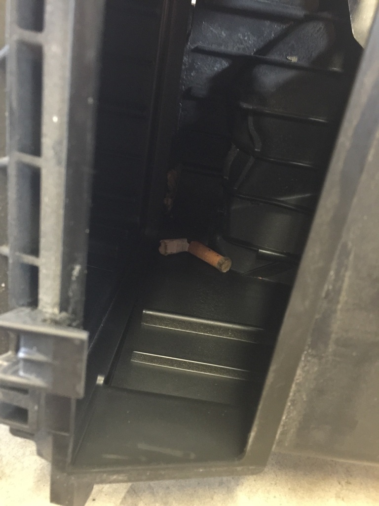

Here was a little surprise I found in one of the stock airboxes:

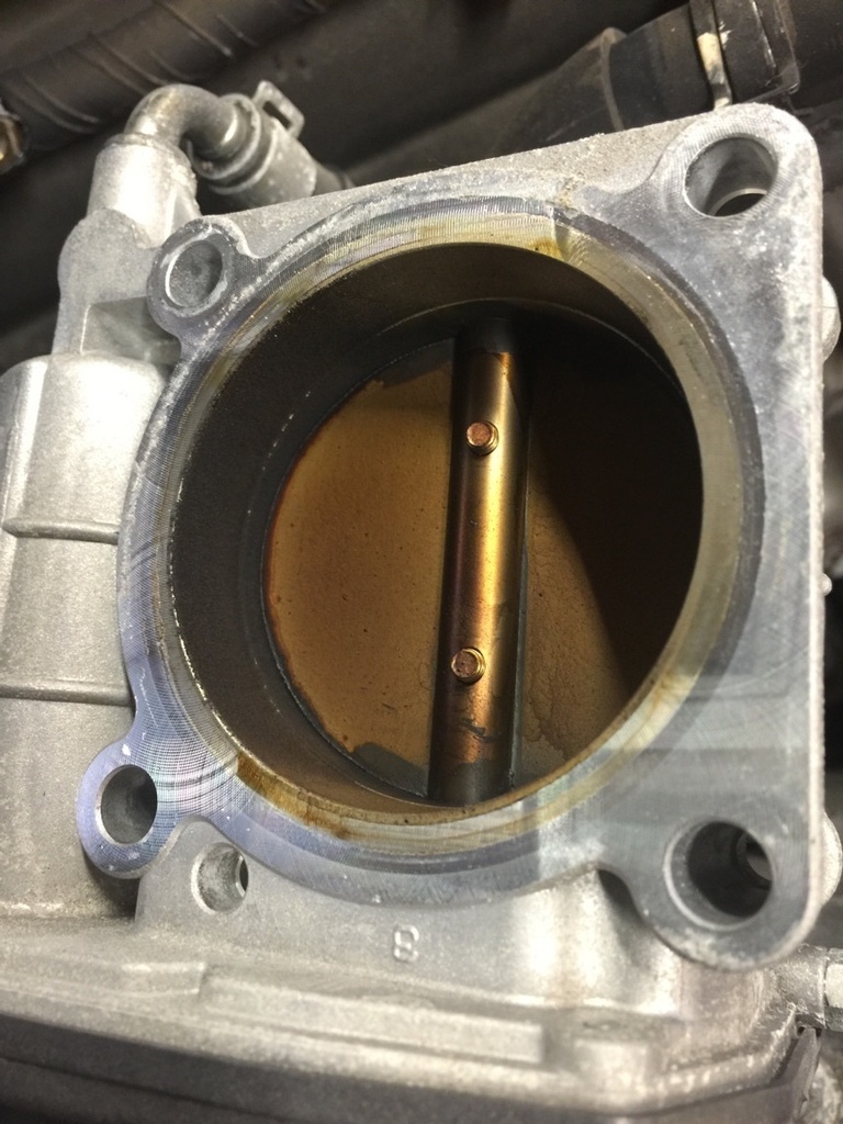

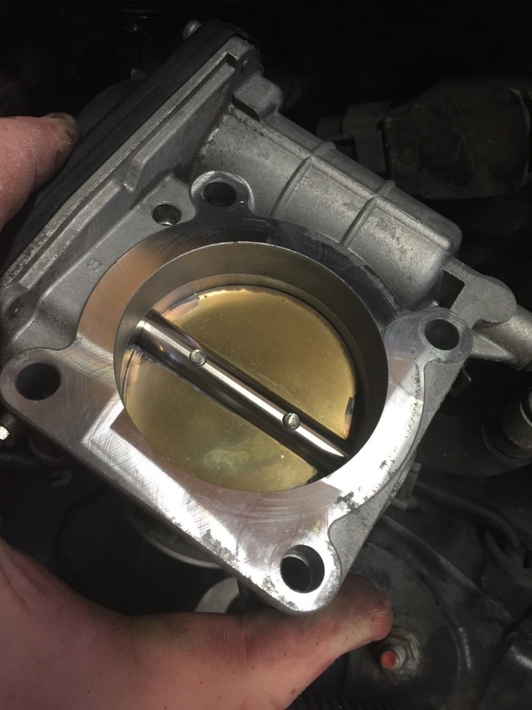

I also decided to clean the TB's while I had all the intake piping off. I did disconnect the battery as I was installing the intake. I also did manually open up the TB butterflies to clean them. I know both of those are debated in the TB cleaning thread, but I had zero issues after completion. Before and after:

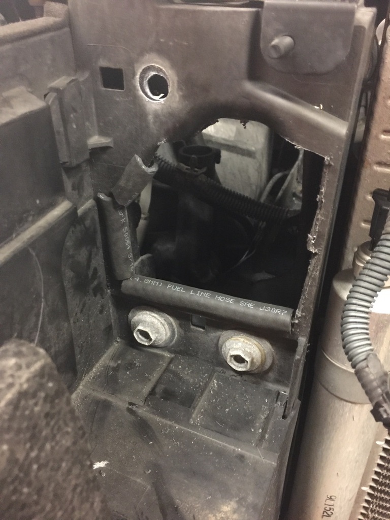

I used on osculating saw to open up the core support and used some vacuum line that a slit open to line the jagged edges as to not rubbing the piping more than it already is:

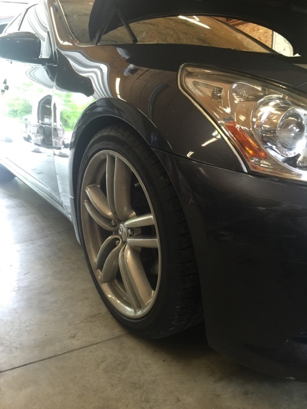

The M45 Sport 19" wheels are now on the car after being completely stripped and refinished. I really like them on the Blue Slate. Even better is I picked up some OEM TPMS sensors off of ebay for $50 shipped and they work great! No more TPMS light!
I have a couple sets of slip on H&R spacers in 10,15 and 20mm. I was debating on just picking up some DRM spacers, but after thinking about it I'd rather just get some extended wheel studs and use what I already have. It needs it....

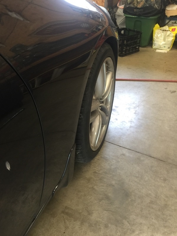

I was going to run my H&R DRS wheel spacers as they're excellent quality spacers, but as much as I change wheels I really didn't want to have to keep changing wheel studs. I picked up some DRM spacers and got them installed this weekend.
The spacers are dang near exactly where I want them give or a take a millimeter or two.

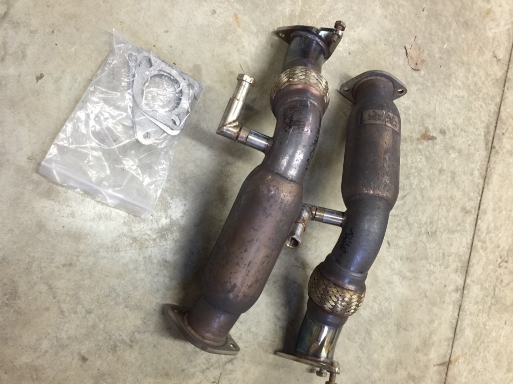

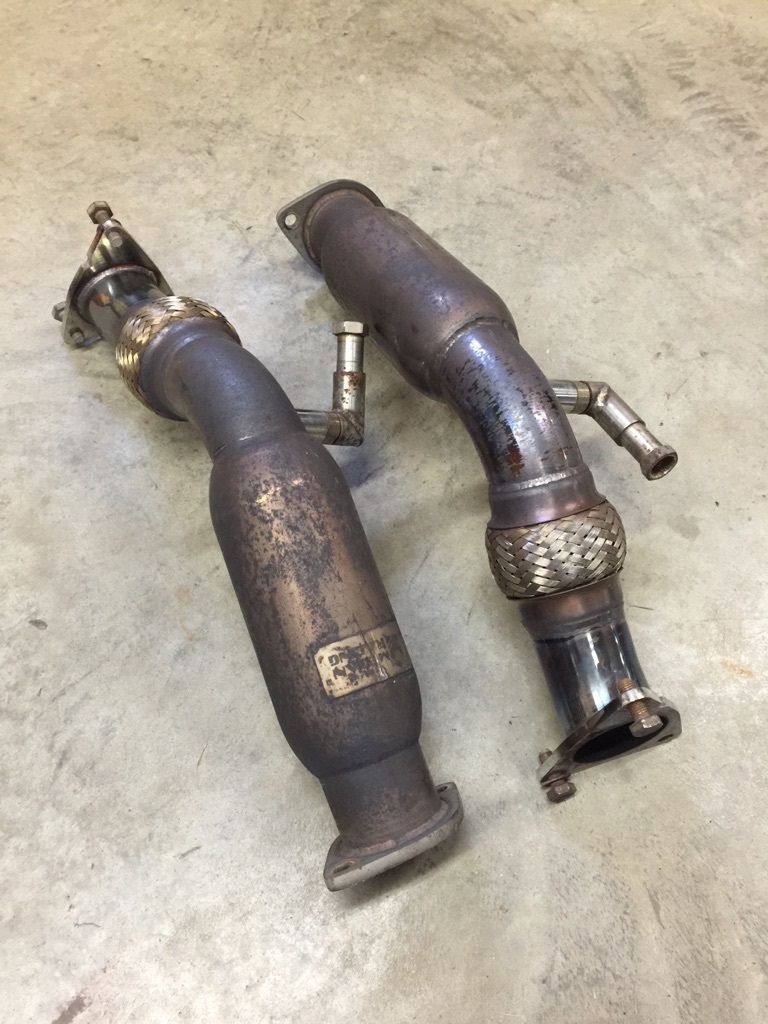

I swapped over to the OBX test pipes from the Megan test pipes this weekend in hopes of eliminating the CEL. No dice... I even bought these stainless O2 spacers with TINY holes so there should be hardly any exhaust flowing back to the O2's. I think I may actually have a damaged O2 sensor or other issue. The car runs great though so it's nothing that affects how the car runs.
http://www.ebay.com/itm/170909875264?_trksid=p2057872.m2749.l2649&ssPageName=STRK%3AMEBIDX%3AIT
Sucks because I had Megan test pipes on the car and I feel they are a slightly better quality design with the flex pipe. The flanges on the OBX pipes are thicker, however.
I will say that the gaskets that came with the Megan test pipes are pure junk. Both had completely failed at the header connection. The graphite gaskets that came with the OBX pipes seem to be much better gaskets. I didn't install though because I bought the Z1 gaskets and installed them with some RTV.
The combination of the Z1 gaskets and actually aligning the exhaust with the flanges at the mid pipe has made the exhaust sound AMAZING. The rasp has been 90% eliminated and the car is much quieter. The tone is better because all of the exhaust is actually flowing out of the mufflers now. I'm in love all over again:
In hindsight I wish I would have kept the Megan test pipes and just swapped over to the Z1 gaskets and double checked the alignment of the exhaust. The guys that installed my test pipes didn't do the best job. One of the bolts at the y pipe was completely stripped and just cranked on with an impact. They also didn't take time at all to align the connection of the TP's to the Y pipe. I can't say for sure if that helped get rid of the rasp, but I'm sure it can't hurt.
Here are the Megan TP's after 5-6k miles. These will be for sale soon and I'll be including the grade 8 hardware they never came with as well as the O2 extensions I bought separately:

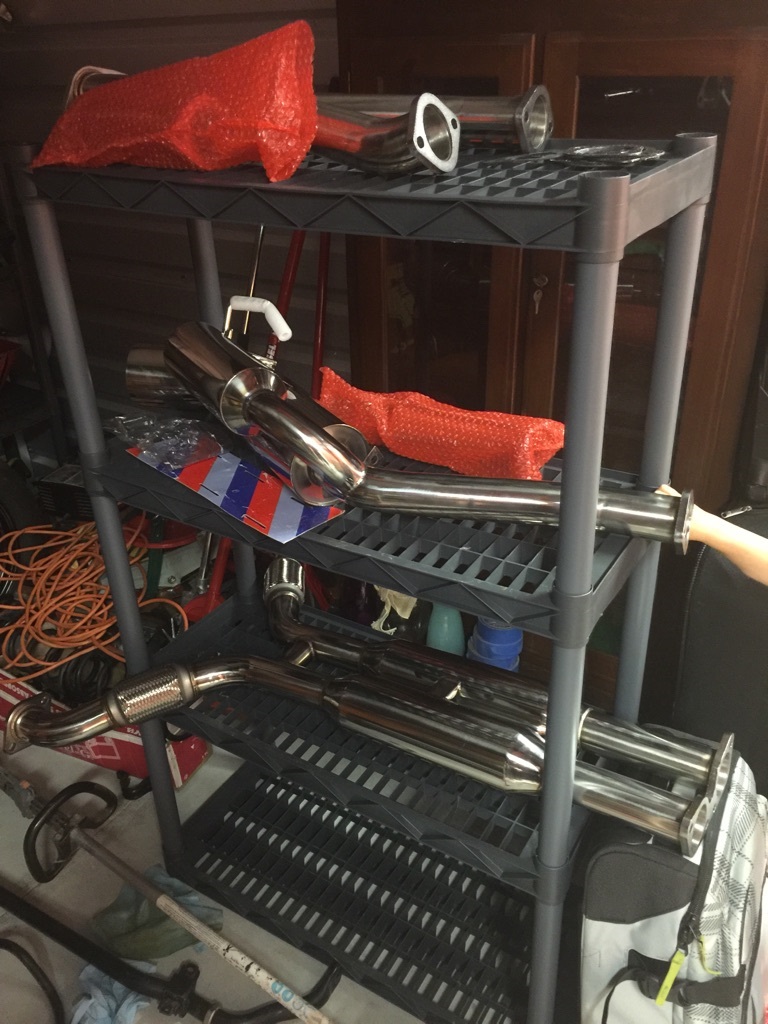

I've been debating on what exhaust I want from the cats back and without spending a fortune there just aren't many options for the AWD sedans. I started looking at 2.5" 304 stainless builders kits, mufflers and resonators and I'm in the same boat after cost of materials and having someone fab up the exhaust.
I decided to just scoop up this ebay exhaust:
http://www.ebay.com/itm/400981903721?_trksid=p2057872.m2749.l2649&ssPageName=STRK%3AMEBIDX%3AIT

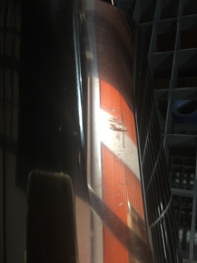

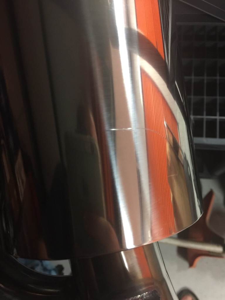

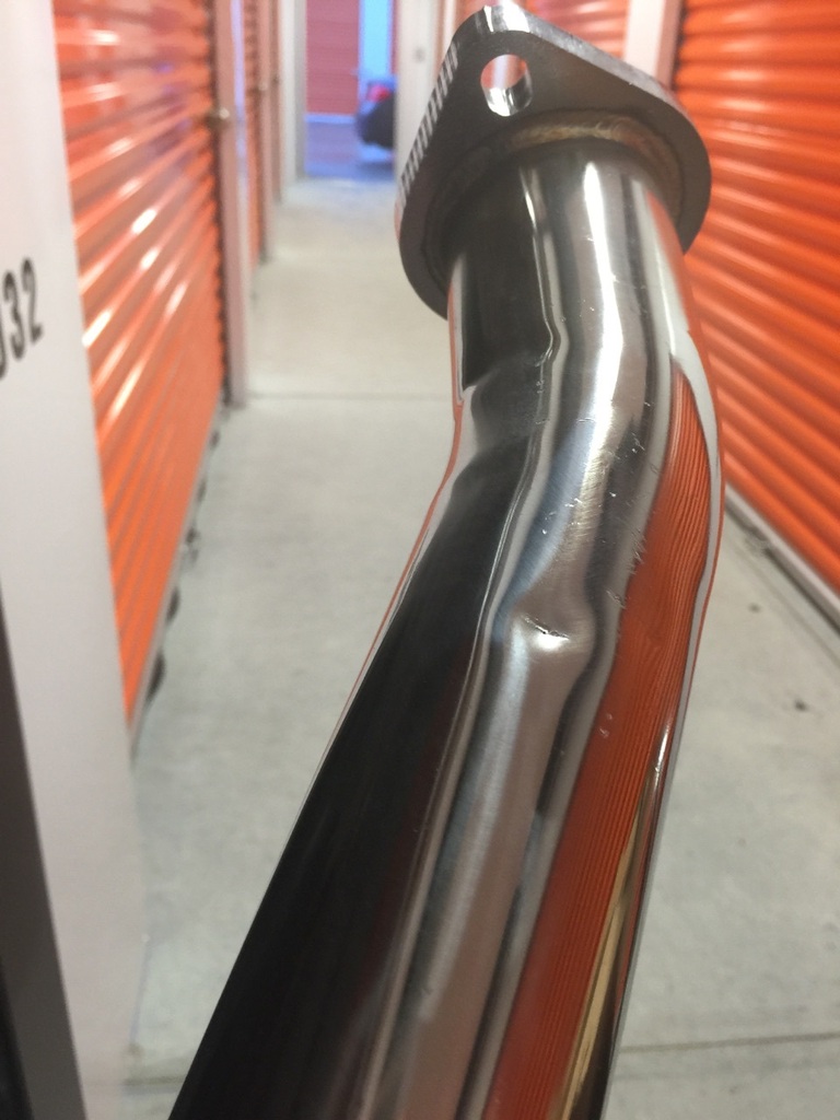

It's 304 stainless and is pretty decent quality. It's all 2.25" piping and the flanges are nice and thick. Like all ebay exhaust it was packed **** poorly and has a few scratches on one muffler as well as a dent in one section of the piping. I contacted the seller and they refunded me some money so I have just over $200 in the whole setup. I don't really care as I'll be cutting up most of it anyway. We just sold our home and are looking for a new home so I probably won't get to this for several weeks. But here are some pics of the actual exhaust as I unpacked it:
And some of the damage:
