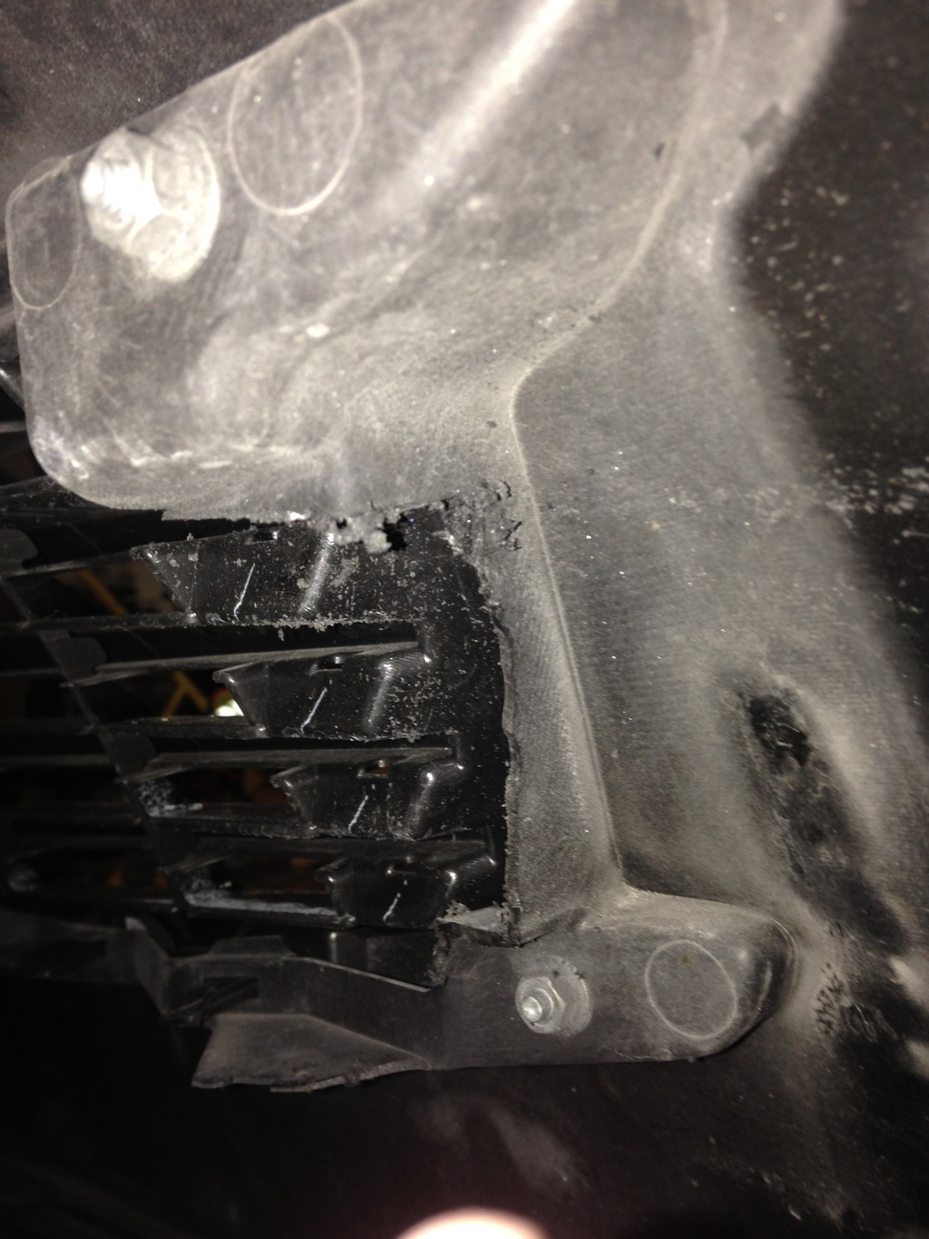

So, I installed my Takeda today and ran into some fitment issues. Everything lined up perfectly, I slotted the foam bumper channels, but then i tried to put my bumper back on and it looked like the tubing was bumping up against some plastic part behind the grill.
Here is the little plastic triangle the coupler was running into, not sure what purpose it serves. Name:  8E4351A1-E0B8-4CEE-85E9-02342B8FEC6E_zpskxbv9lhq.jpg
Here is it after I dremeled it off. Bumper went back on and fits with no issues (i do not have the steadiest of hands with a dremel. I made sure there was nothing important behind it before i started cutting. I was careful!
- On another note, it does look like Takeda changed the design a LITTLE bit. You can see the angle difference in the couplers (this is Jumpman's sedan). His are more at a 90 degree angle, and mine are at about a 65-70 degree angle. Name:  47C1EBD2-459D-4936-861F-13DB7A30CBC4_zpsih3p1vav.jpg
Definitely think this was the cause of it.
