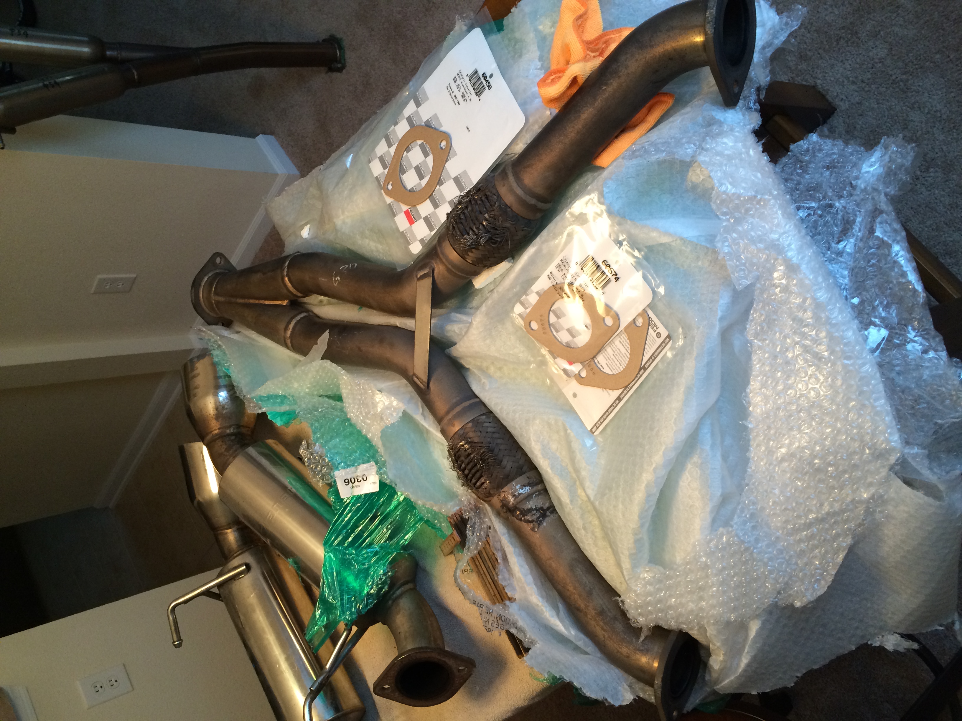

Preparing to install Tanabe catback exhaust
Im getting ready to install my Tanabe catback system this weekend and need some help.

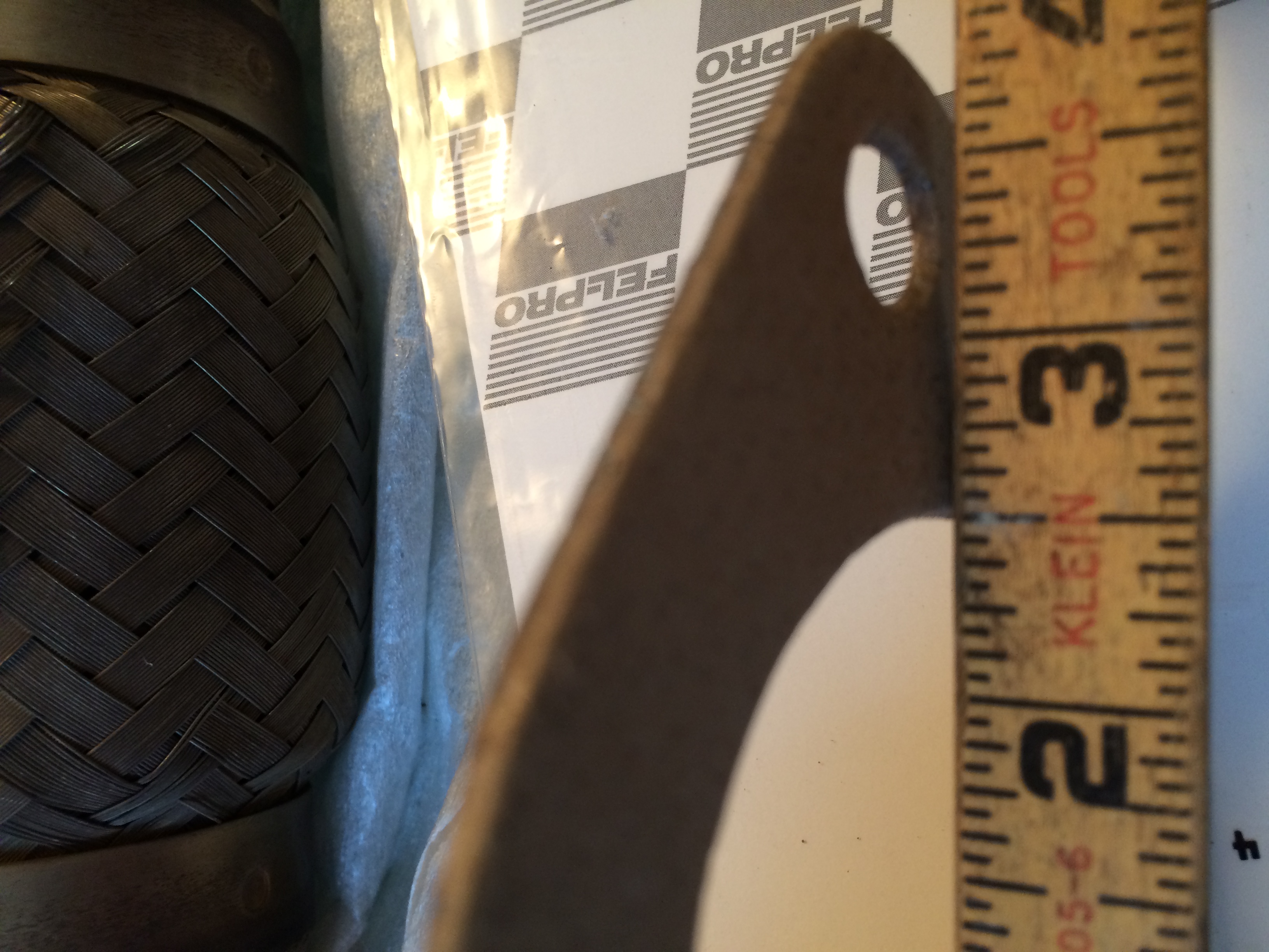

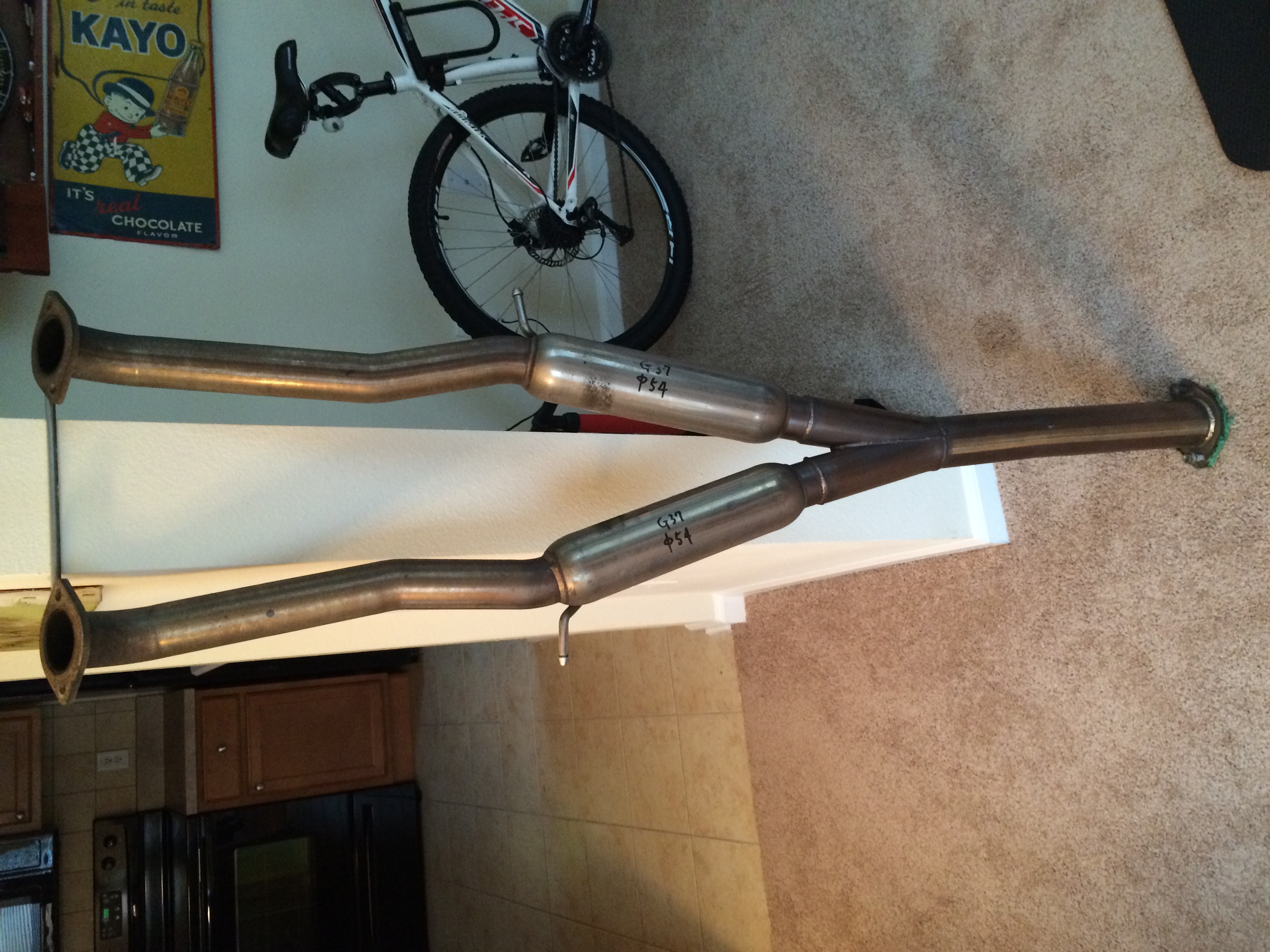

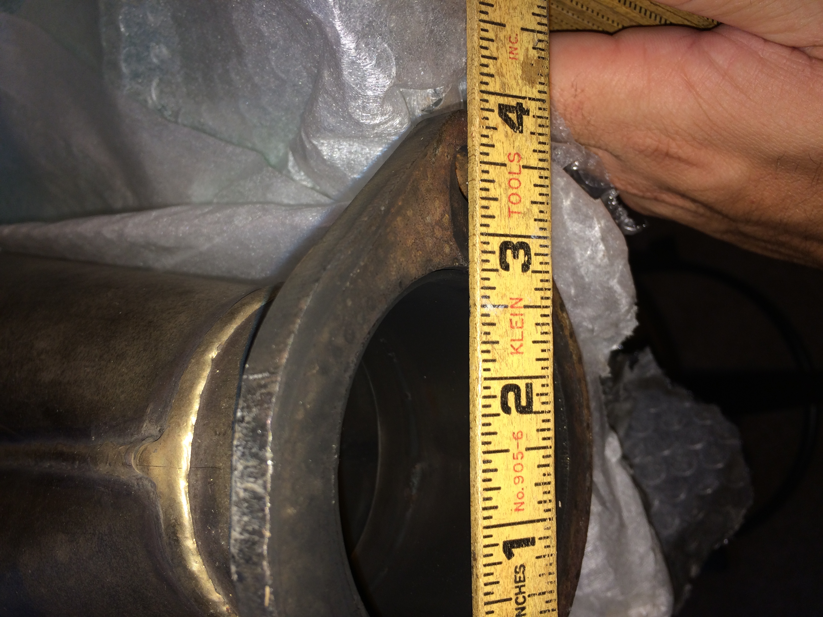

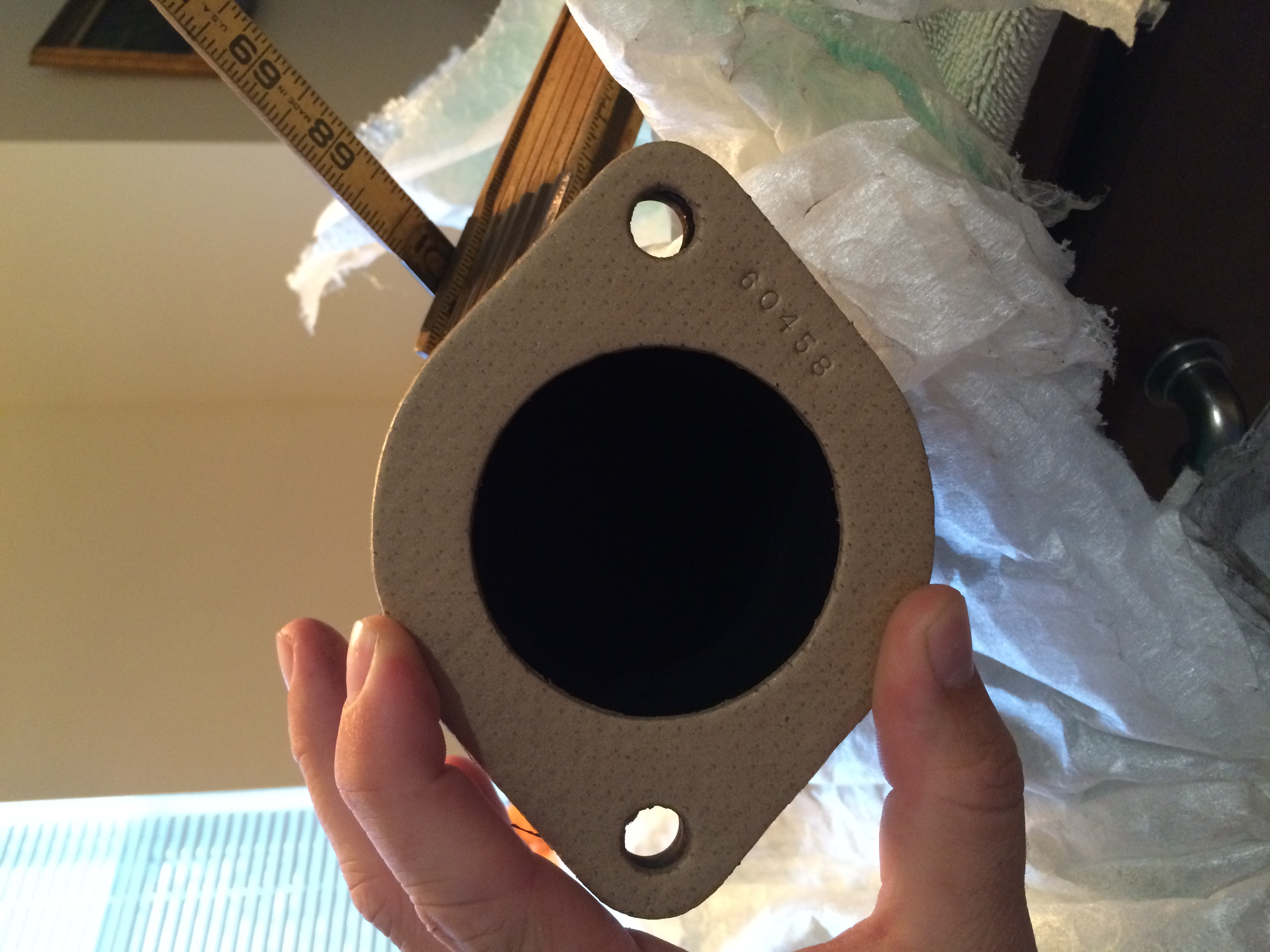

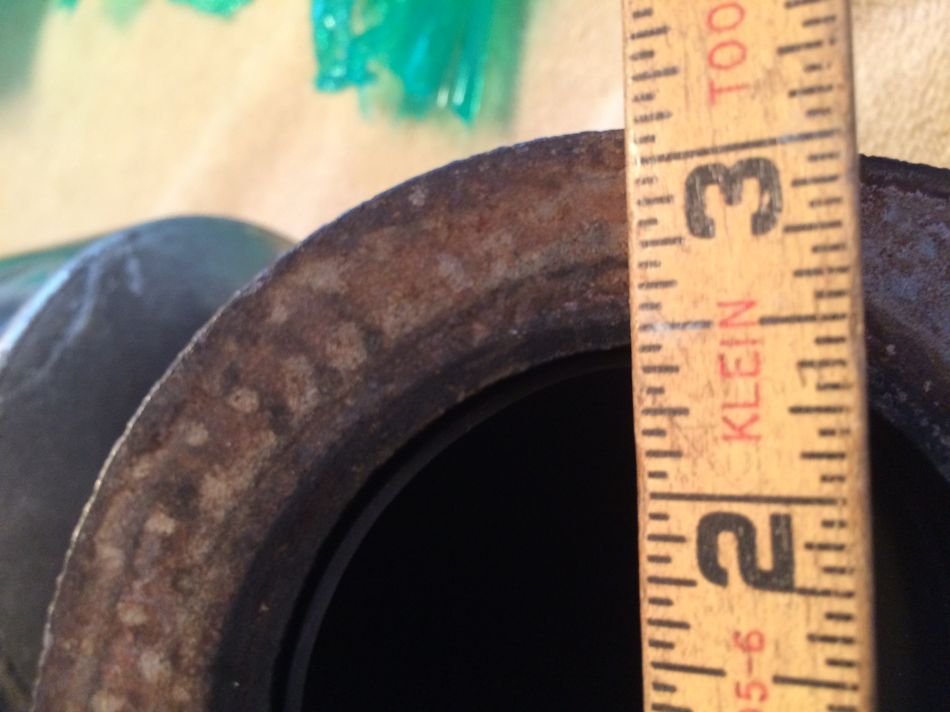

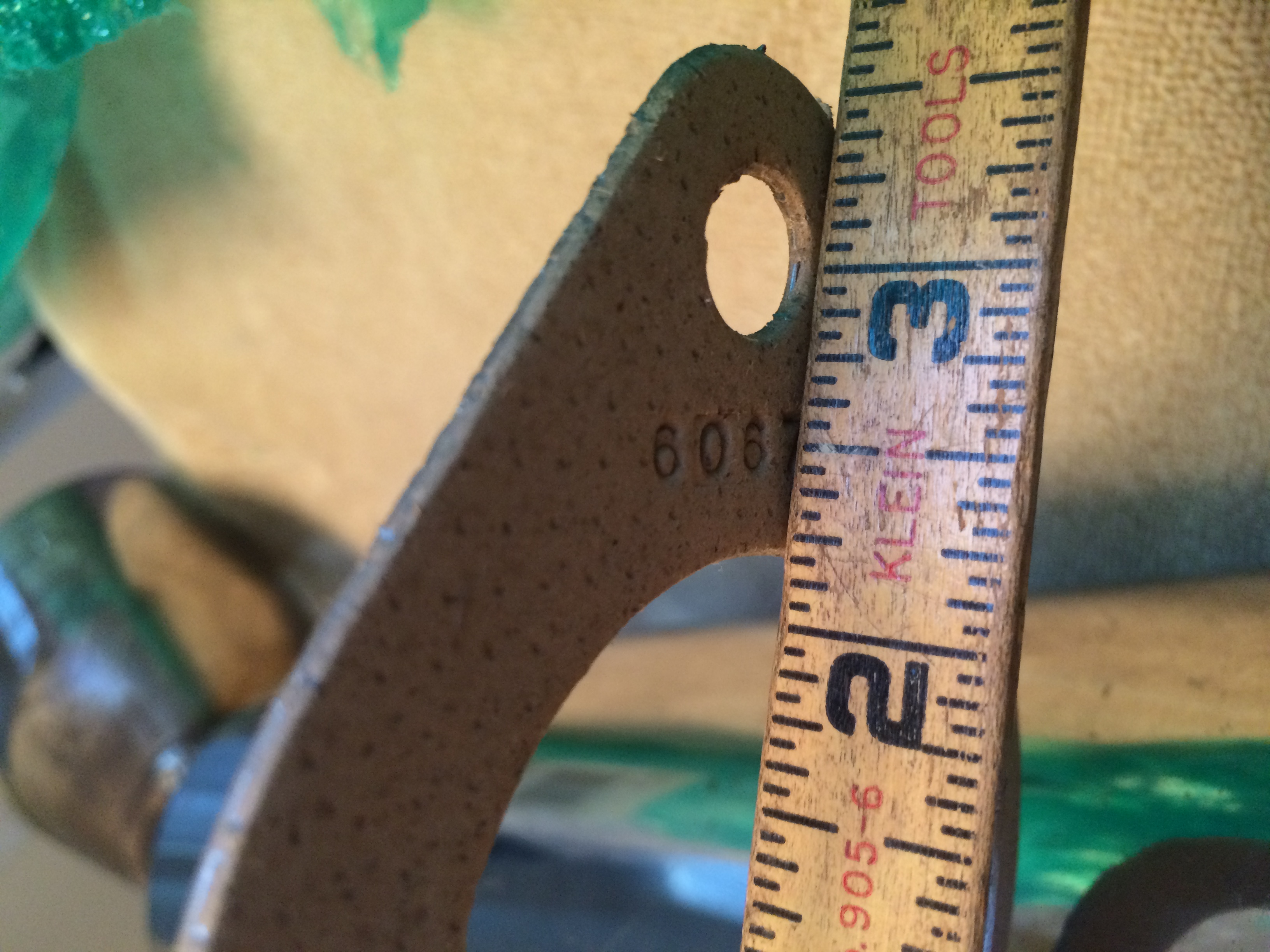

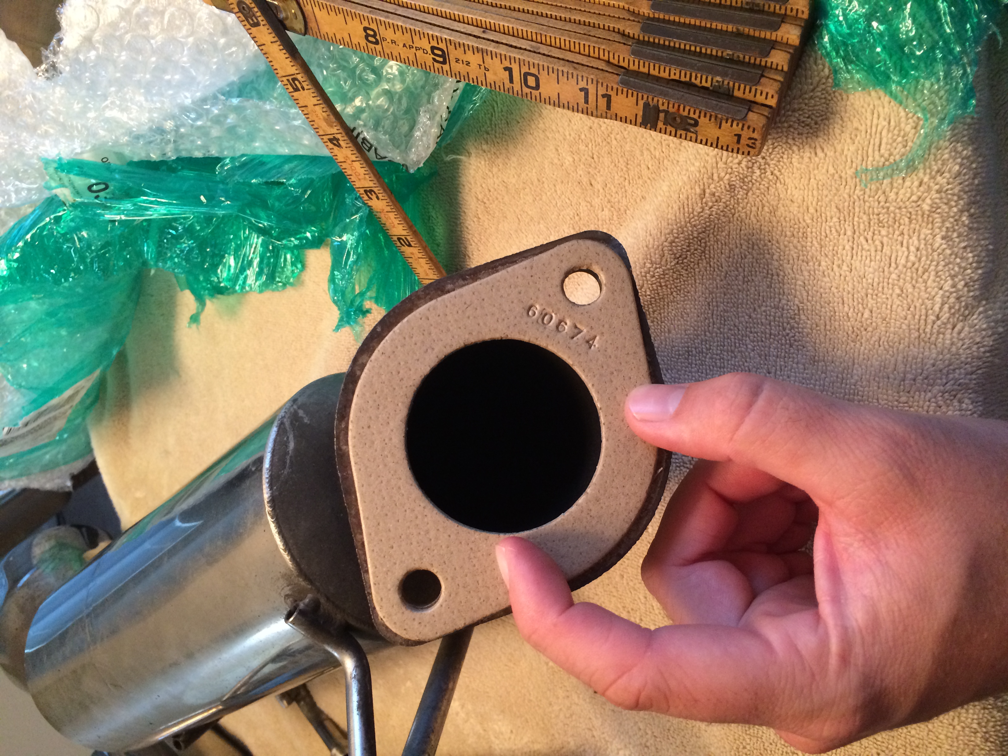

Gaskets: I bought two different type of gaskets from advanced auto parts. One type is close to the size of the Y-pipe to Mid-pipe section. The other type is close to the size of the Mid-pipe to Muffler and Cat to Y-pipe sections. However, both gasket's I.D. is 1/8-1/4" smaller than the exhaust piping (pictures below). Will this have a noticeable negative impact on the flow/HP gains?

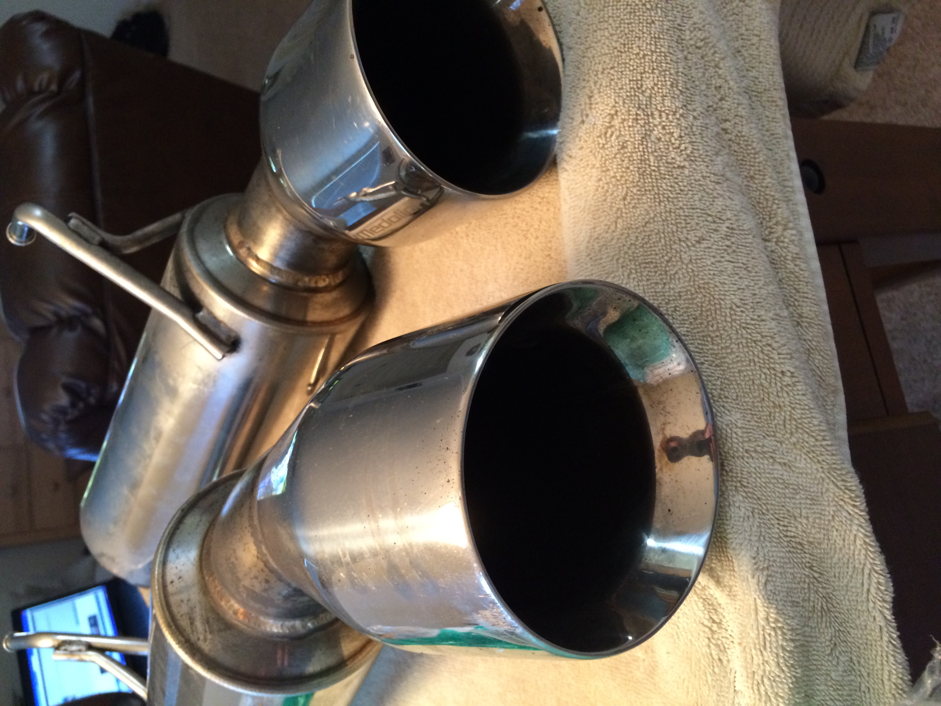

Exhaust Finish: The cans and tips I bought have some road tar/burnt rubber/grease... black crap on them, does anyone have an effective way of removing this gunk without scratching or tarnishing the stainless finish?
Installation: Any ideas or advice would be much appreciated. I know to soak the nuts and bolts in PB blaster for a looooooong time.

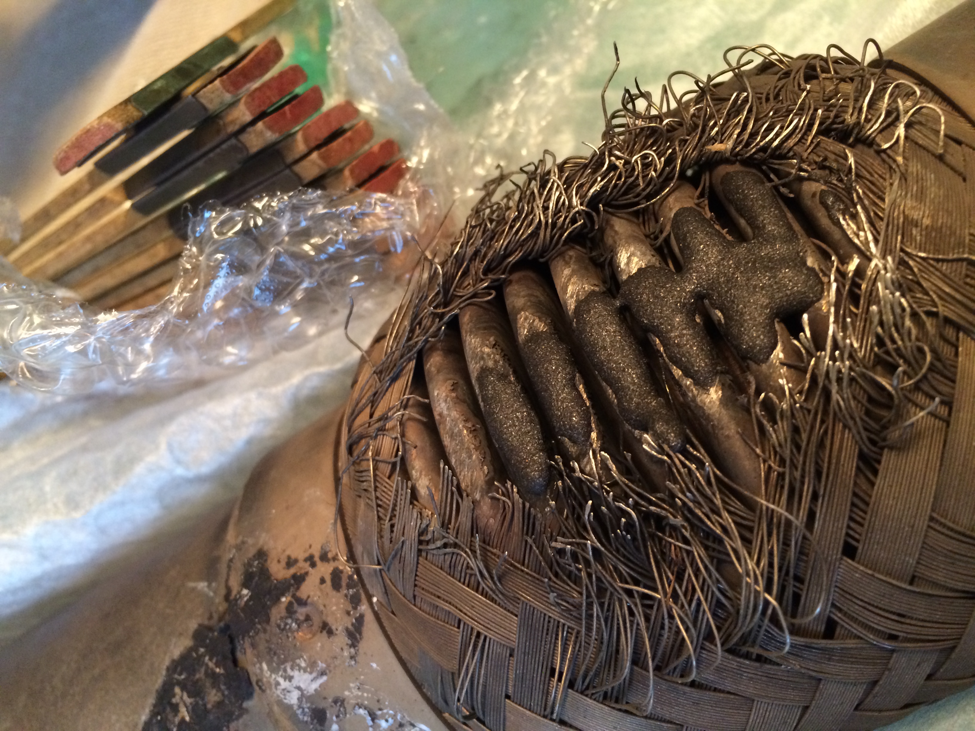

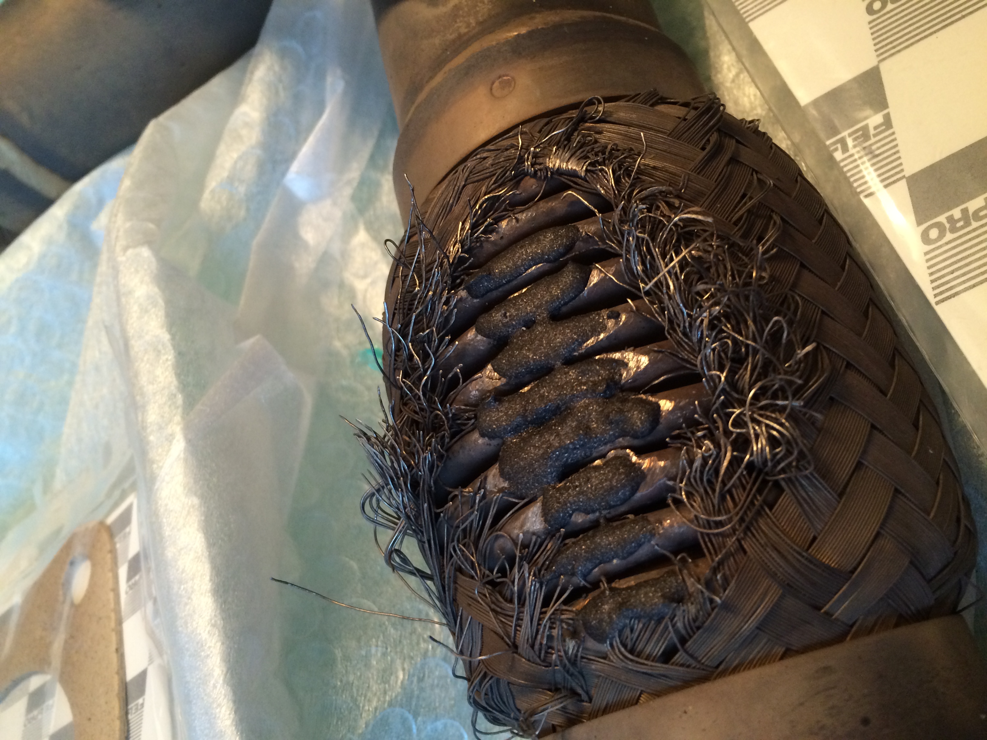

The area on the Y-pipe in my previous post was from it rubbing the ground hard enough to cause three small holes in the flexible part of the tubing. I closed them using high temp JB Weld, the exhaust repair kind. Other than that the systems seems to be in good shape. Now for the gaskets in question.

First three pics are of cat to y-pipe and mid-pipe to muffler gaskets. Other pictures are of y-pip to mid-pipe gasket.

Is it possible to use a dremel tool to get the ID closer to the actual pipe ID? I think I'd try to get that to match up closer.
As far as removing "gunk" from your pipes, Nevr-Dull is a good product and here's a good post along w/ polish for a nice finish
https://www.myg37.com/forums/g37-sed...ml#post3929009

Tanabe Installed
Finally got my Tanabe catback installed this morning. The process was not bad at all. It should have taken two hours, but I had to ride my bike to lowes to get hardware for the muffler to midpipe. Overall time was 3 hours. The sound is a bit louder than I was anticipating but I'm am happy with it. I didn't take many pictures as I feel like it is pretty straight forward process. The most difficult part for me was getting the old muffler off of the rubber exhaust hangers and installing the tanabe midpipe onto their exhaust hangers. PB Blaster was my biggest help. Below is a picture of my ingenious ramp system. If anyone needs tips or points when installing your own catback PM me I'm happy to help.
