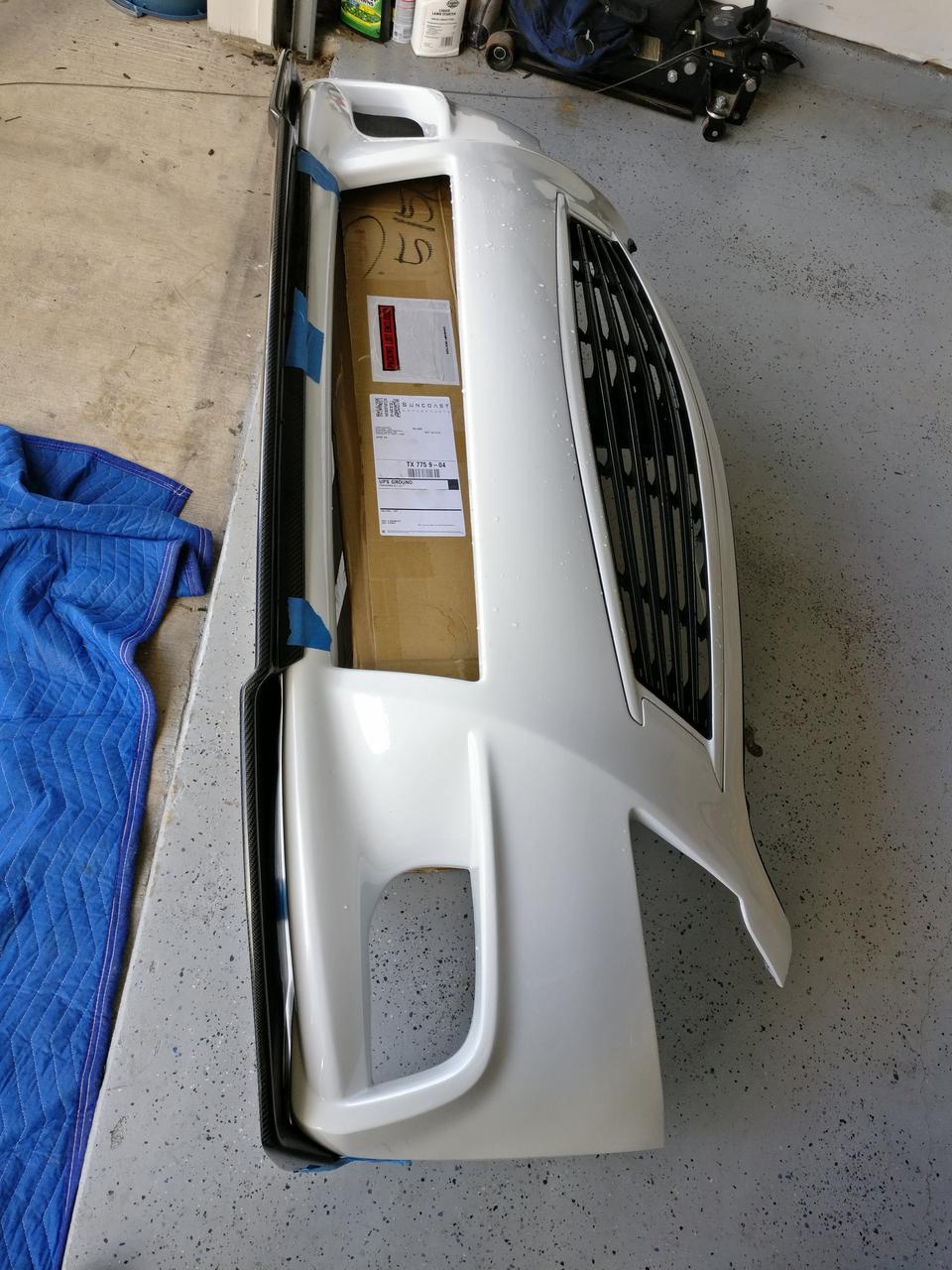

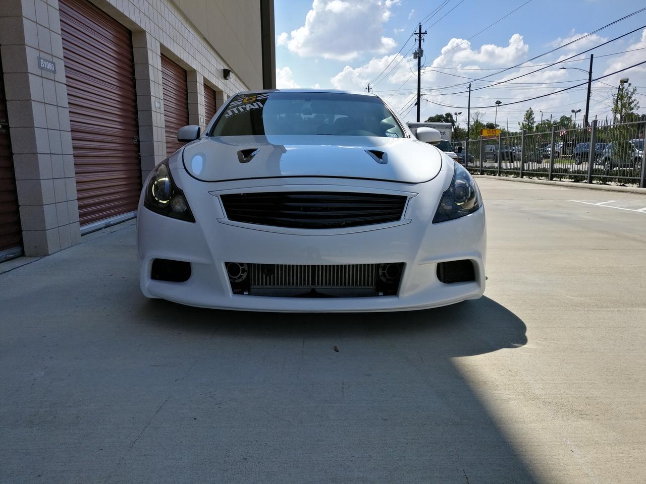

They did a nice job of molding that in. Did you relocate the backup camera? If, to where?
I dig it, definitely a bit more pronounced than my duckbill and the rest of the kit ties in nicely. Well done OP

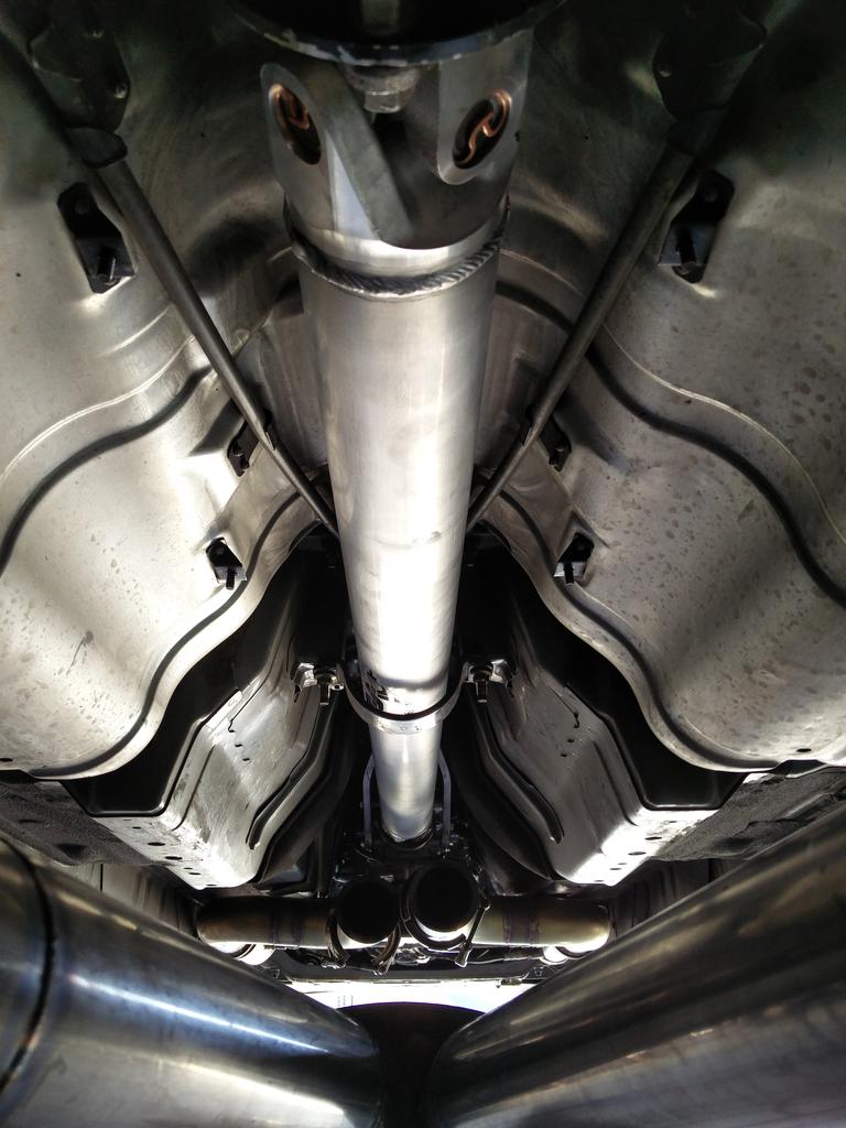

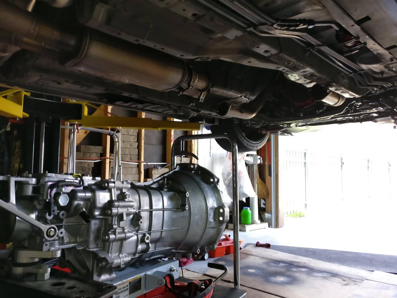

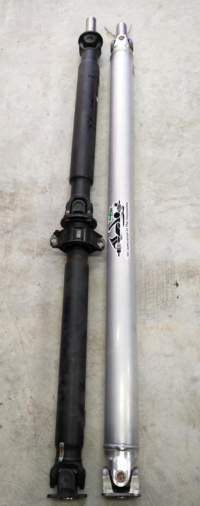

If anyone has ever tried to find a one piece driveshaft for the V36 sedan they probably ended up in the same predicament as I did - it doesn't exist! You might ask why not use a one piece driveshaft for the G37 coupe? I did too, but no one has done this and I really didn't want to buy something that large and not have it fit. Drive Shaft Shop wouldn't let me know the length of their one piece driveshaft for the G37 coupe (trade secret?), but I was finally able roughly measure my driveshaft and ask them if they were the same size to which I was only told "Nope it's too long, it wouldn't work."
In the end, the proper solution was to completely remove the driveshaft, measure it exactly, and custom order one from Drive Shaft Shop. About a month after measuring and ordering it finally arrived and today it was installed:
Tonight was finally the night I could hit up the track! After installing the driveshaft, spot checking the car, and throwing the track wheels on I headed off!
But, after driving an hour to the track I find that it was closed in preparation for an event tomorrow!
I guess I should've called first..
In conclusion, if anyone is wanting/needing a one piece driveshaft the guinea pig work has been done and the specs are now with Drive Shaft Shop!

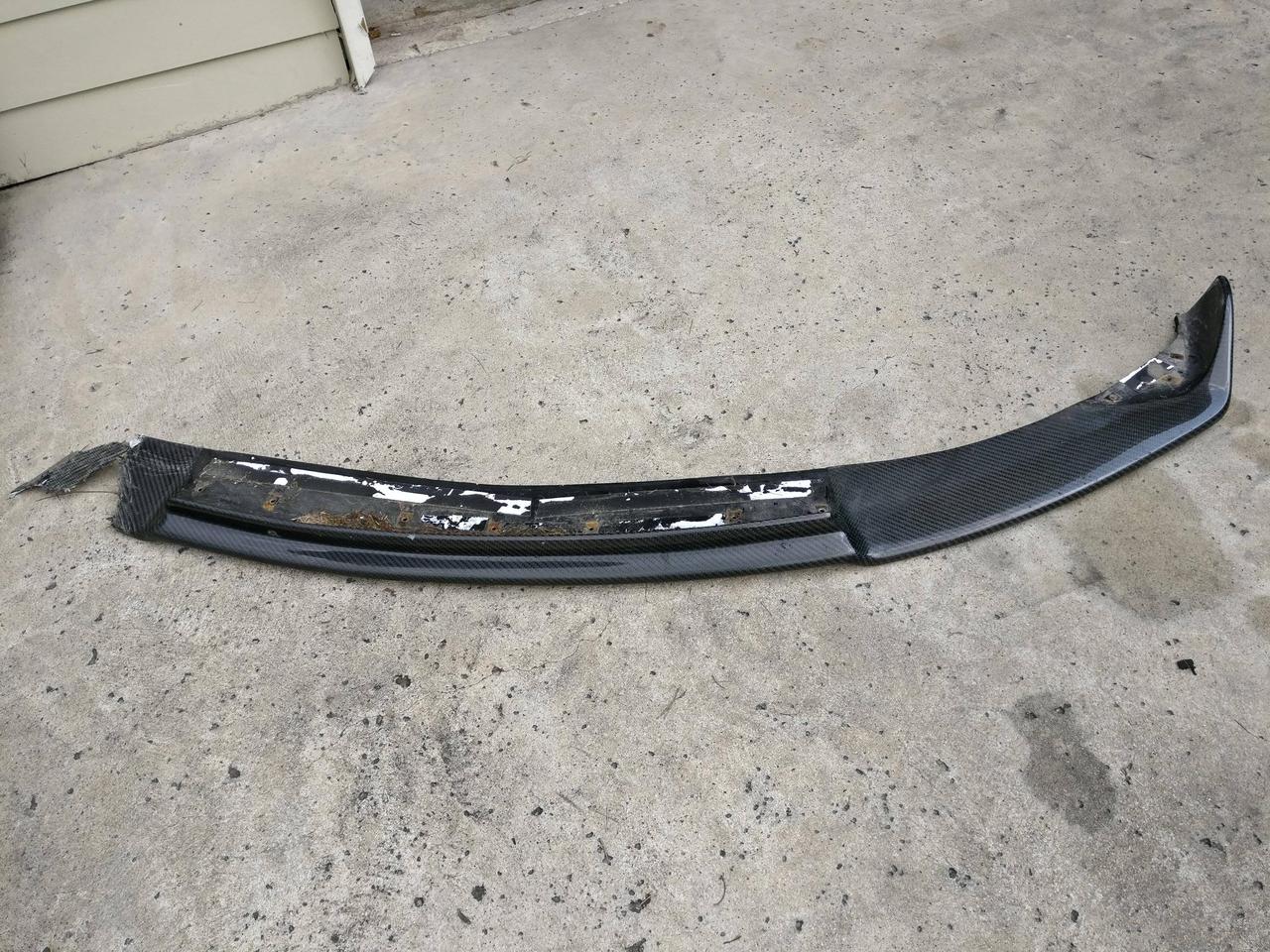

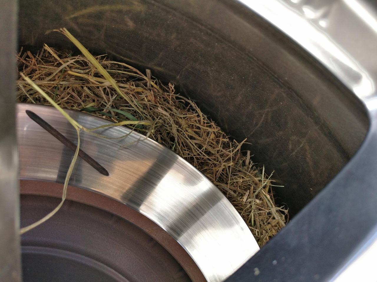

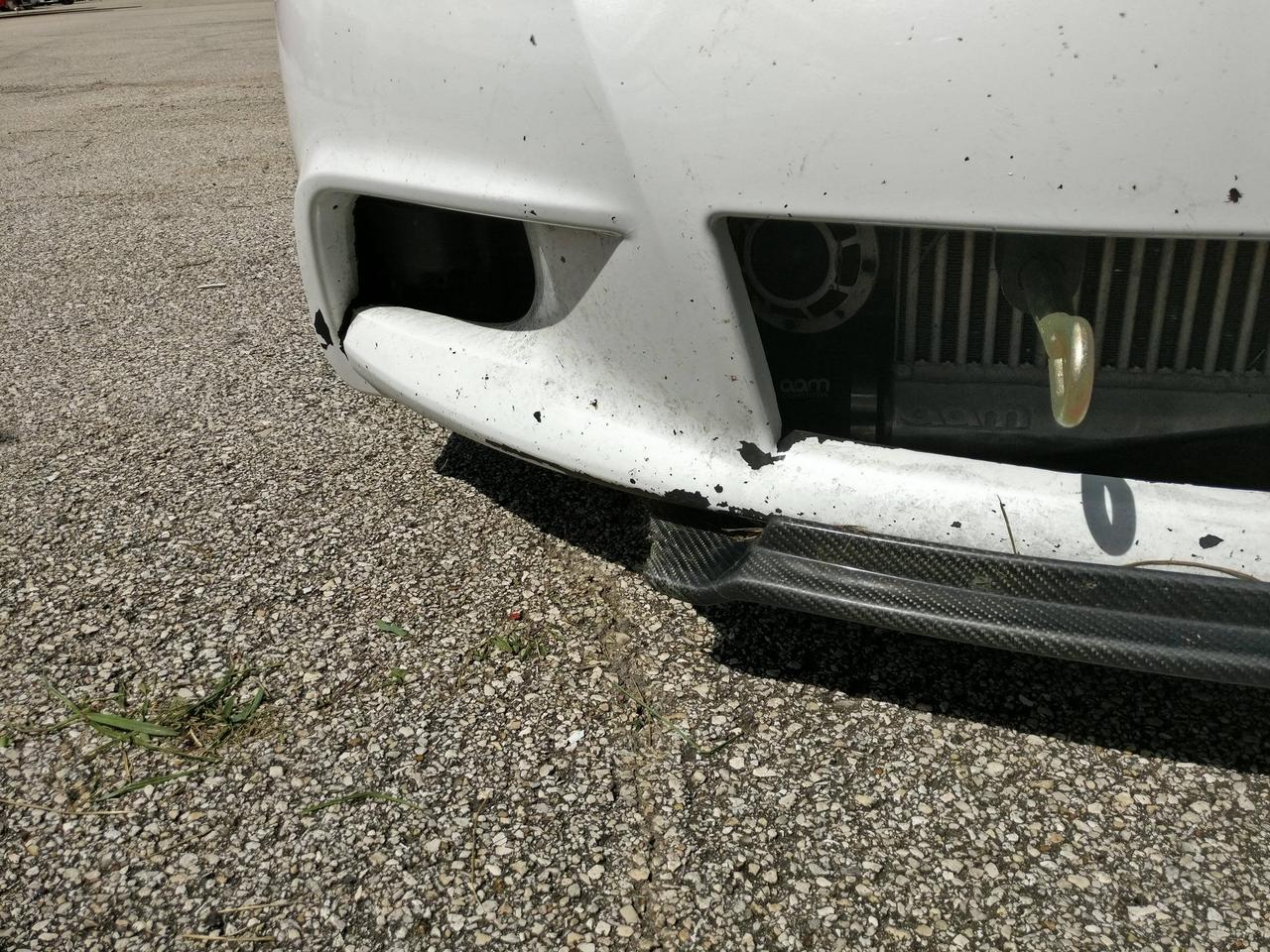

I ended the weekend at MSR with some yard work:
Apparently a Carbon Signal lip is not good for mowing the lawn..

I will begin with the DSS driveshaft - the car seemed to drive fine after installing the driveshaft but when I got up to 90 mph there was an annoying vibration which only got worse as speed increased. By 120mph the car felt like it was going to wobble itself sideways. After removing the driveshaft there were plenty of gouges on one side which meant it was either not true (straight) or it was unbalanced. Sorry, I have since gotten a new phone and I don't have access to my backup pictures right now to show the gouges as they are on my desktop, in a box, in a storage unit.
After putting the stock driveshaft back on, the one piece was sent to back to DSS for them to check it and/or rebalance. DSS had turned the driveshaft around pretty quick, but I figured I would hold off on opening the box and installing it until I got my new clutch...

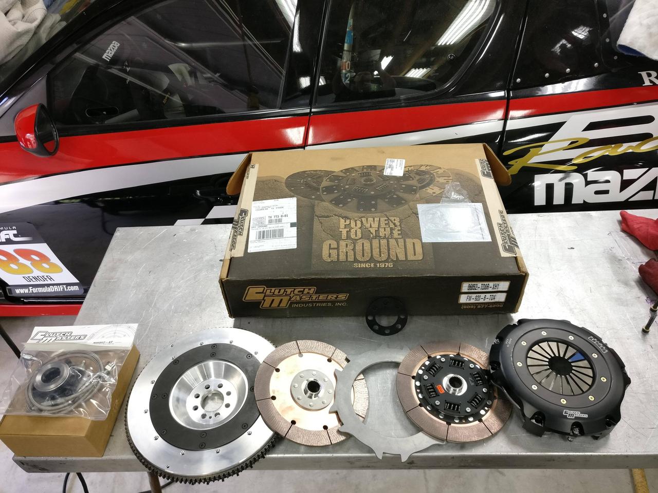

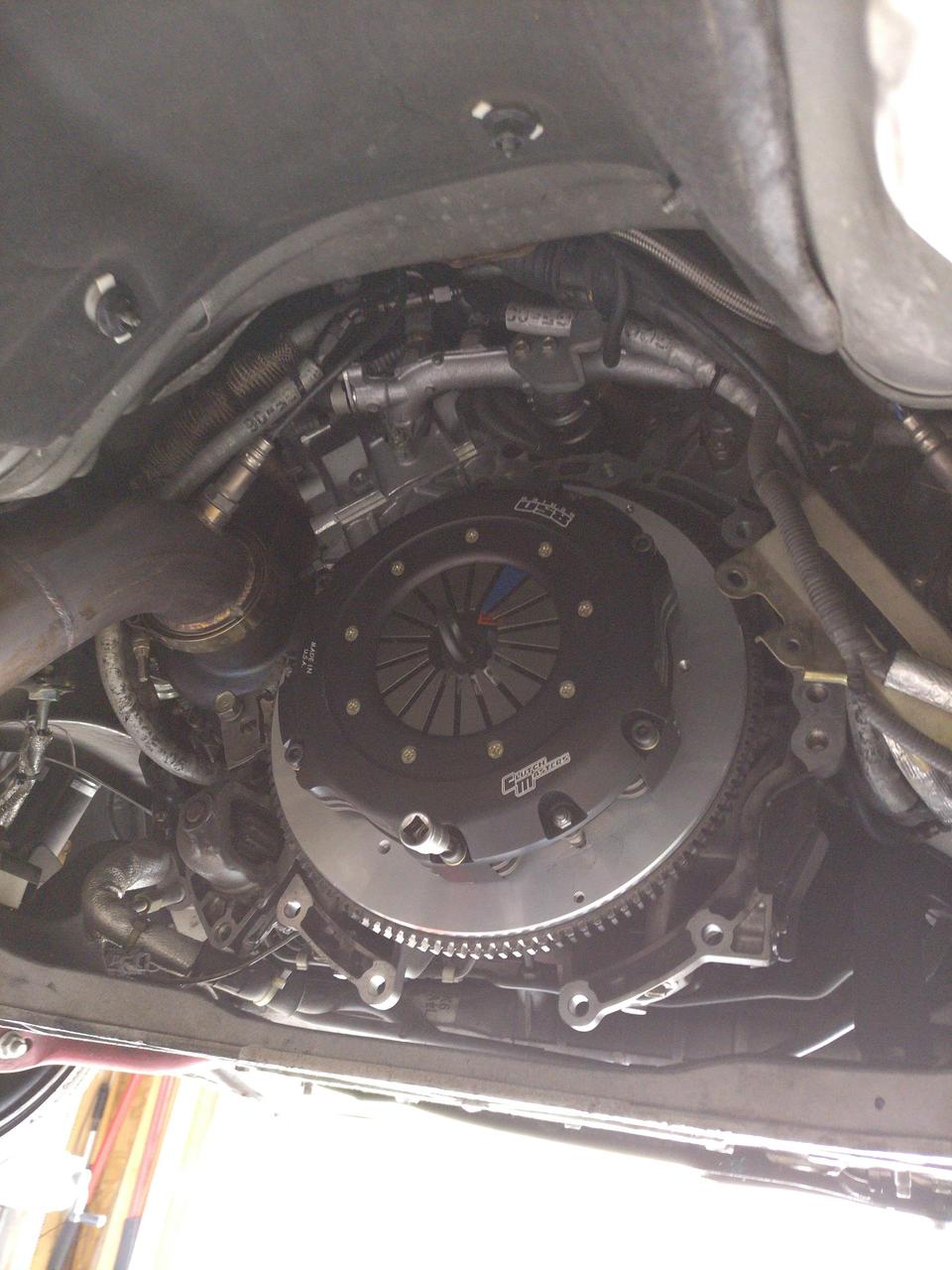

You see, my Southbend Stage 3 Drag had began to slip after a few months at 713whp/680wtq. So, around the time I sent the driveshaft back to DSS (March) I had placed an order with a local 'business' named Jester's Toybox for an OS Giken Triple plate.
After months of BS / broken promises June rolls around and, long story short, I got screwed over by said 'business' and ended up filing a PayPal dispute to get my funds back.
PSA: DO NOT DO BUSINESS WITH Jester's Toybox
I guess the name should've been forewarning enough, but he was local and seemed like a 'good' guy so I thought of giving him the business.
Ron, the mad scientist/engine builder/mechanic, was able to promptly get me a Clutchmasters FX850 Twin Disk and we began the install these pending things:

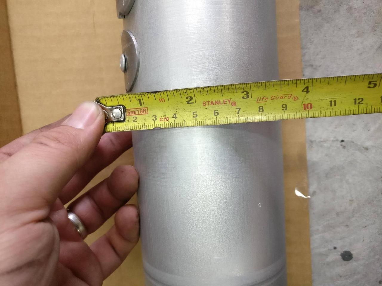

Just checking the width of the driveshaft that was refinished/rebalanced and sent back to me.

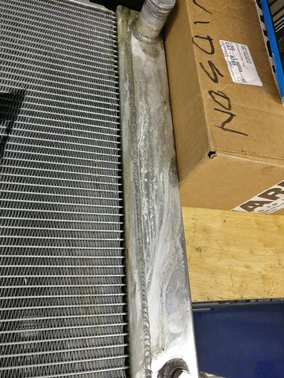

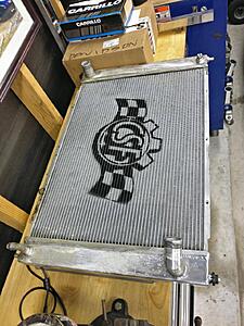

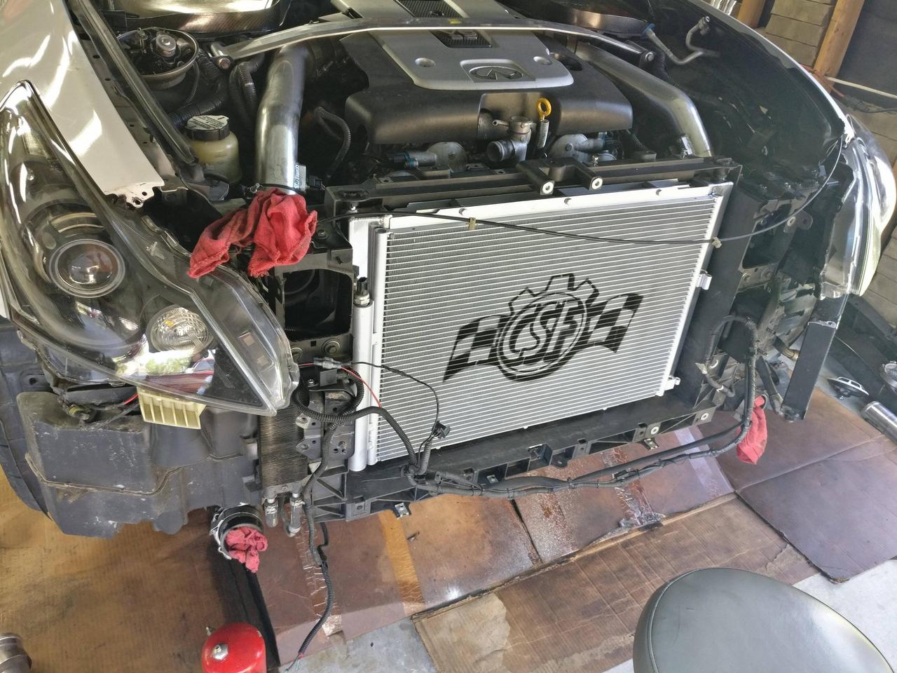

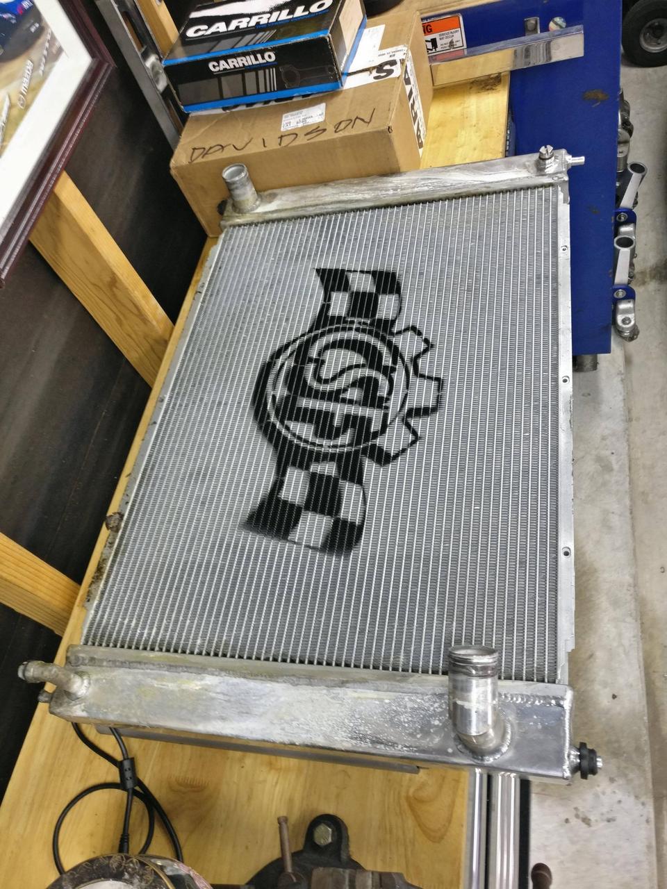

Oh, I forgot to mention that along with the slipping clutch my CSF radiator had started leaking.
CSF was amazing and sent a new one to us, they have gone above and beyond what I would've expected from them!

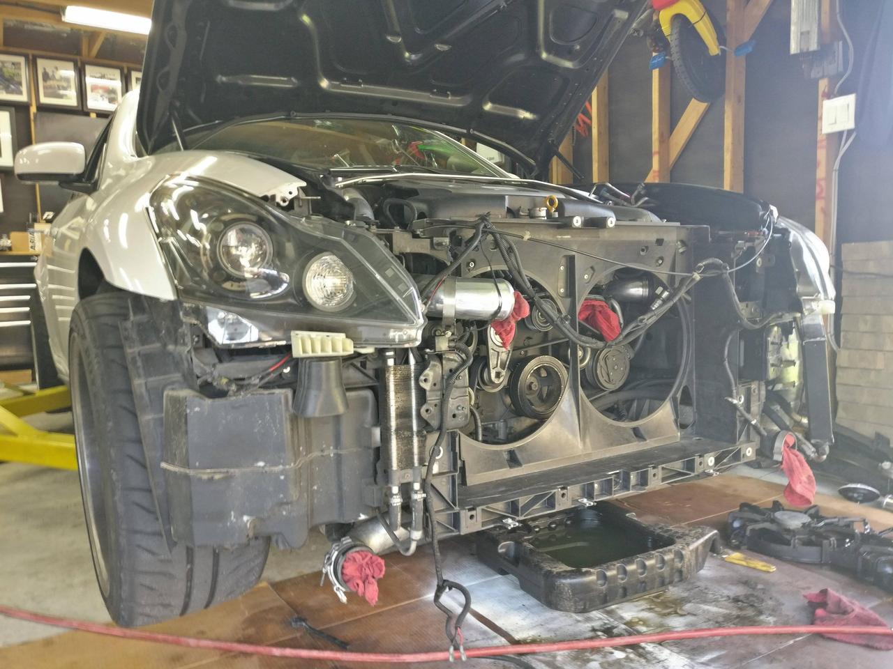

After the head lift last fall I have been preparing to rebuild; I guess every great story eventually has a reboot?
The motor started knocking recently so I think time is running out, it's too bad it is on it's last leg but considering how I drive the car it's held up quite well. Overall the smiles per hour over the past 2+ years have made everything worth it and I've learned a lot about our platform.
Fortunately some pieces of the puzzle came in yesterday.
I have acquired a few smaller pieces in preparation but haven't taken pictures of them:

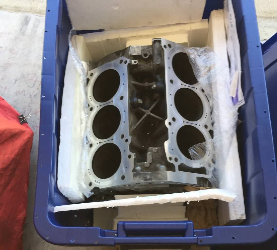

RJ Manufacturing Closed Deck Block

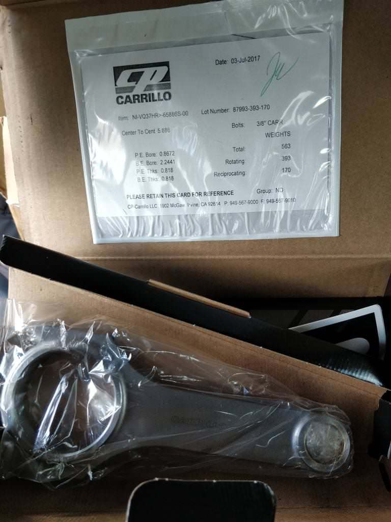

Carillo VQ37 H Beam Rods w/CARR bolts

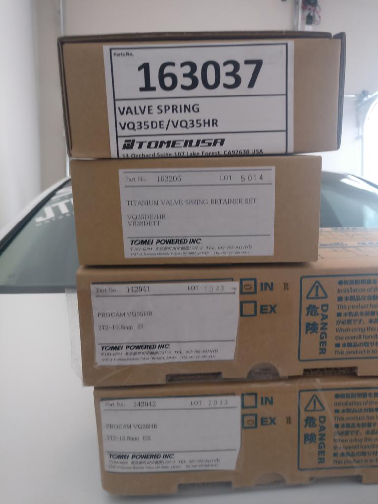

ID1300 Injectors
Tomei ProCam 272 10.8 IN/EX
Tomei Valve Springs
Tomei Titanium Retainers

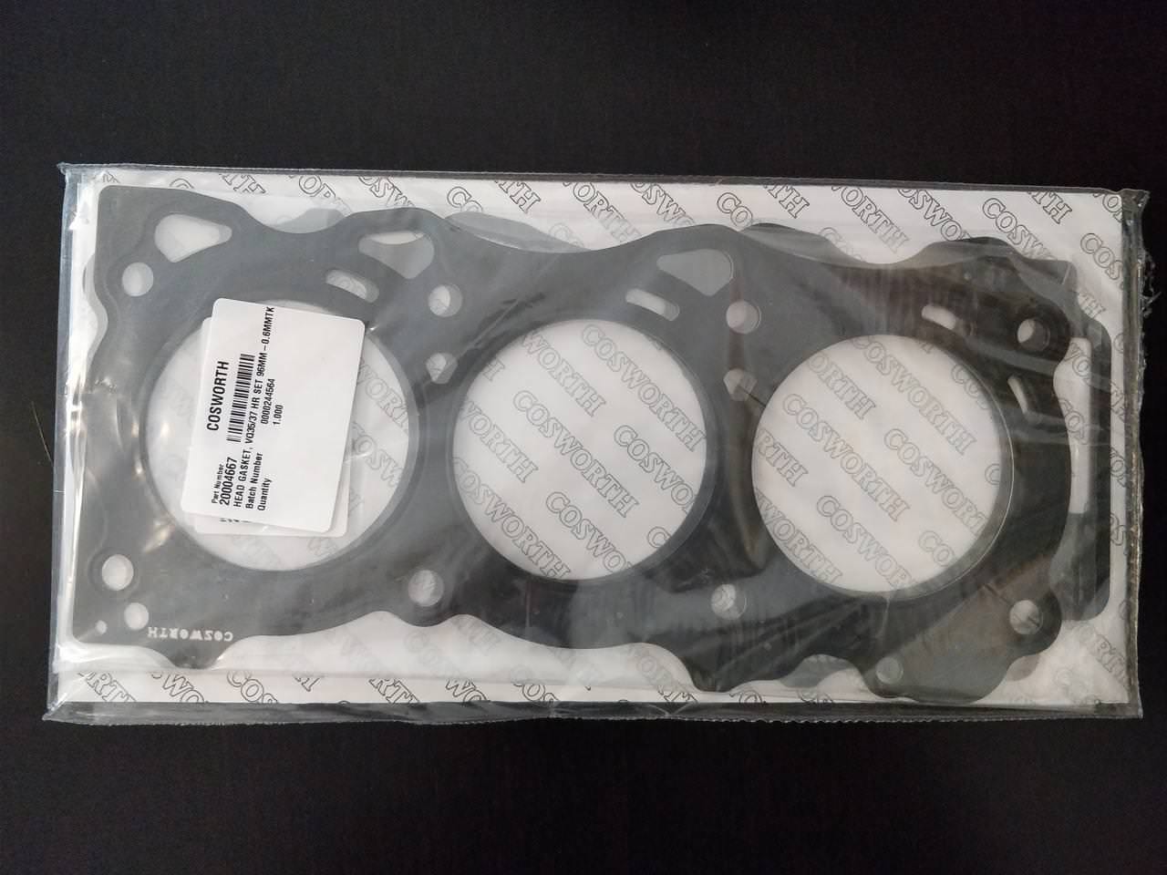

Cosworth HR/VHR Head Gaskets
ARP 625+ Head Studs
ATI Super Damper
EPS Oil Gallery Gaskets
Z1 Solid Motor Mounts
Synolimit Ported VQ37 Upper/Lower Intake Manifold
Synolimit Ported Throttle Bodies (s/o to Upscale Speed)
BW/AAM High Pressure Wastegate Actuators

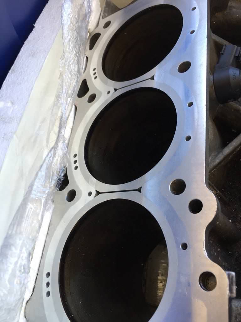

RJ Manufacturing Closed Deck is in, will probably start building this outside the car and do the swap sometime later this year.

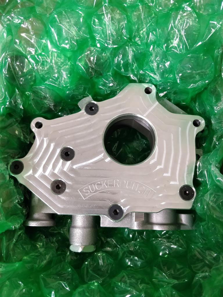

That means this is one of the final pieces of the puzzle - a Suckerpunch Motorsports Oil Pump! This combined with the Tomei cams and ATI Super Damper should allow me to safely raise the redline to 8500rpm and possibly even 9000rpm (if we are daring enough to try).
The only thing I'm waiting on now is for a new set of custom pistons which have been ordered and should be 3-4 weeks out, after which the rebuild will begin.

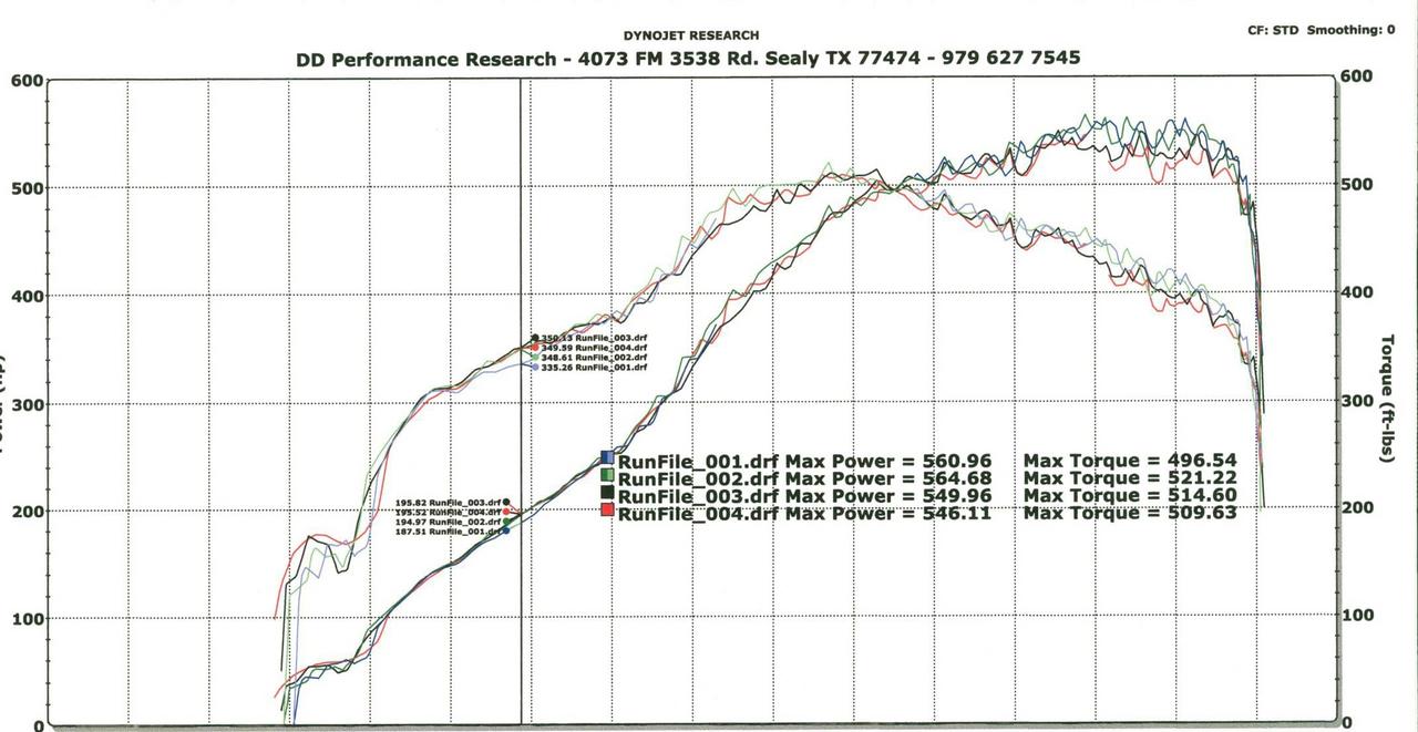

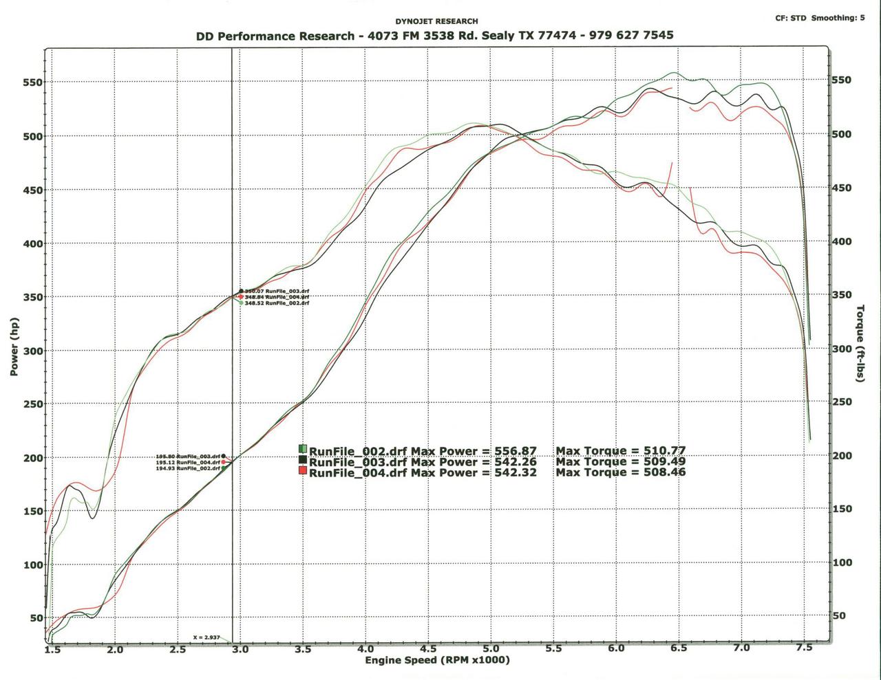

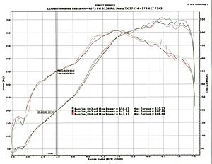

As I've mentioned before I started tuning my car on Uprev by myself since the head lifted back in November and now that I am getting close to the rebuild I wanted to get the car on the dyno to get some numbers for the tune. A friend recently had his car retuned at DD Performance Research which has a 4wd dynojet. I originally intended to hit up both DD and Kozmic on the same day to have comparisons between DD's dynojet and Kozmic's mustang dyno, but another friend went ahead and put his car on DD's dyno first as he originally had his car tuned at Kozmic. His car made 380whp on Kozmic's mustang dyno and 382whp on DD's dynojet. Seeing as how there was only a whopping 2whp difference between the two dynos I decided to not even have my car run at Kozmic.
Here are the results for my self tune on 93 at 14.5psi:
Smoothing 5 applied:
The tune needs a little more work, but at this point I'm calling it good as I will start a new tune from scratch once the new motor is put in. I'm pretty stoked that my tune was pretty much able to match the numbers that the car previously made on 93 and Jtran's tune.

Rods
Head Gaskets
9/25/2017:
