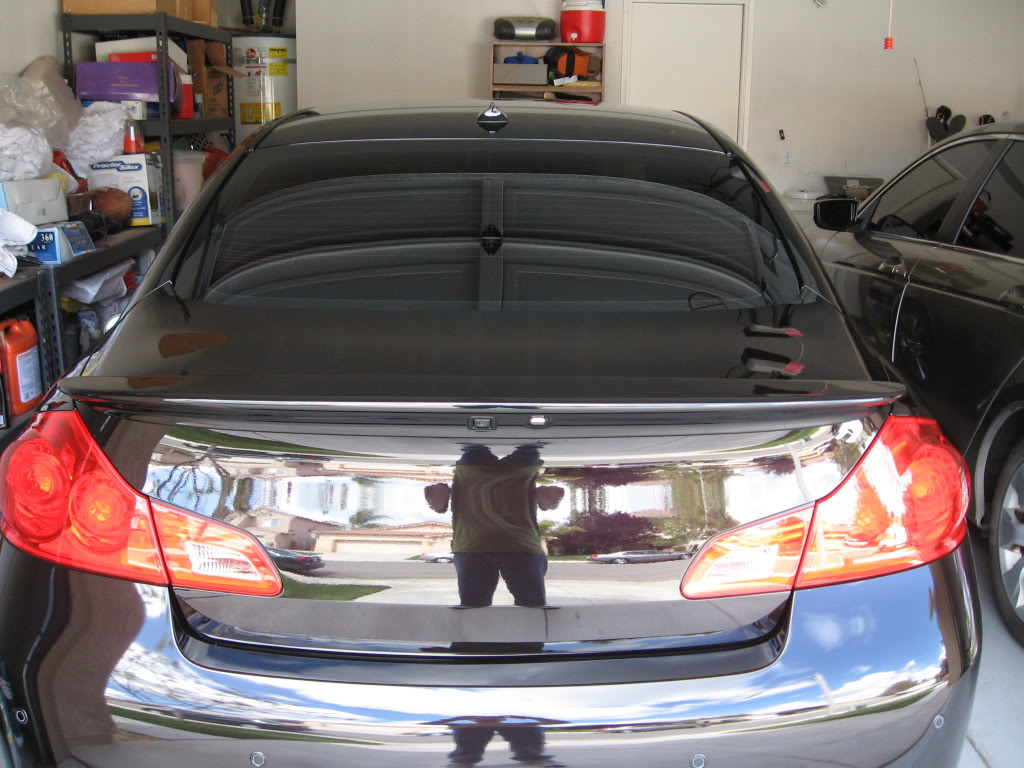

I like how you removed the G37x badge, but kept the INFINITI lettering. For some reason, in this picture here, that looks better than otherwise. I'd kind of like to do that too, but just can't bring myself to remove the little red "S", and can't think of where to relocate it.

You know what? For the last 20 minutes, I've been busy erasing the G37S badge off my trunk (photoshop), and in every single doctored photo, I find myself liking the balanced look more than I'm lamenting the loss if the "S".
OP, you've given me serious pause for consideration on this little de-badge. Up until now, I've always dismissed it (because S). Hmm.

My G37S badge is gone. (Big red S and all, LOL)
Easy peasy. Looks clean and balanced now.
OP, your picture inspired me.
- Heated each piece with the hair dryer
- Sliced easily through the adhesive with fishing line.
- A little bit of elbow grease with the pads of my fingers to roll the adhesive off the paint.
- Goo-b-gone for the rest.
- Some light polishing compound.
- Paste Wax.
