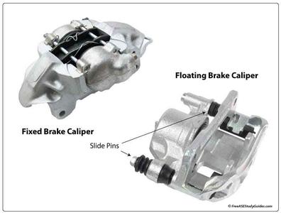

Sounds like a stuck caliper if only one side is worn (inbound or outboard). The g37x does not use fixed calipers where only the pads move in/out. Rather it uses a floating caliper where the entire caliper slides on a pair of pins. If the caliper is not maintained (cleaned/lubricated periodically), it will get stuck and you are experiencing the end result.
If you replaced the caliper, did you lube the slide pins?
Recall the g37x sedan has a open diff, not limited slip. So with the car off the ground, one wheel will spin, the other barely. What happens when driving, do both rear wheels feel equally hot/warm after braking?
