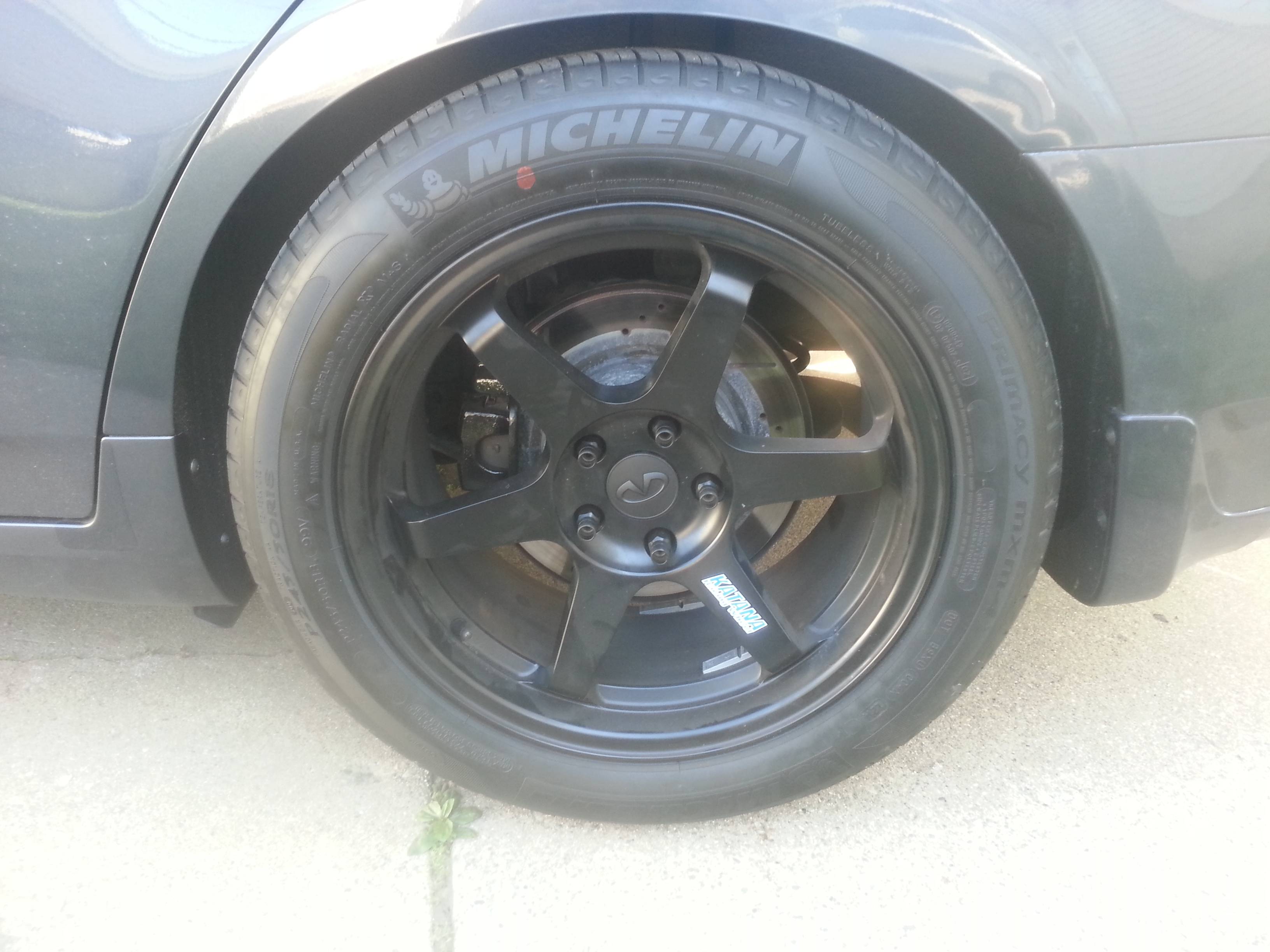

My rear drivers caliper just seized on me last week. When I was on the freeway the car felt like a wheel was improperly balanced, so I got off the freeway asap. When I was on the side roads it was much less noticeable, so I just drove it the rest of the way home. When I got home it was dark, but I decided to check the lugs since I had them off recently and wanted to make sure I secured all of them. Went around to all the wheels, and when I got to my rear drivers side I could smell a burning hot smell. I touched the lugs/wheel and it was extremely hot to the touch. Noticeably way way hotter than any others.
Morning time I jacked up the rear of the car and took a closer look. My rear passenger wheel moved very easily with little effort, but the drivers side wouldn't really budge. The pad was tight to the rotor, and the rotor had a slight discoloration compared to the others. I hadn't drove on it much, so I wasn't too worried about other damages.
Anyway, I've already replaced it, took an extra day of down time because mine are all painted so I had to match it. If your problem sounds similar I'd suggest taking care of it asap before your brake pads crack from all the heat. Good luck.
Freshly painted and installed!
