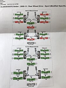

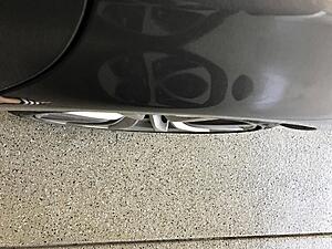

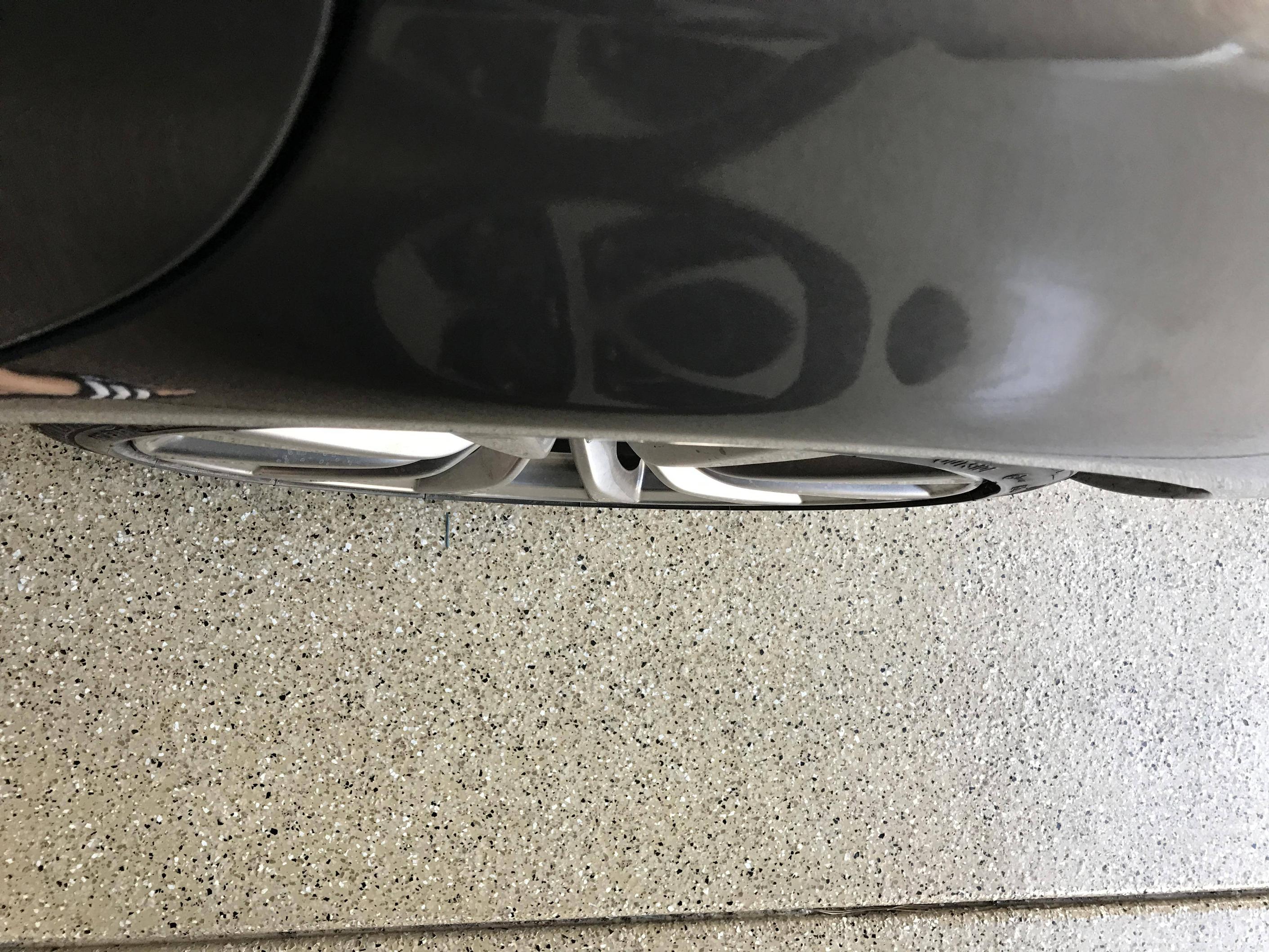

So i lowered my car on tein basis coilovers with spc front and rear kits.
The shop that did the work put on my wheels like this
Front driver 245 Front Passenger 225
Rear Driver 225 Rear Passenger 245

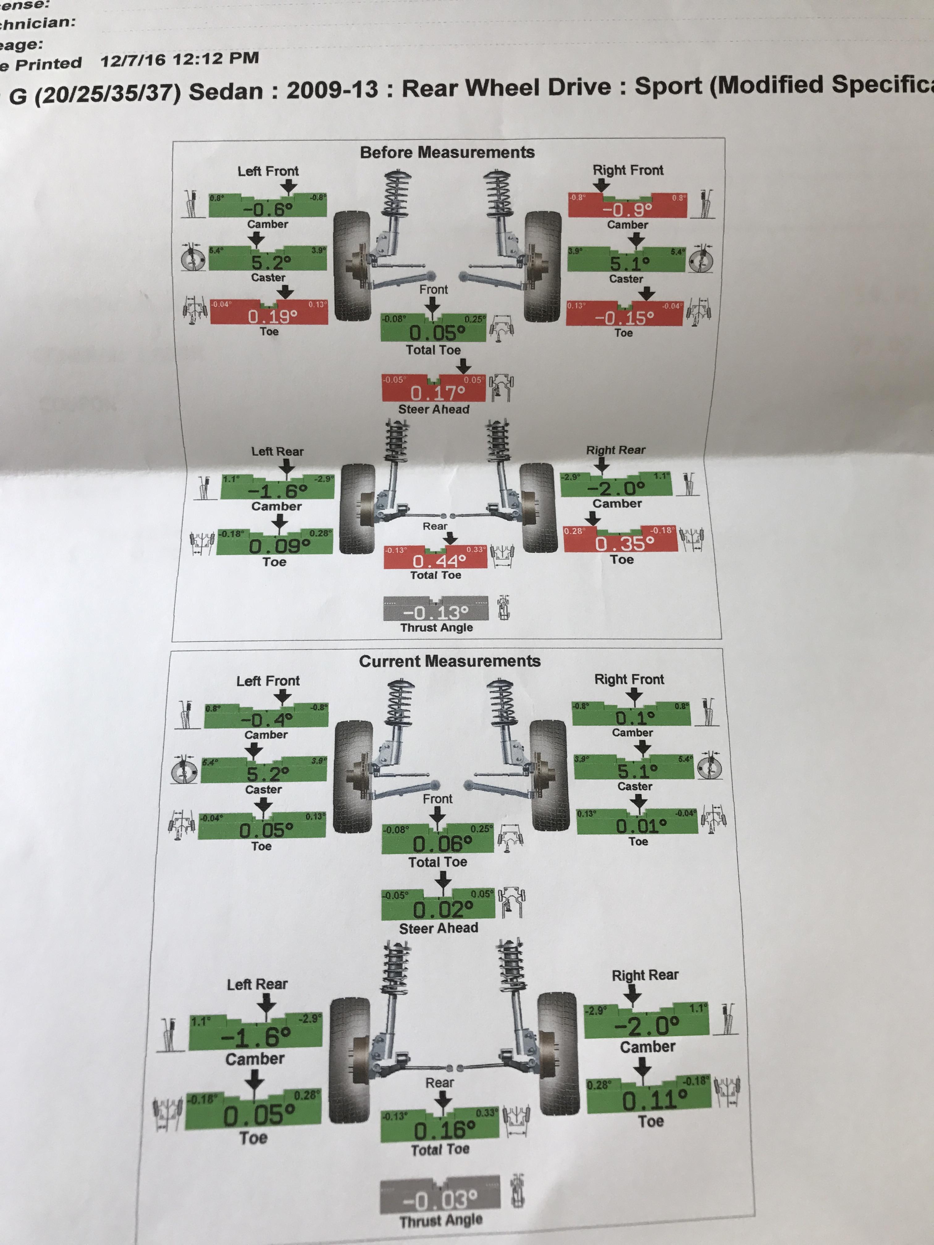

Now after about 400 miles of driving i noticed it and changed it to the correct way

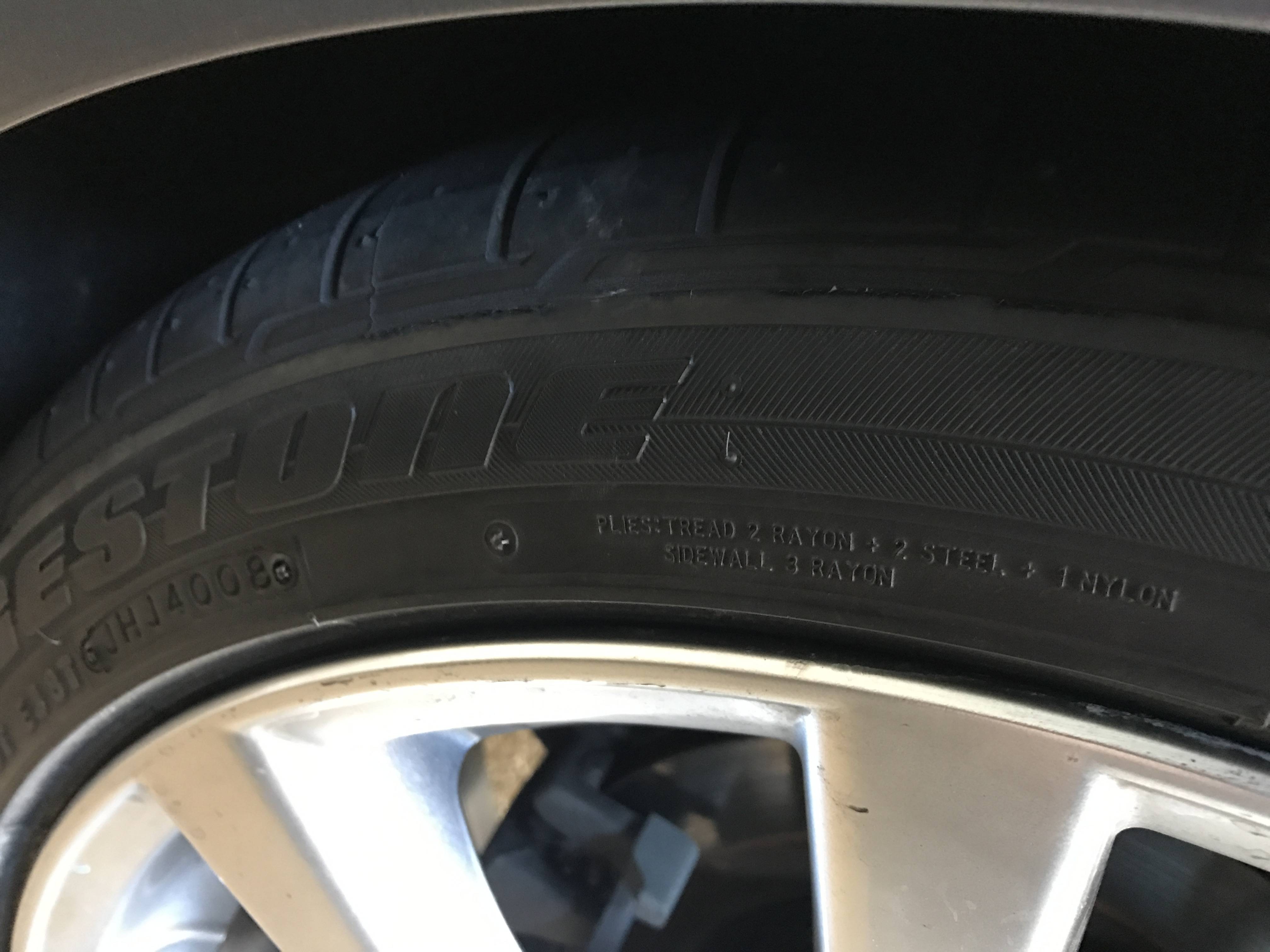

and got my car aligned but i noticed one of my tires seems like its getting eaten up (look at pic).
Could this be caused by how they put on the wheels incorrectly ??
I'm stressing out because i cant afford to get new tires in case anything happens right now.
I am lowered 26.5 in front and 26.70 -26.75 in rear

the pic above shows the fender maybe hit the tire ? its the only tire that is like that. I bought the wheels used. I only noticed it yesterday. The handling was very harsh but i thought it was cause of the 19's on the car and suspension.

What you posted the photo of is normal, it's just some excess rubber from the mold used to cast the tires. But putting them on as they did probably did cause some premature and unusual wear patterns. In only 400 miles it probably isn't a lot though. You'll be OK now that they're right and your alignment is better.
Old Dec 8, 2016 | 02:17 PM
Alignment is good and like BB said, that's just extra rubber in the manufacturing process. Hopefully that shop payed closer attention when they installed your suspension parts

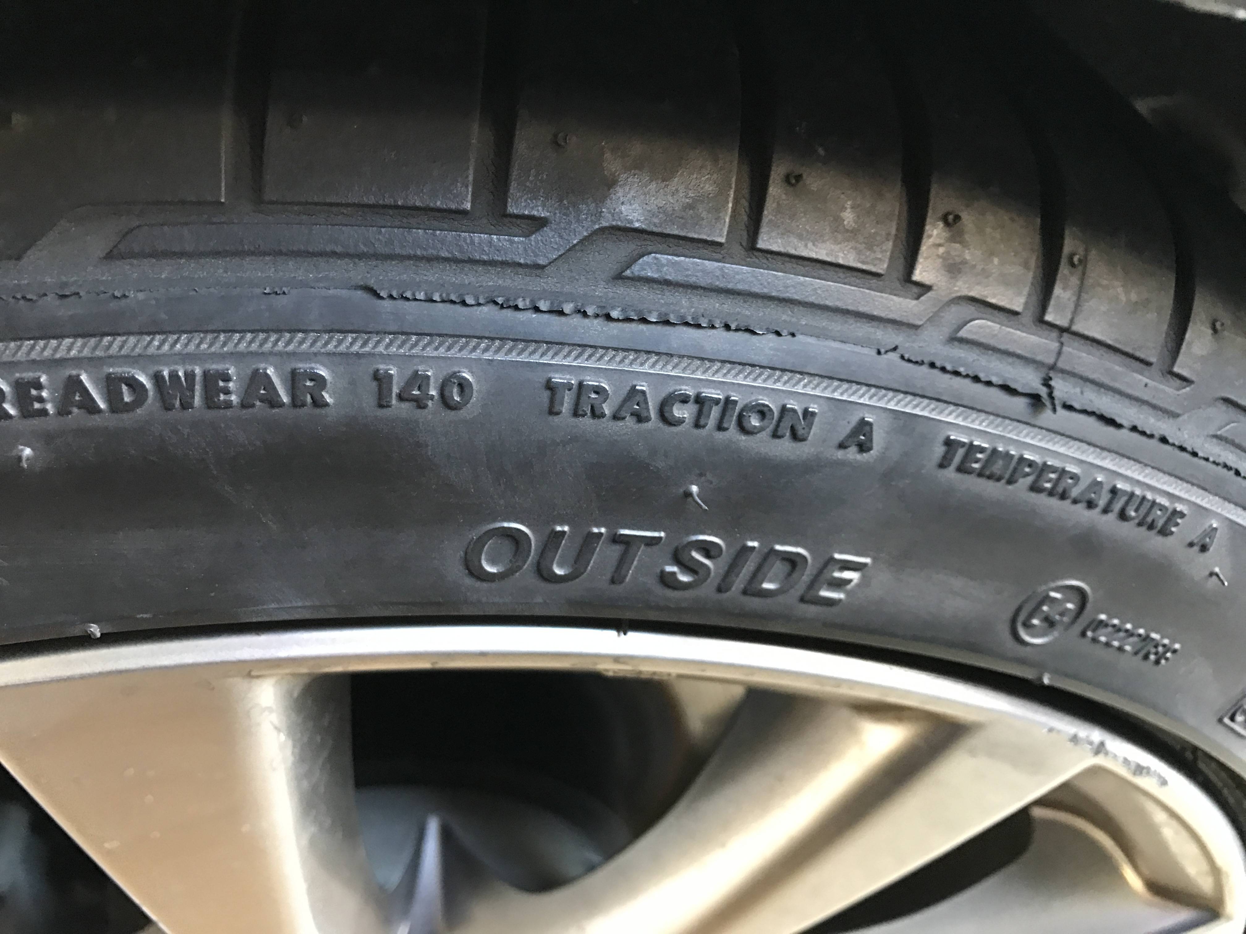

140 Treadwear wow! Make sure you check the production date on the tire. Should be a 4 digit number. First 2 indicate the week and last 2 indicate the year.

I had the second shop i went to get my alignment check my suspension and readjust the height. They said everything looked good.
I couldnt see anything. The bought the wheels used. The guy said he had them for a few years sitting around, Tires looked fine so i used them.
