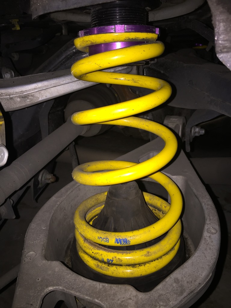

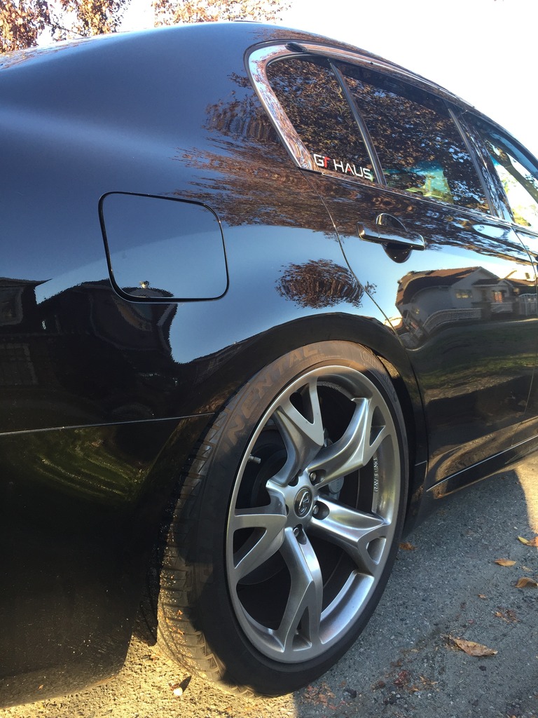

i have kw v3's and i have the rears at highest setting according to the instructions 40mm of thread. but its still tucking tire has anyone ever tried spring isolators to raise it up a bit

also had that problem. ended up selling the coils. options I came across though was to purchase a taller spring to give you more adjustment

swift makes coilover springs and you can get any spring rates you like. just need to measure the inner diameter of your current spring.
I'd say a 1in taller spring will be good.
Old Oct 12, 2016 | 10:53 PM
You can get the KW spring spacer, part #65030046 https://www.google.com/search?q=kw+s...h=576&dpr=1.09
do note i purchased these from ecstuning, they did not come as a pair. so you need to buy 2 pieces. i did not know this and had to pay shipping again for the 2nd one. have not installed them yet.

so i saw this idea from another thread so for now i just took the oem top rubber cone spring mount and used it as a spacer on bottom and it helped alot now i have a 2 finger gap
https://www.myg37.com/forums/brakes-...-question.html
Any difference in ride quality or handling after doing the above?

ride feels a lil softer i havent been able to test handling because of the crappy weather
Old Oct 16, 2016 | 12:54 PM
Probably have a bit better NVH too, hopefully it works out well for you and would be a bargain fix
