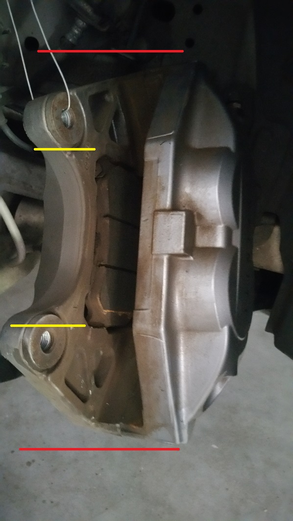

akebono.. are they really bbk
the rotors are a nice size.. although the entire setup looks like a fugazy to me..
four pistons encased on a big caliper... the pad surface area is almost the same as the four pistons on my mazda crossover..

Yeah, it's a true BBK, but they are a very bloated BBK. The slimmer 6 pot setups sold by Stoptech, Brembo, Wilwood etc. w/ the 2 piece rotors are a more track oriented and much lighter way to go.

I've owned some high $$$ BBK's and have to admit, on the street anyway, the Akebonos are more than enough. And you'll not find me saying that much about anything OEM. I've used the Mustang GT performance pack Brembos in anger and yes, they were nice if not a bit of overkill honestly. But I've yet to be disappointed in the Akebono setup even with the stock pads.
One caveat, I do have plans for two-piece rotors all around. More for unsprung weight savings than anything. The bolt-on Brembo kit is tempting but I've not found the need. If/when I hit the track, I may feel differently.

I typically define a BBK as being a floating caliper instead of a sliding design. Piston counts of 4 front/2 rear and up would be another good criteria.
I think you meant to say fixed caliper, instead of floating caliper. A sliding caliper would be a floating caliper.

2 piece rotors are nice for weight shaving but unless you're tracking the car often it's over priced option vs 1 piece rotor
