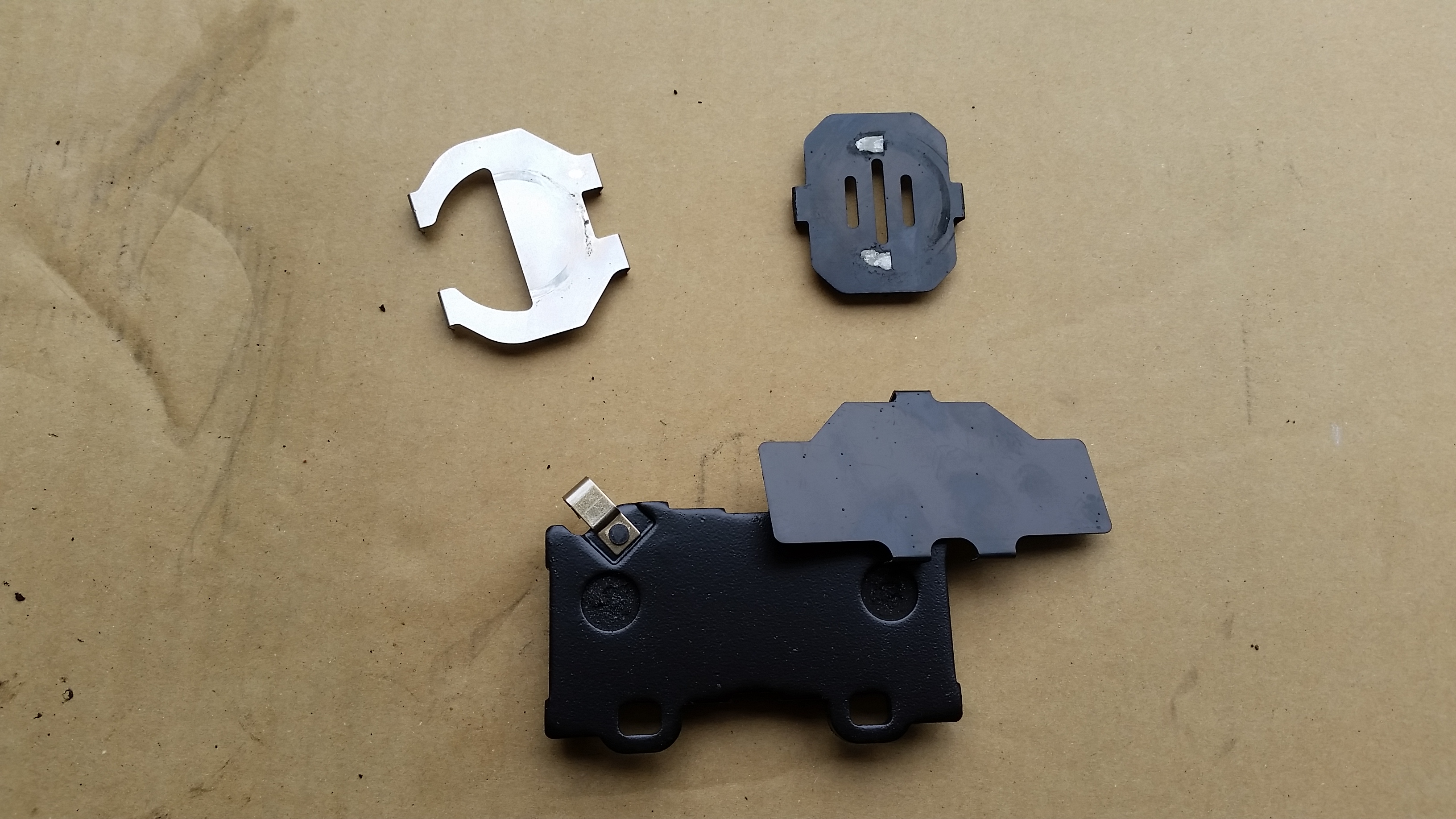

Okay guys, need a bit more help. The new pads came with a backing plate attached to it. I removed it from the pad in the picture.
Question: do I put the old backing plates (the ones on top) over the new one, remove the old ones and use the new one only, or remove the new one and use the old ones?
Also, for the pad with the low pad warning indicator, should that pad be on the inside or the outside pad? My guess would be on the outside so that when it is scraping we can actually see the scrape marks on the rotor but I want to make sure.
Thanks everyone!!

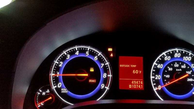

Ugh, did I do something wrong? After I finished installing the new rotors and pads, I started up the G and got 2 lights: VDC OFF and SLIP.
I did still had the car up on jack stands when I started the car and I did not pull the e-brake back up yet (I have a manual) so I'm not sure if any of that has anything to do with the lights.
Anyone have any ideas on what I may have done? Or does the car just need to reset?
Put the car back down and you should be OK.
Thanks everyone!!
If you have new backing plates, do NOT use the old backing plates too.
Replace the pads and backing plates.
If only one pad have the ware indicator, that pad goes on the inside as i remember..

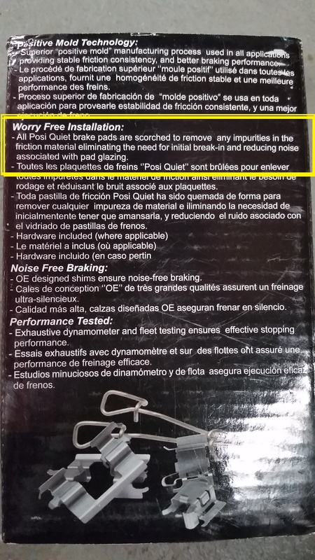

This leads me to another question...what is the bed-in procedure (if any) that you guys have used for Posi-Quiet pads? On the box, it states that there isn't one:
but it just seems odd to not have a bed-in process for new pads. Should I try a bed-in process of some sort or don't worry about it?
Old 05-09-2016, 09:01 AM
  #40
Join Date: Nov 2009
Posts: 24,877
Received 4,941 Likes on 4,174 Posts
Those aren't a high performance pad so just some spirited daily driving should get them working well.
Check the master cylinder. Fluid probably got too low. Top it off. lights should disappear.

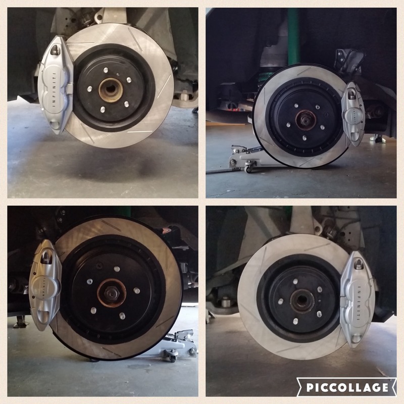

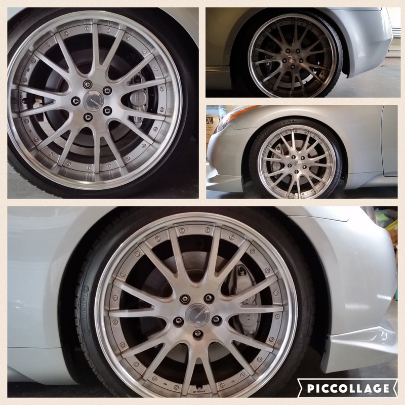

Thanks to everyone who helped out with this project - especially Brad and UCLAG37!! I would not have been able to complete everything without you guys' help and encouragement along the way. I finished everything today and here is the final product:
Old setup:
New posi-quiet pads and Stoptech slotted rotors installed:
