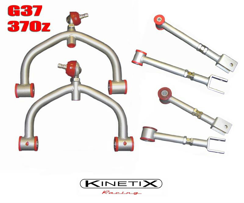

How are these Kinetix?
Attached Thumbnails best camber kit for g37x coupe-g37aarmcambertractionkit.jpg
The ball joint was a problem area, not sure if it's been upgraded though
TBH I would stay with SPC, Voodoo, or SPL depending on budget. Eibach also sells kits but it's just a rebranded SPC part with a little extra $$ tacked on usually.
