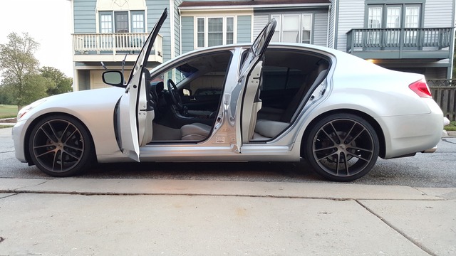

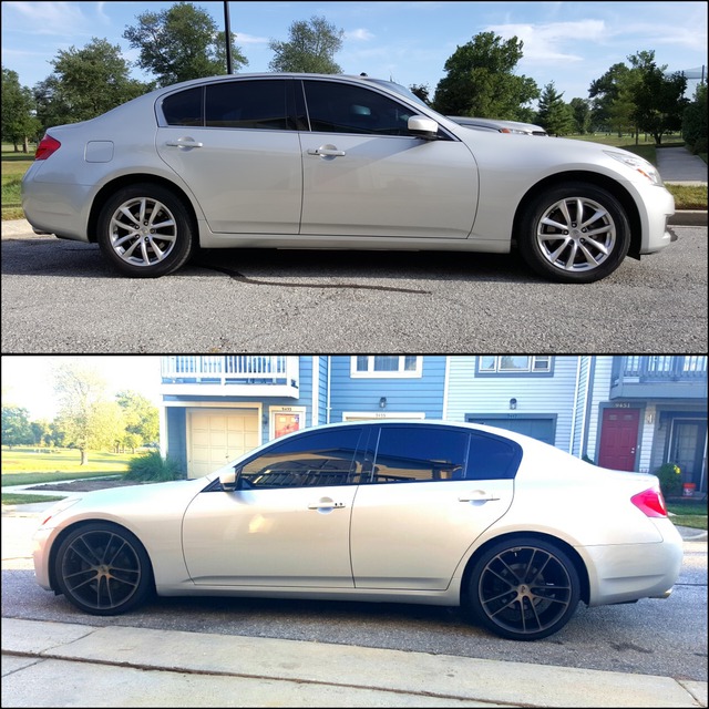

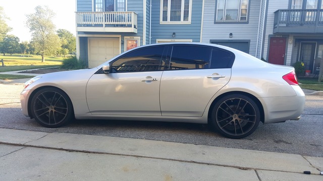

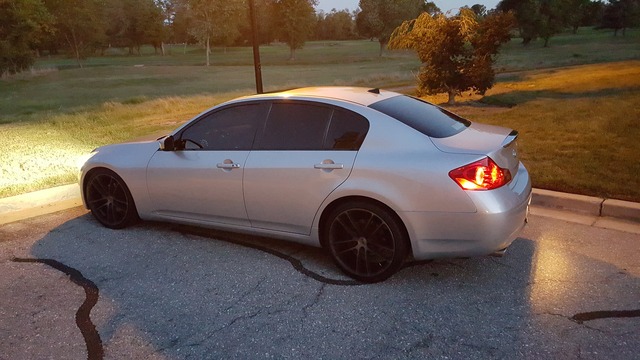

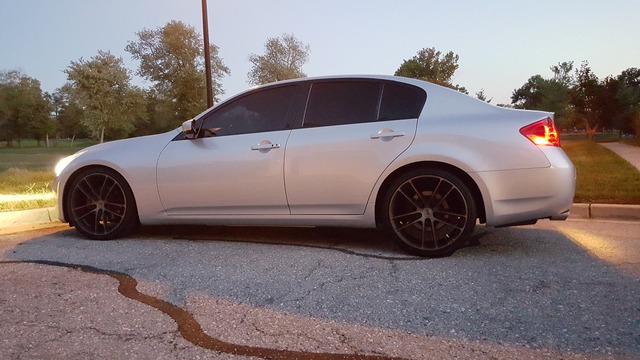

Ok, all. Been a busy few weeks, so I just got started on her. Decided on the Niche Enyo. 20x8.5 all around with the 245/35. Swift drop. Looks like I might actually need a slight camber adjust, nothing major thankfully.
Other: blacked the chrome window trim, stripped my 20% tint and replaced with 5 all around. Blacked the shark fin, and doing the roof black maybe this weekend. Also carbon fiber wrapped the interior trim. Few more things planned; I'll spare you the list. Anyway, on to the kudos and pics.
Thanks blnewt for the offset assist. Pardon the crappy pics, was in a rush....

Great looking transformation there ^^^
Wheels, trim & tint really go well together
Glad the wheel offsets worked for you, and nice to be able to do a true 4 wheel rotation too.
