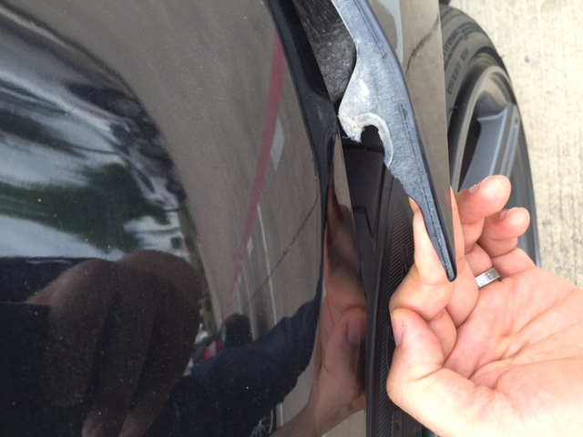

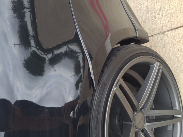

Can you guys give me a good suggestion to get this fixed?
I dropped my car and trimmed the rear fender liner to avoid the rubbing issue. Then the side of the rear bumper keeps popping out. Did I trim too much? I am planning to use double side 3M tape and apply it between the fender and the body so that it could hold in place. However, I am also worried that it will leave a gap and the adhesive tape will catch dusts that might become annoying to clean.
Does anyone else dealt with this problem before? How did you guys fix it?
Attached Thumbnails Rear fender liner trimmed and side keeps popping out-img_1996.jpg   Rear fender liner trimmed and side keeps popping out-img_1997.jpg

Do you have a picture of what you trimmed? Hopefully it can be fixed w/out much trouble.

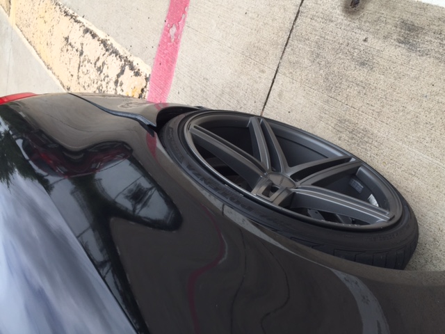

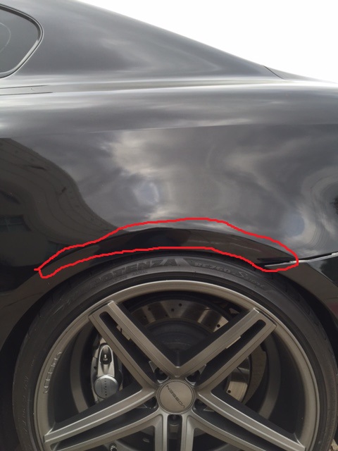

Yeah of course!
First, my car was a lower from the beginning but I raised it up a bit before the winter season.
If you put your finger underneath the red area on the picture, there is a fender liner and I pretty much trimmed the whole red area.
Also the bolt area where the side keeps the bumper in place.
Attached Thumbnails Rear fender liner trimmed and side keeps popping out-img_1998.jpg   Rear fender liner trimmed and side keeps popping out-img_1999.jpg

It looks like that's about all you could do at this point, you could always get a touch up pen w/ your car paint code and run the paint along the small strip of adhesive to basically seal it from dust, or if you can get a real thin bead of black silicone in there after you get it taped, just a real thin bead to seal the tape a bit better. That tape is pretty thin so it shouldn't leave much gap FWIW.
