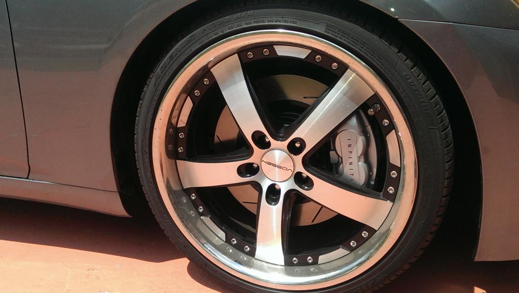

I have less than two millimeters between my vossens and the Akebonos. There will not be any issue as long as you torqued down your lugs while fitting the rims.
