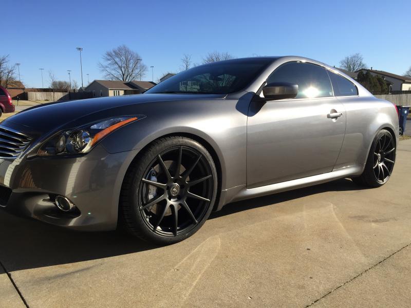

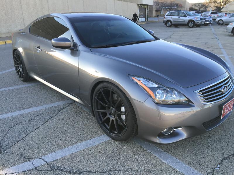

I am lowered on Eibach ProKit and have a 20x10.5 +35 wheels in the rear with 255/35/R20 tires. With that being said, the tire is VERY close to touching the fender liner and bumper bracket. I do not rub at all, but I would foresee a 285/30 tire rubbing and require trimming both. I am also in the Chicago area.
