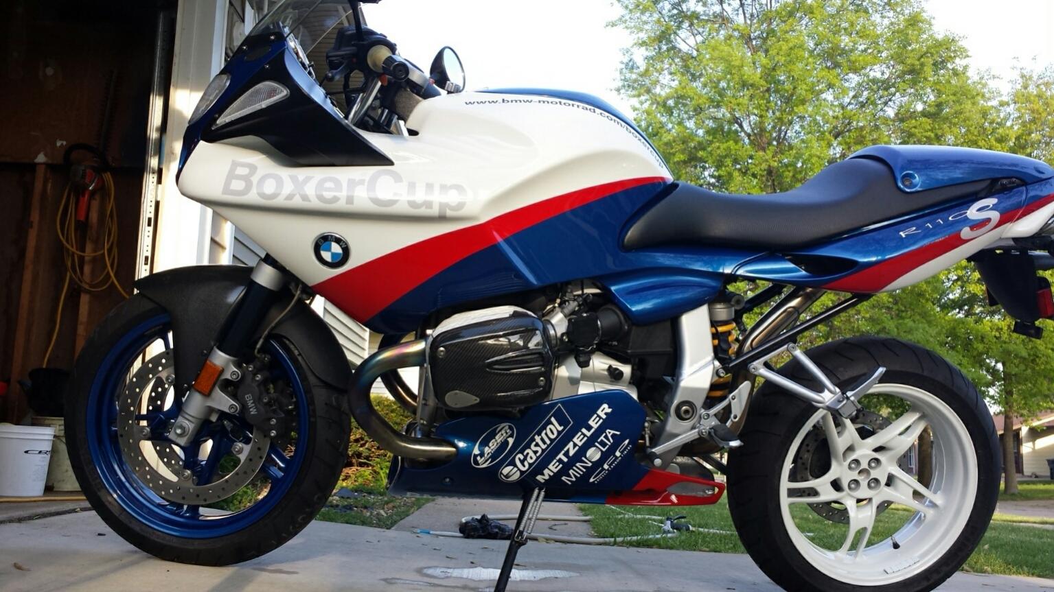

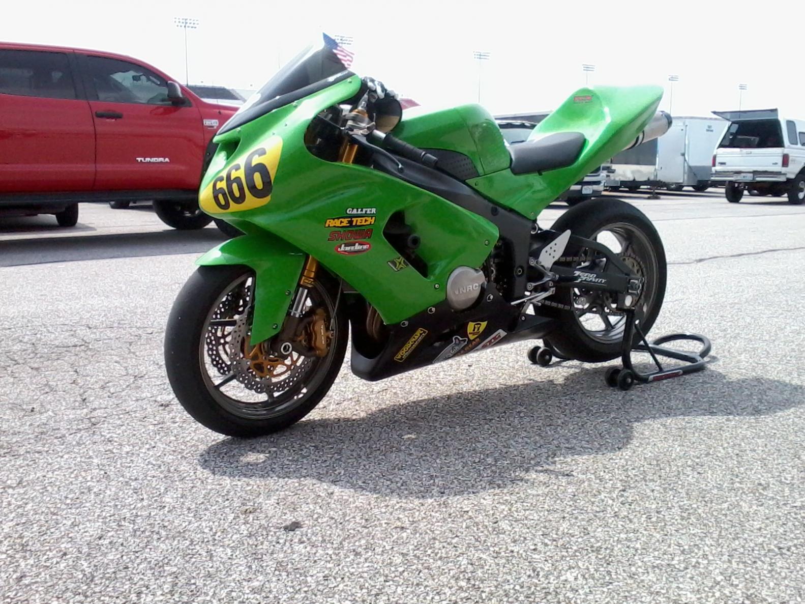

This is a popular misconception, as well as the notion that drilling holes in rotors affects their ability to absorb heat. Drilled rotors are supposed to be able to shed heat better than non drilled rotors. The last thing you want is for your rotors to absorb heat, hence the reason they are vented in the first place. Take a look at the rotors on a high performance motorcycle they are FULL of holes, the amount of surface area lost to the slots and holes on automotive rotors is miniscule at best. Swept area is what stops you not surface area, that is why the Sport rotors, pads, and calipers are larger than the Journey rotors. Just so nobody thinks I'm talking out my *** about the motorcycle rotors, the G is my transportation these are my toys

Old Oct 6, 2014 | 09:25 PM
There's much debate on this & most other sites, I was just going by the general consensus around here I've had the slotted/drilled and blanks and haven't really noticed much difference TBH
I DO know my new Wilwoods w/ the 14" blank rotors don't exhibit fade compared to my previous Journey setup
Must say you've got some badas$ bikes Mr. Roadrash (hopefully your username hasn't occurred too often, I had my share from a 1980 Kawi Z1R)

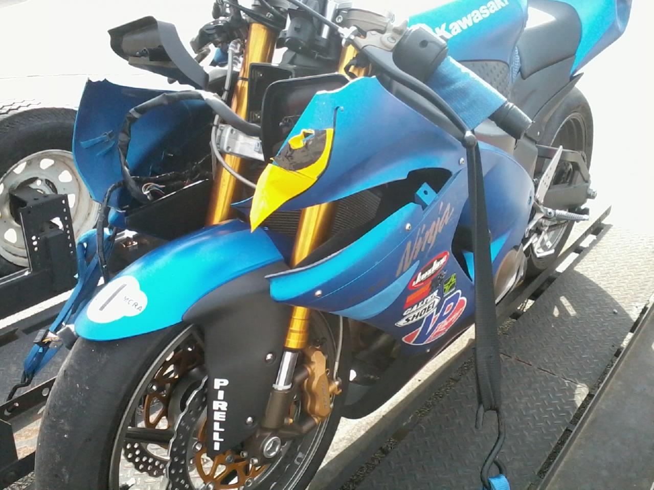

Thanks! Unfortunately I have pavement surfed plenty in the last 35 years of riding, lots of scars and broken bones. Most recently I crashed that Kawasaki on the race track, low sided it at 80 in a turn. Broke my ankle, two bones in my foot and 4 ribs. No road rash though, the cow hide did it's job. lol As far as those wilwoods go I bet they are VERY impressive
BTW look at the rotors on that Kawi they are swiss cheesed and have scalloped edges, if your ham fisted on the brake lever you will have a bike on top of you real fast. You can pick up the back tire from 140 into a slow turn lap after lap. Attached pic is after bike cartwheeled through the infield.

Old Oct 7, 2014 | 12:05 AM
R E S P E C T! Hats off my friend, serious survival skills you've got
