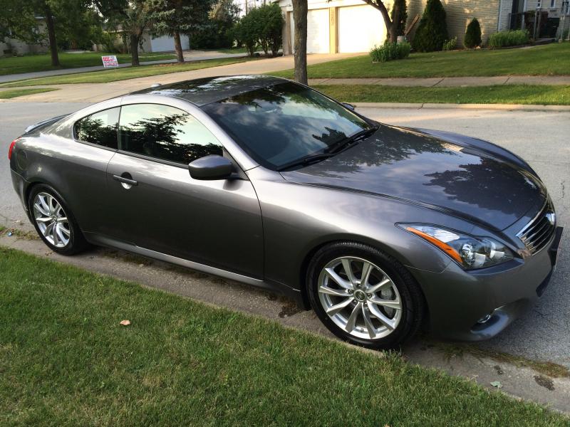

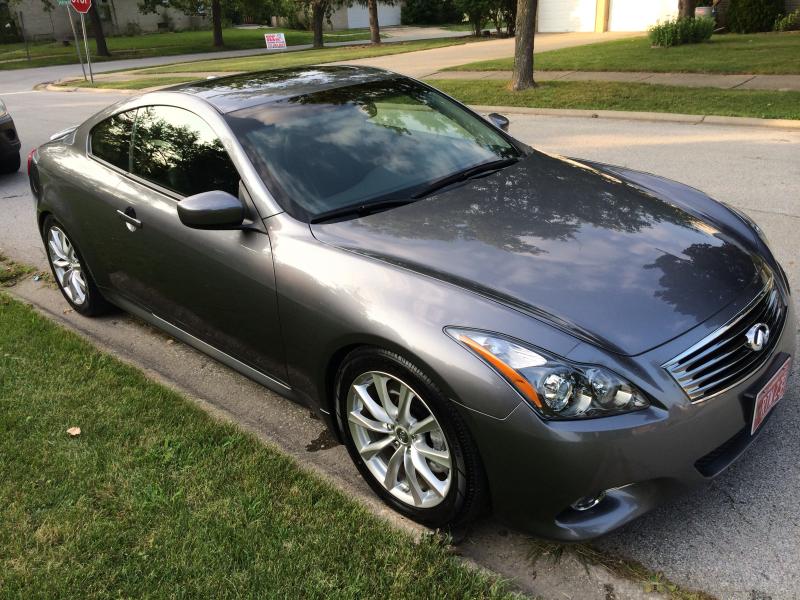

I was under the impression the stock coupe 18" wheels were 18x8 +43 all around. Right now I have 20mm front and 25mm rear spacers which make my wheels:
Front: 18x8 +23
Rear: 18x8 +18
Even with this setup, I would not call it aggressive or flush. I am lowered on Eibach Pro-Kit and I do not have any rubbing. Overall it looks good, but when I buy aftermarket wheels I will get offsets more aggressive than these to further fill out the wheel well.

The ride is a bit more firm, but it isn't jarring or unsettling. My previous car was lowered with Eibach springs and the ride was pretty rough. This is not the case with the G37 though. The car handles much better with the lower and wider stance. The car doesn't feel like a boat anymore and it feels very planted to the road. The better handling makes the car much more fun to drive and the lower look makes the car much better on the eye. I would say the positives definitely outweigh any negatives - not that I can really think of any. My car still makes it over speed bumps, curbs, etc. without any scrapping.
