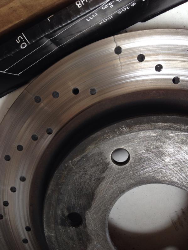

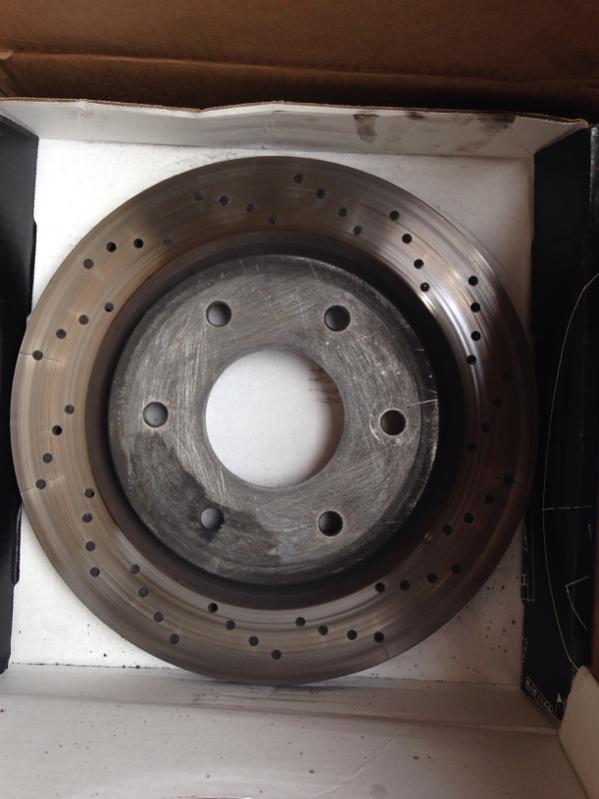

I was at the shop this weekend and found an example of why I personally do not recommend drilled rotors.
