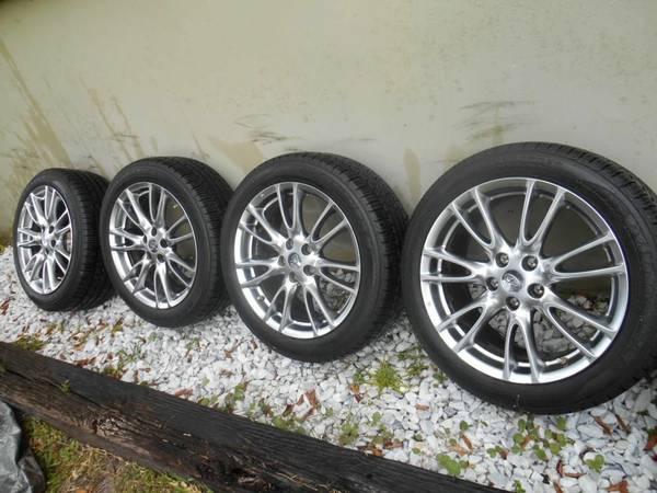

Stock 18" infiniti rims
I need some help identifiying these rims. Are these sport model rims of a g37s or xs, or are these standard 18's.
Im asking this because i have the akebono calipers and am in need of a set of winter wheels, so im looking for something with an offset that will clear the calipers. Thanks in advance.

I'm not 100%, but those appear to be G35 sport sedan wheels from a 2008-ish model.
Specs are:
18x7.5 +45 front
18x8.5 +50 rear
Old Dec 19, 2013 | 12:10 PM

Thats what im thinking, I would like to verify if they are staggered or not and if they would clear sport calipers.

From the picture? I don't know if it's possible to just look and tell you if they're staggered. I posted the specifications; what else are you looking for?

Hang on, let me calculate it.
Based on this diagram:
http://www.conceptzperformance.com/i...nttemplate.pdf
and this calculator:
Custom rims, wheel tire packages for your ride - RIMSnTIRES.com
I *think* they'll clear, but you should probably double check with your own math just to be sure. You'll have about 10mm less back space, but I'm pretty sure that's still enough to clear the brakes.

yea, i did the math and i dont think they will clear unless i get spacers which im not too crazy about...ill just stick to the 2010 + sedan sport rims.
