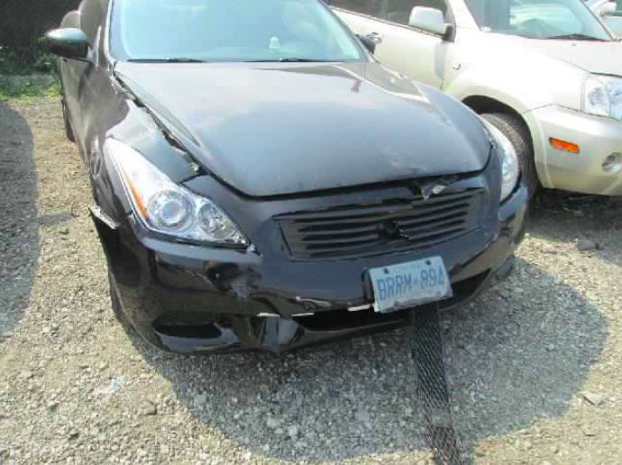

I should mention I was involved in a pretty nasty accident. I rear-ended a car in front of me doing roughly 60 kph (~39 mph) or so (the car in front of me smashed into the back of a car and in turn, i hit the back of him). Airbag deployed; other then that it was only body work. They didn't write off my car; they repaired it.
All in all, i've been debating whether its simply due to the poor road conditions or if there is actually something wrong with my car. It took a month to repair my vehicle and I don't really remember how it drove prior to that. At the end of the day though i'm not overly concerned; no shop ever told me there was anything wrong and it's still a joy to drive my G

Short of having another G right next to it for comparison it would be hard to ID the culprit.
Might want to jack up the back and use jackstands so you can safely examine all the parts closely and compare them to the drivers side parts. Hopefully something might stand out or might see a nick or fresh sign of an impact on one of the parts. Alignment is a pretty fine adjustment so it wouldn't take much to be off.

Sorry to hear about the accident. Hope insurance co. took care of you. If the car behaves and drives fine, but on uneven road, the car follows the path of the grove, it might be a case of tramlining like Blnewt said.

The absolute first thing I would do is take it to a shop that specializes in suspension work. Try to find a place that does stuff for autocross and such. I had a bunch of steering complaints with my CPO that 3 dealer appointments (including 2 alignments) failed to fix. A single alignment at a dedicated shop (which was half the price of dealer alignments btw...) fixed it. I couldn't believe how much better the car felt.
Never underestimate what a good alignment will do (or a bad one for that matter).

Drove little over an hour to a performance shop in L.I. Explained the problem and we took the car for a test drive. The roads are smooth and flat so its going to be difficult for tech to feel the problem I am describing. Tech then took the car to a road with lots of tight turns and dips. Needless to say the ride was exhilarating... Gotta admit my butt pucker up during on coming traffic. Later the tech said he use to race and taken that road many times doing over 100. Unfortunately he said there is nothing mechanically wrong but not to say there wasn't anything change after the impact. He didn't charge for the diagnostics and was very friendly. I won't hesitate going back for future work.
