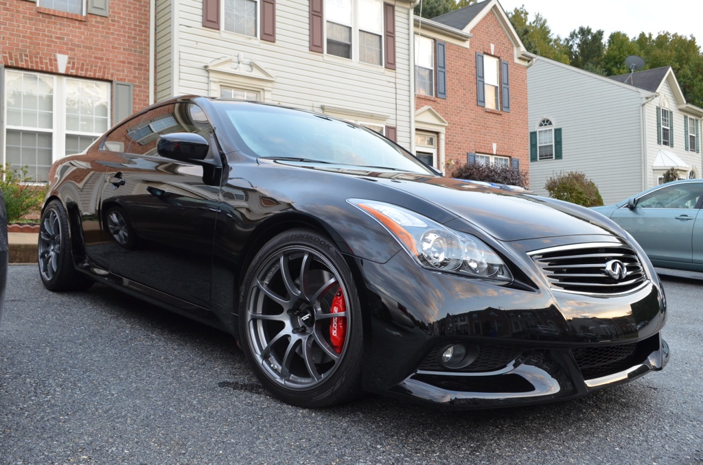

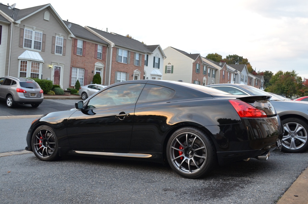

I had 9+25 F/10+25 R with 245/275 tires and it was perfect. Could've gone a bit lower but it was low enough for my taste and the roads around here.
Pictures are worth 1000 words right? Here's a couple so you can see what my old setup looked like.
Wow! Thanks so much! Gee I've been looking all over for more examples but lacking pics heavily haha.
That looks great but would you happen to have a shot from the rear fender straightforward? I'd like to see how it lines up with the rear fender line.
Also I see that you have Akebono brakes. Did it have any problem w/ fitment against the RS wheels?
