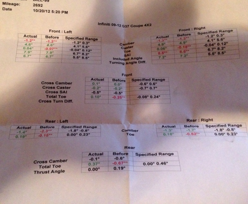

Installed Eibachs about 2 weeks ago now, went out of town on vacation so just got back and got the vehicle aligned yesterday.
I have a rear camber kit, decided not to get the front, wondering if I should now though.
These are specs after alignment, rear is perfect, front is right on the edge of specifications...just wondering on opinions of someone that is more knowledgeable than myself.
Will I be alright or should I get the front?
Thanks!

You are fine without the front camber kit.

Ive ran mine for over 35k miles without a camber kit and never had a problem.

Did the car just sit those 2 weeks? You typically want to put a good amount of miles on those springs to get them broken in before doing an alignment.

Yeah, pretty much, but I Paid for a lifetime alignment so will get it re-done in a few weeks, was planning on having re-done once I got spacers added as well anyways.

Only thing I suggest is getting the rear toe bolts. You're still within the green but I'd say it could be still..I'd definitely get it closer to 0 cause toe will kill tires a whole lot faster than camber.

I did get rear toe bolts, wahhhh you think it should be better?

Actual I take that back. You should be fine. I wouldn't bother getting a front camber kit either.
