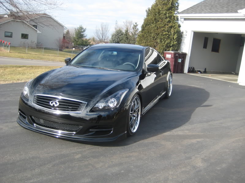

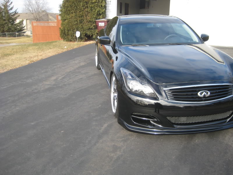

No matter what, a 9.0" wheels with a +32 offset will give you PLENTY of clearance, even with non-stretched tires. Right now I'm running a +30 offset on a 9.5" front, and there's absolutely NO WAY I could rub, and I'm slammed on KW V3s with 245/35/20 T1Rs.
If you use the new wheel and tire calculator HERE>> https://www.myg37.com/forums/tire_rim_calculator.php
you'll see that at +32 offset with a 9.0" wheel, you're actually 8.3mm MORE sunk then 9.5" wheel at +30 offset.
Even at +35 with a 9.5 inch wheel, your +32 offset and 9.0 wheel will STILL be sunk 3.35mm.
You will be 3.35mm MORE sunk then this....
You will be 8.35mm MORE sunk then THIS

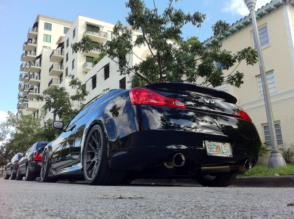

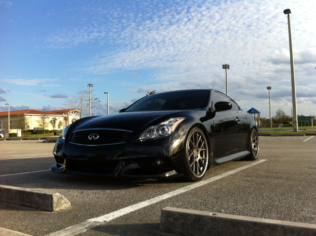

Here you go!
20x9.0 +32 255/30/20

What's been done to the suspension on this one?
Thanks
Originally Posted by Vossen Wheels
Here you go!
Old Jul 4, 2012 | 12:49 AM
Diego@Vossen's Avatar
Diego@Vossen
Joined: Aug 2010
Posts: 3,838
Likes: 271
From: Miami, FL
Tanabe coils and SPC F&R Camber kits!
Offsets are +32/45 with 255/30 & 305/25
