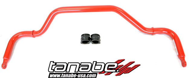

Anyone tried or have review on the tanabe ones?
Tanabe USA Inc. - Sustec Stabilizer
It looks like the first picture...

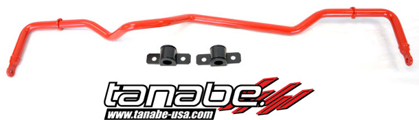

Tanabe TSB063F
36mm Front
NON-Adjustable
Tanabe TSB063R
NON-Adjustable
22mm Rear
