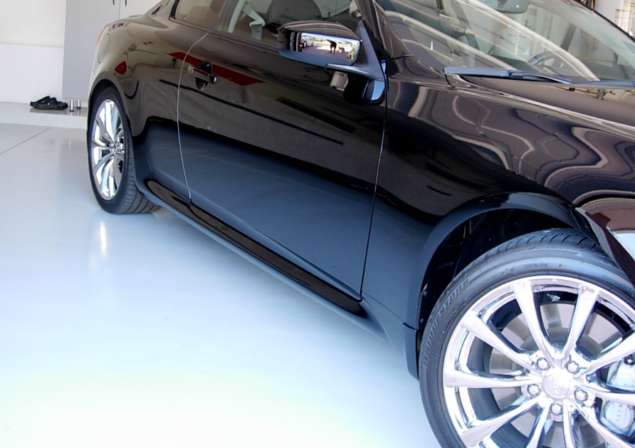

Former USMC's Avatar
Former USMC
Joined: Mar 2008
Posts: 137
From: So Cal
Originally Posted by Loi
Semper Fi,
Do you have any pics? Since I'm dropped on Eibachs, my wheels are a bit tucked, so imagine if I fit wider tires on it would look more aggressive and be flush with the fender line.
275's in the rear...
Attached Thumbnails 285/35/19 on OEM Sport Rears?-dscn0973.jpg
