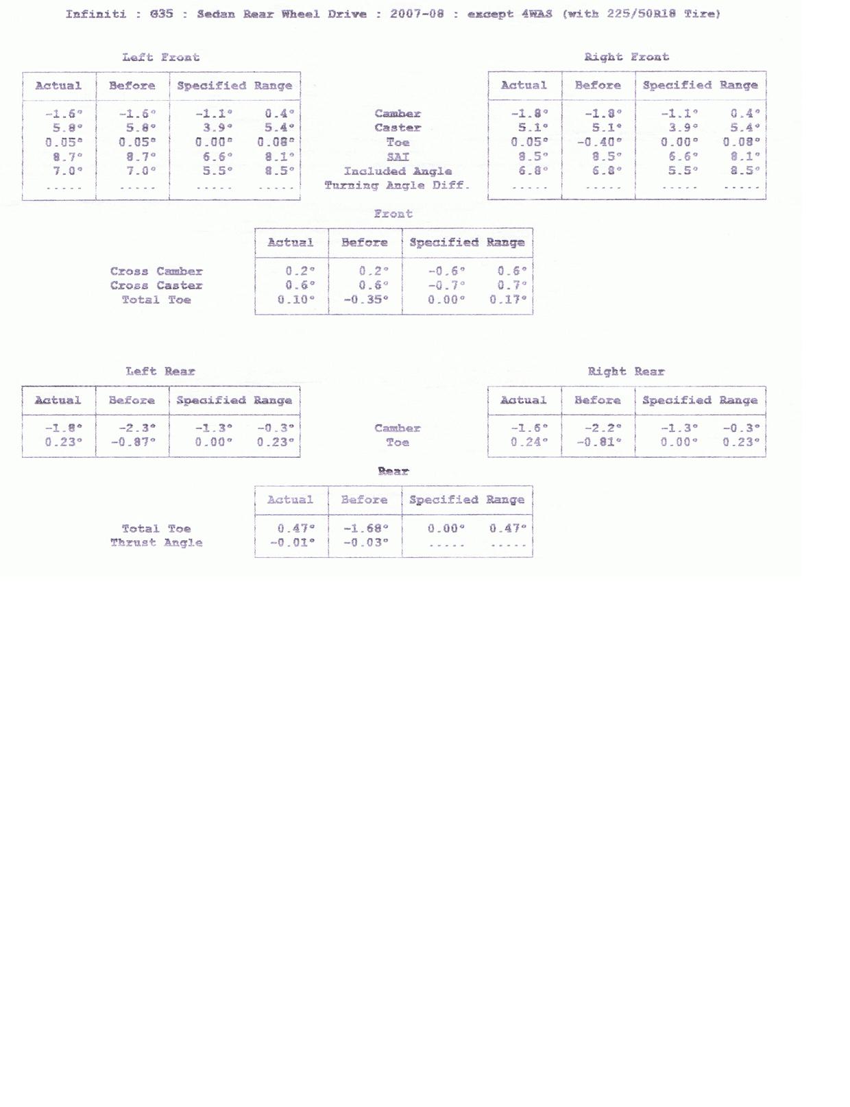

For what it's worth, I dropped my 08 G35S on eibachs today (no camber kit), and listed below is the camber after an alignment.
FL: -1.6
FR: -1.8
RL: -1.8
RR: -1.6

I'm assuming you meant G37S. Did you have the alignment done at the same time as the spring install? I suppose they gave you the camber specs before the alignment, did they? How was the toe-in?

Nope....G35S, which is why I prefaced it with "For what it's worth". Since no one else had posted numbers without the camber kit I figured I'd list mine to give you some idea of what you would be looking at.
Edit: Added alignment sheet

^thats not bad at all for camber. appreciate the posting! the toe on the rear tires is a bit high though. thats what will really wear your tires out. id recommend rear toe arms at the least.

It's not as bad as I thought, but I'll still be putting a camber / toe kit on. This is also right after the springs were put on, but I doubt they will change significantly. I'll post up a new alignment sheet, once I let them settle and get the kit installed. It will be interesting to see just how much it does change when the springs settle.

thanks andrew. ya i know the 35s had a bit of variance car to car. some people were able to get back in spec and some werent. so far it looks like rear toe is the only thing really out of spec.
