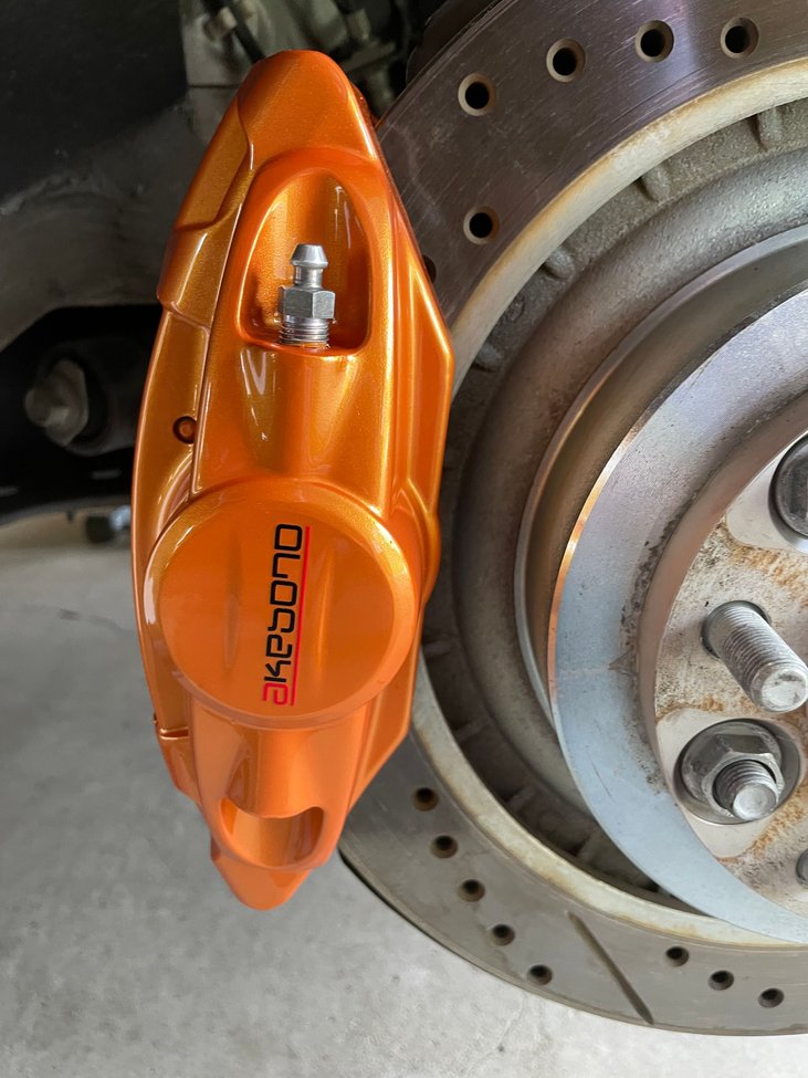

IdK where you are, but socket67 found a great, cost acceptable solution for painting the calipers (in California).
I am up in the PNW. I saw socket67's thread on brake color, but haven't been following. I'll take a look at it, thanks.
Old Apr 14, 2025 | 03:22 PM
Posts: 19,846
Likes: 5,143
Here's the link, jump to the end: https://www.myg37.com/forums/brakes-...socketz67.html
@socketz67 found a guy who does this on the car, at your location, and has done it enough times to bring some solid skills to the project. Pretty darn impressive, and very reasonably priced.
