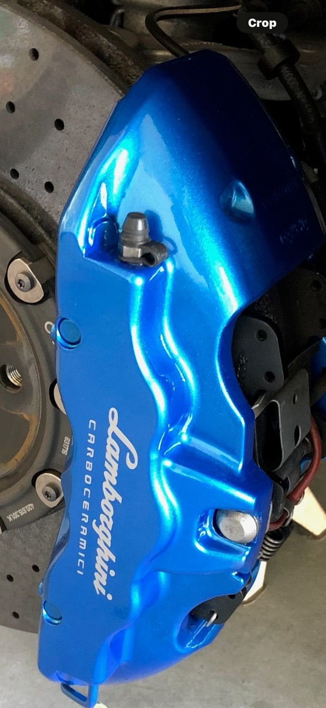

If you go to http://www.prismaticpowders.com/ and filter on Blues, the "Illusion Lite Blue" looks really, really good. Particularly if your decals are white.
@socketz67 create a free account there. IIRC, it was $15 for them to mail you 15 samples. Pick out a bunch of colors so you can get swatches in your hands and see things for yourself.
Old Nov 5, 2024 | 09:05 AM
Posts: 19,846
Likes: 5,143
That particular blue looks a lot like the Corvette in your profile, Socket.

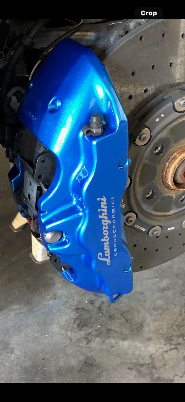

Love that blue. When I was a teen and built models, I painted almost all of them that blue.
Testors Sapphire Blue Metal Flake:

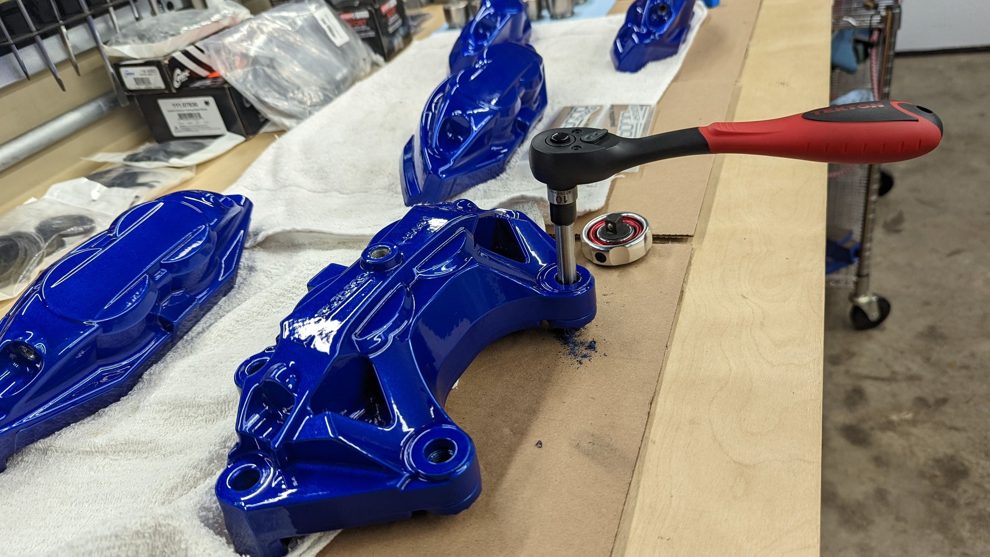

Just something to keep in mind, and was mentioned by my powder coat guy when doing my brakes.
The caliper will spend most of it's time in the shadow of the wheel/car so will naturally be darker and more muted in appearance. I thought he made a good point and this convinced me to go a few shades brighter to achieve the look I desired.
Also has Rochester mentioned the PC typically requires a full media blast to prep and my junkyard calipers needed it which was another reason for going to PC. After returning from PC I had to clean the threads of the mounting ears which wasn't ideal but I find the rebuild process cathartic and gave me a reason to tinker in the garage during the cooler months. Not wanting to thread jack just want to share my experience to know what to expect.
Darker appearance with the overhead lights off
My PC guy didn't do a very good job protecting the threaded brake line holes from the powder, and the install shop had to clean those out. Ended up costing me a lot more $$ in shop time as they figured out why fluid was leaking. Would have been so much better if he just used bolts in those holes. Or simply if I had the wherewithal to clean them out before the install. (sigh)
There was a similar issue with the unthreaded holes for the pins over the pad plates, but I caught that before dropping them off for installation and filed them out myself. The pins wouldn't have gone through the holes otherwise, that's how tight the fitment is.
Just saying... be aware of what aspects of the calipers need to not be coated.

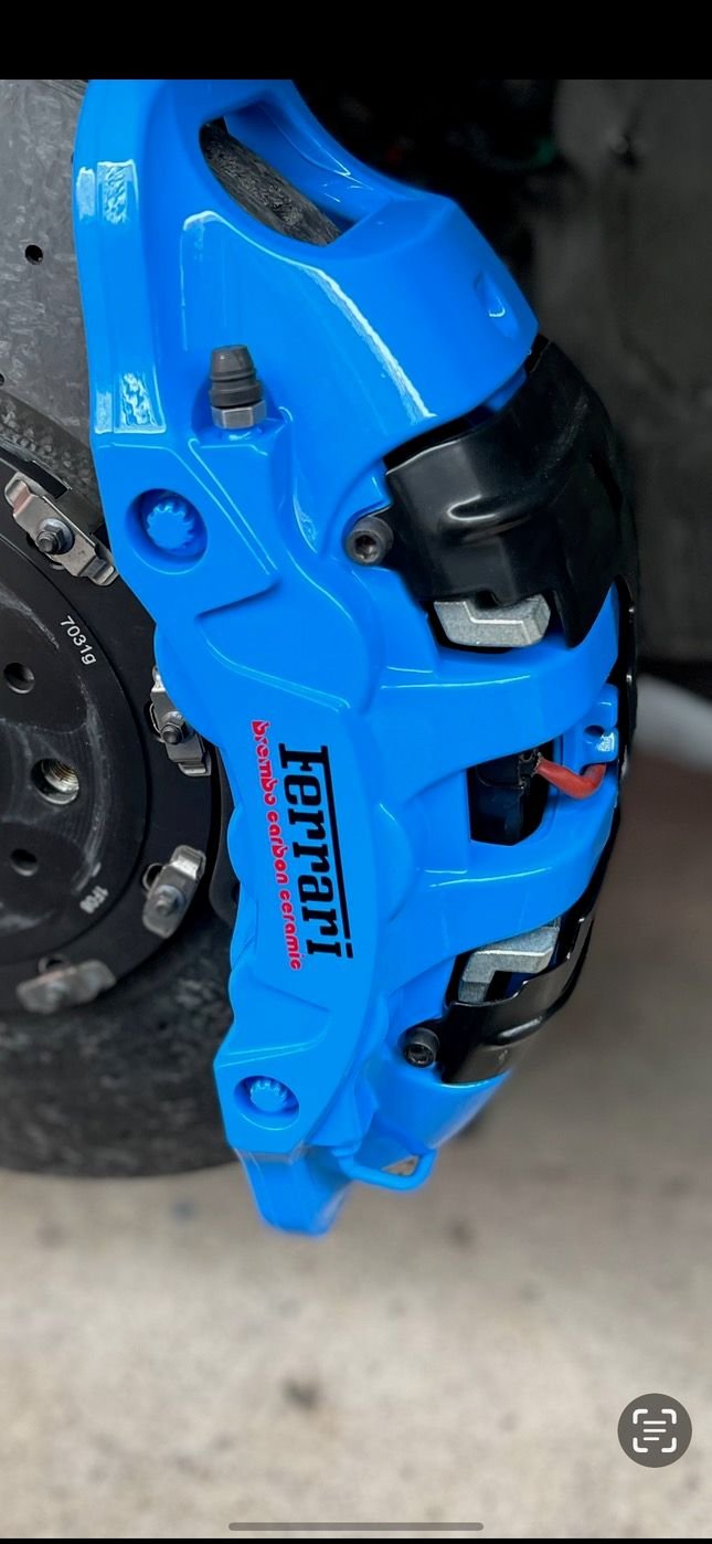

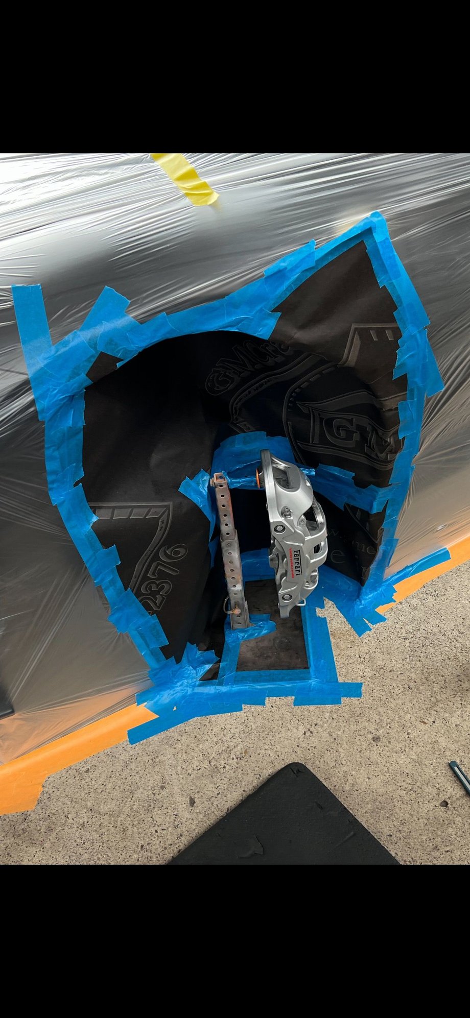

What are your collective thoughts on this color? It was recommended to me by the vendor I'm talking to after sharing some of the color discussion from this thread.
Ferrari Blue Corsa

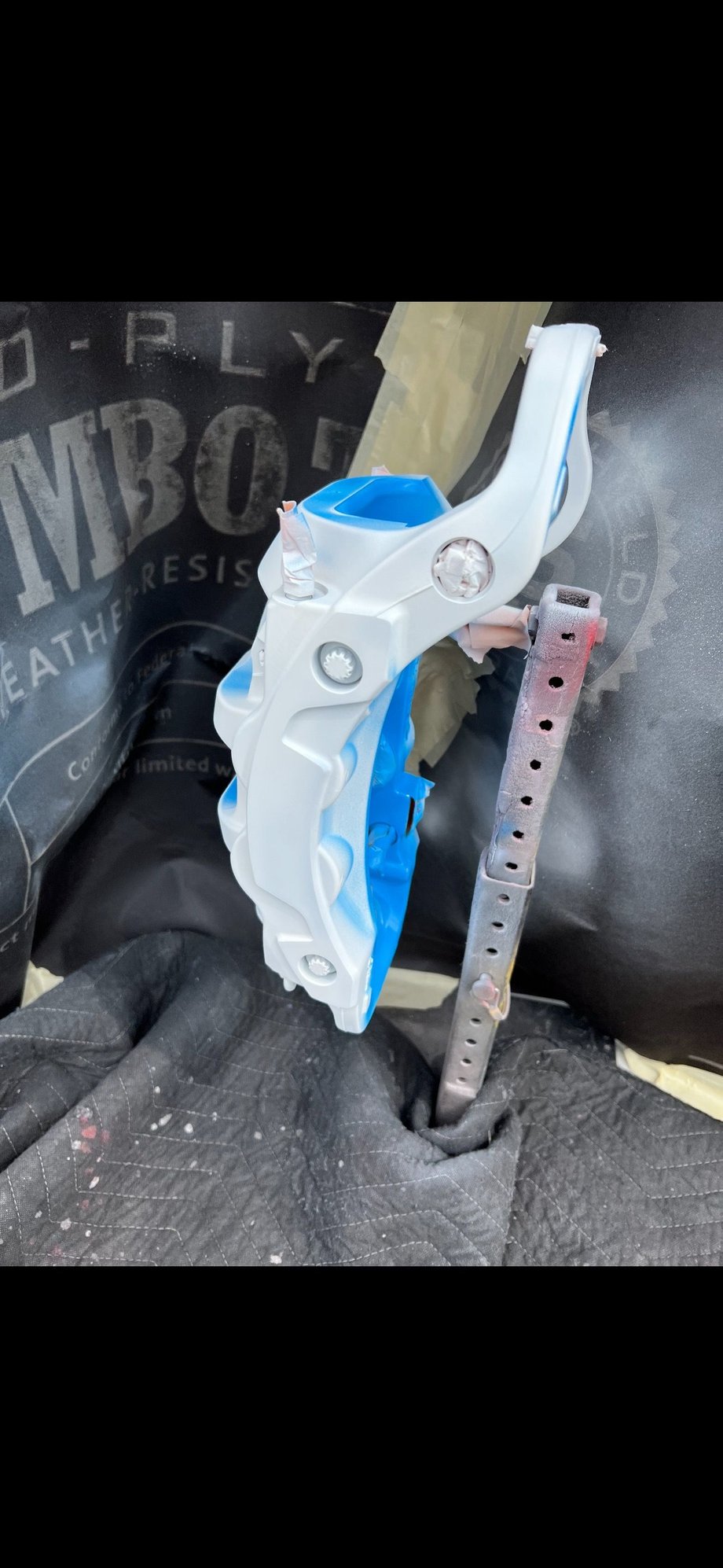

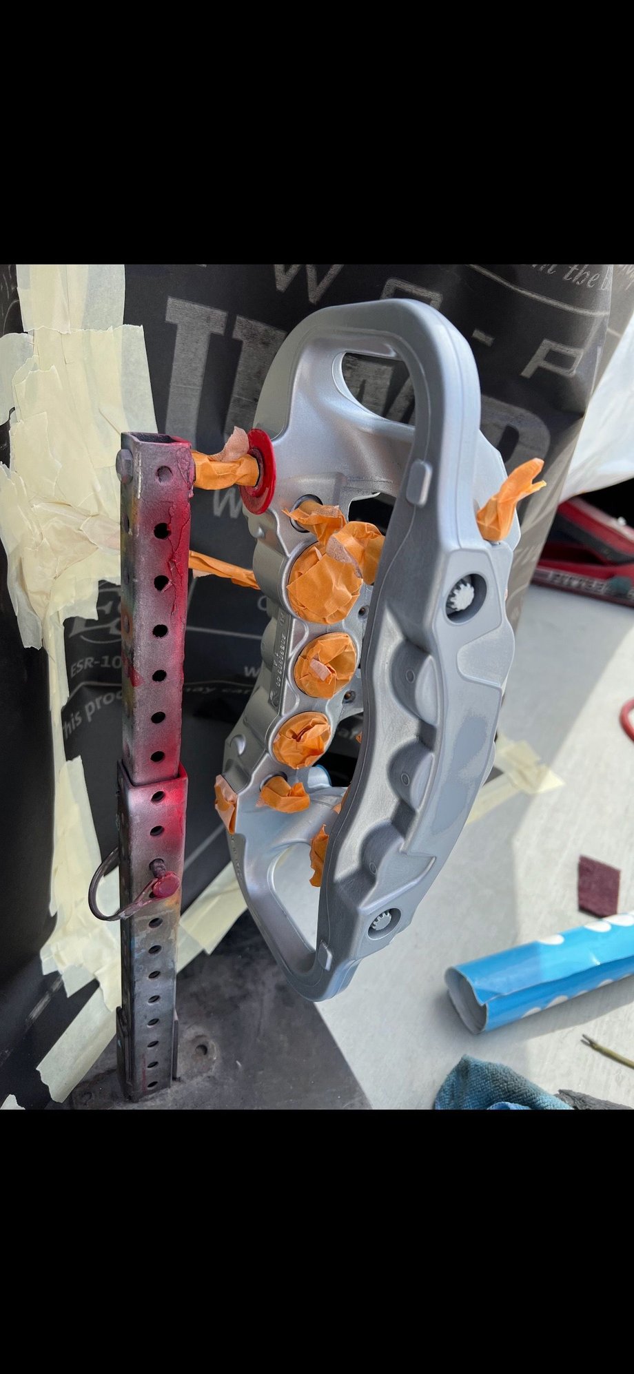

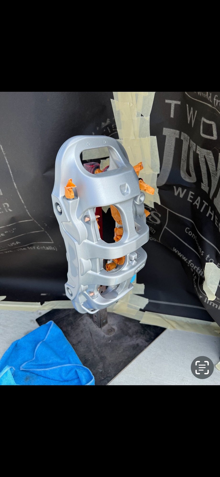

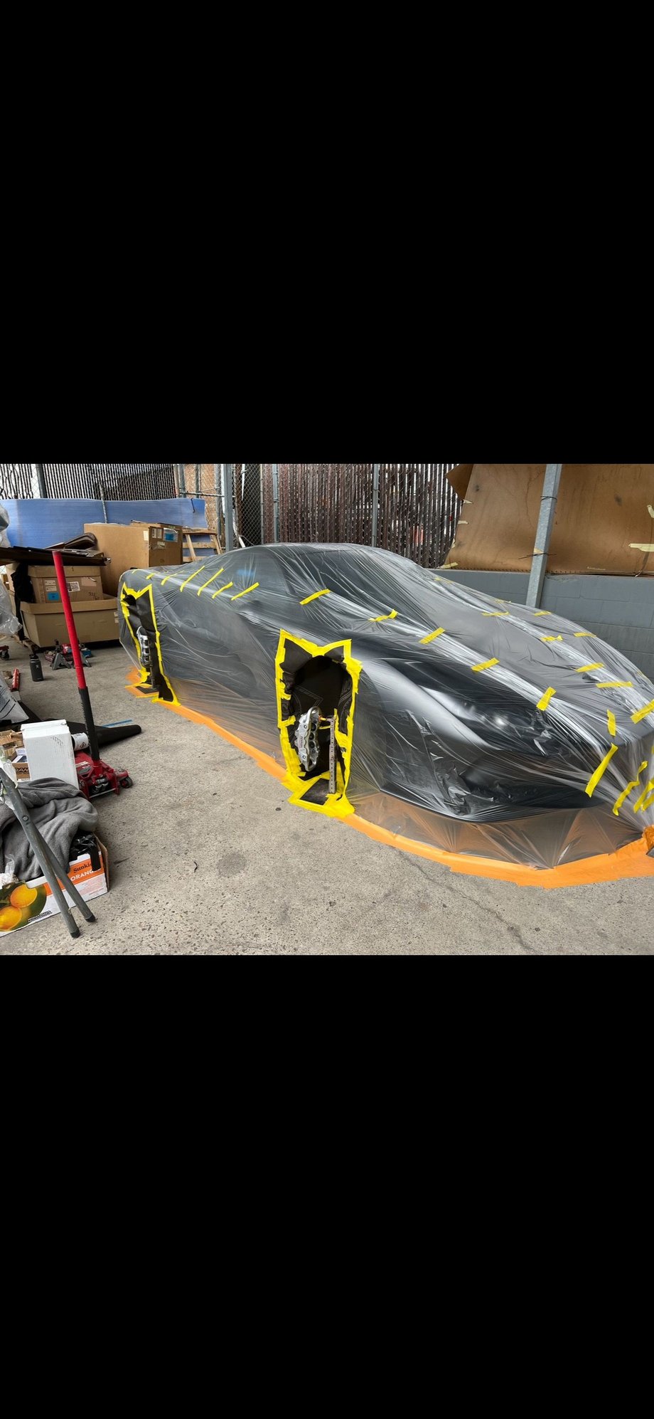

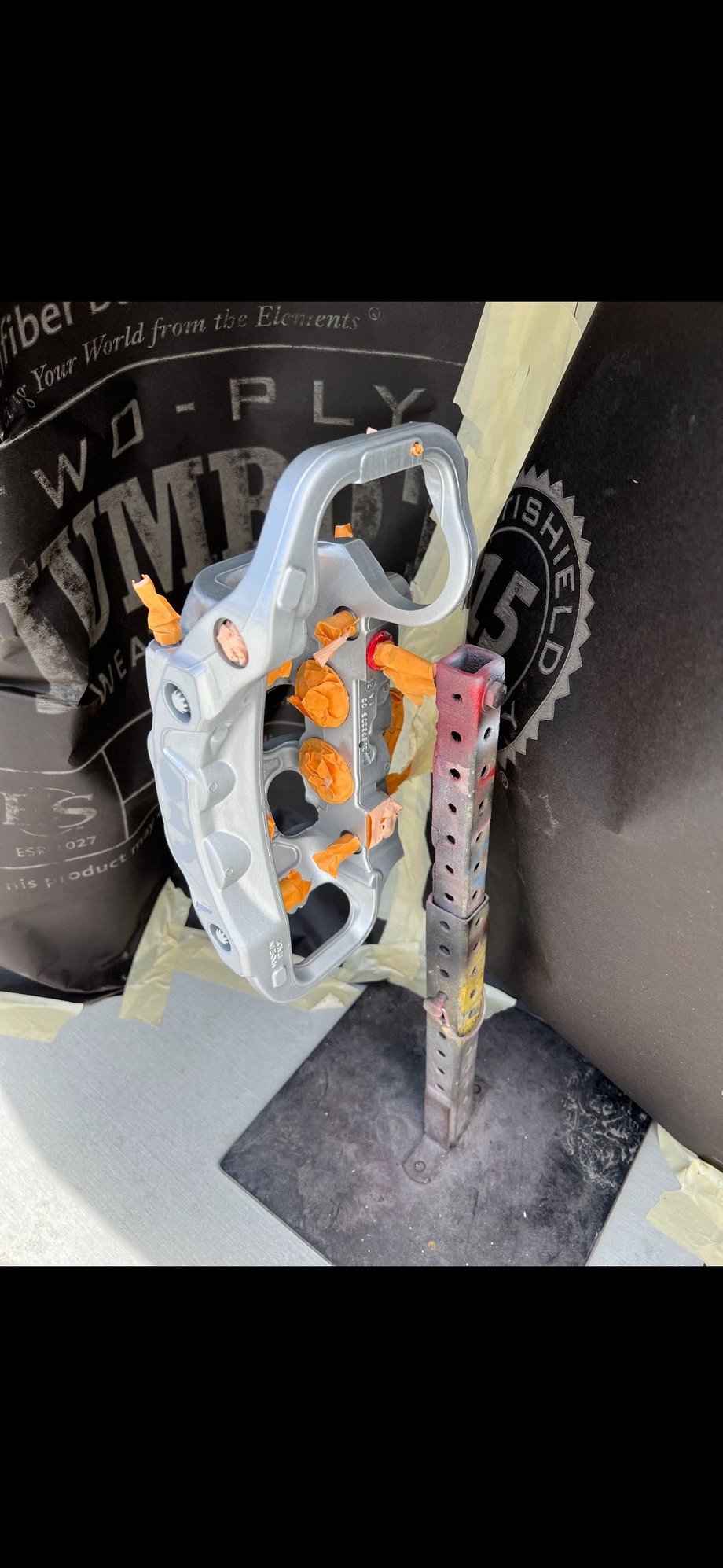

He has been in business for 25 years and does mobile work where he paints the calipers while still connected to the brake lines. All while your car is sitting in the garage.
Here’s some pics from his process:
Old Nov 22, 2024 | 08:24 AM
  #29
Posts: 19,846
Likes: 5,143
There's something about this blue that lacks the pop and metallic gloss of the other blue. It's not bad, but between the two I prefer the Illusion Blue powder. This Ferrari blue almost looks matte in these pics.
This shop that you're in contact with, are they local? He certainly has a solid process down pat, what with the whole-car masking, and the floor brackets supporting the calipers. That's pretty impressive, and if he's local that's a hard opportunity to pass, assuming the cost is acceptable. I suspect you've got some confidence that he'll do a good job, but at the end of the day it's still spray paint and not powder. Will it still look as good in another year or two or five? Probably not.

...at the end of the day it's still spray paint and not powder. Will it still look as good in another year or two or five? Probably not.
Paint will only last for cars that are considered "garage queens." Those that sit there, look pretty, and rarely see the road. Not many people daily Ferrari's, Lambo's and the like. I cheaped out and painted the rotor hats and roughly 8-years/25k miles later they are as dull as hen's teeth. (As my car will, eventually, get re-painted I'll re-address the calipers/ rotors then).
If you're going through the time and expense stick to powder coat unless you're considering this car for shorter-term ownership. Then you can go the cheaper, less intensive route.
But kudos to the shop/ tech... It appears he knows his stuff and respects the cars he works on.
