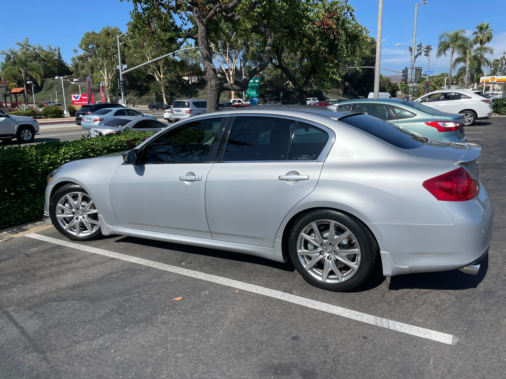

Clean looking car, Socket. Stock, but not stock. It would take someone who knows the car to notice the details.

@Rochester Thanks for the kind words. Similar to you, my goal with the car has always been to add elements to the car that enhance the OEM look, not change it completely. I always feel like I've succeeded when someone says "I normally don't like those cars, but for some reason yours looks better than most I see, but I don't know why". The problem with this approach is that the mod bug is short lived and one starts studying 370Z chassis bracing to figure out what's different from the G in order to invest in the next mod :-)
