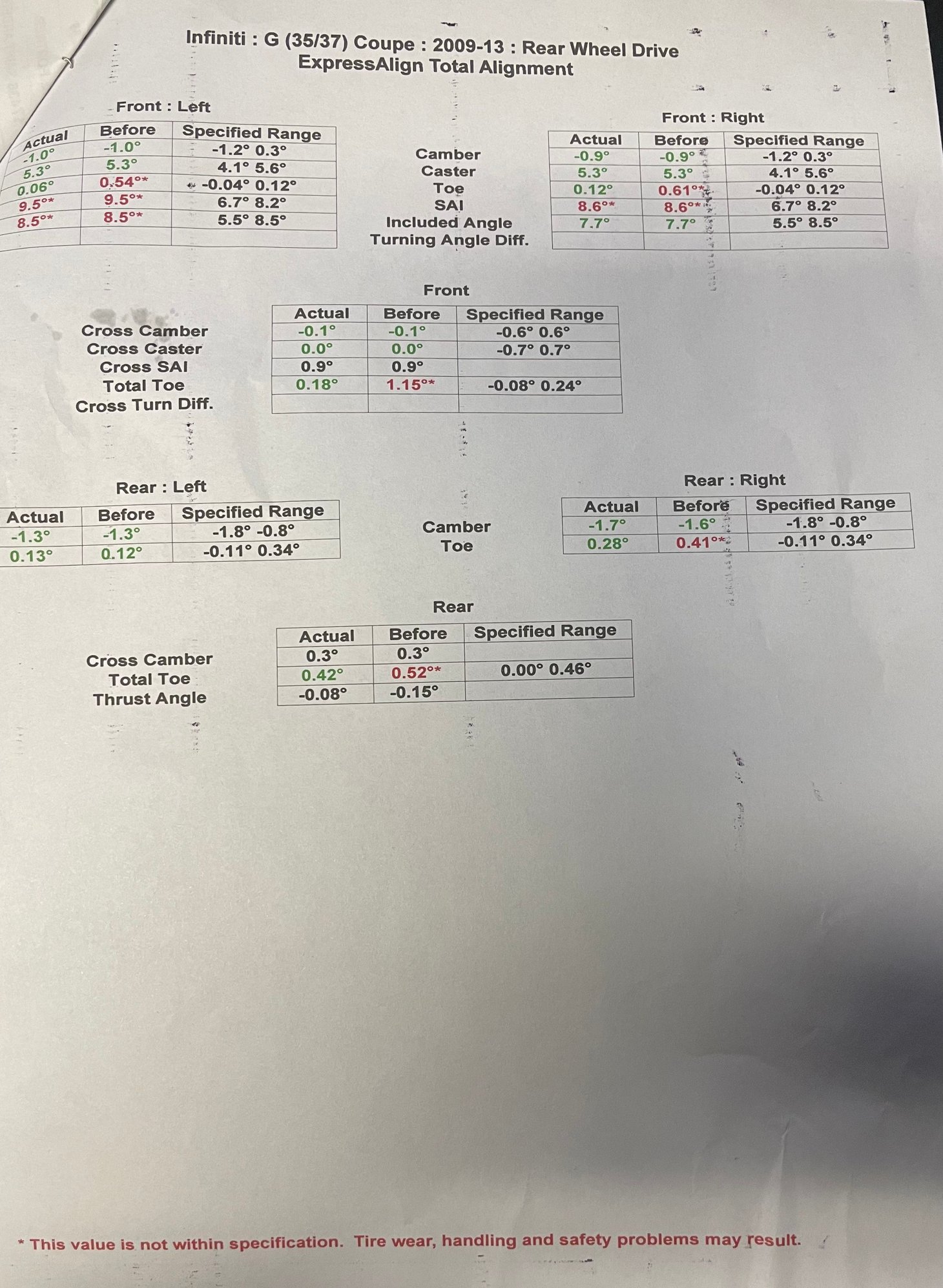

I will post new alignment specs once installed and realigned.
As noted above, here's the current specs based on the install of the SPC adjustable rear camber arms/toe bolts only.

Thanks for that info. I really like the SPC style because it's easier to adjust but didn't want to spend $600+ either. The Z1 has to be removed to adjust which makes no sense at all. I'm using SPC camber arms on the rear and just put on last week. Wish I had done it years ago. Also took it to a more competent shop for alignment and got my toe in spec. I'll never use Kauffman/Mavis again. They have told me for years my alignment was in spec and I chewed through tires every year or so. I'm going to watch my tire wear in the front a while longer before deciding to get adjustable arms since my toe is good now. But at least now I know where to get a better deal, thanks again.

I finally have everything within spec and I've noticed a 2-3 mpg improvement on the highway. The car also feels much better on the road.
