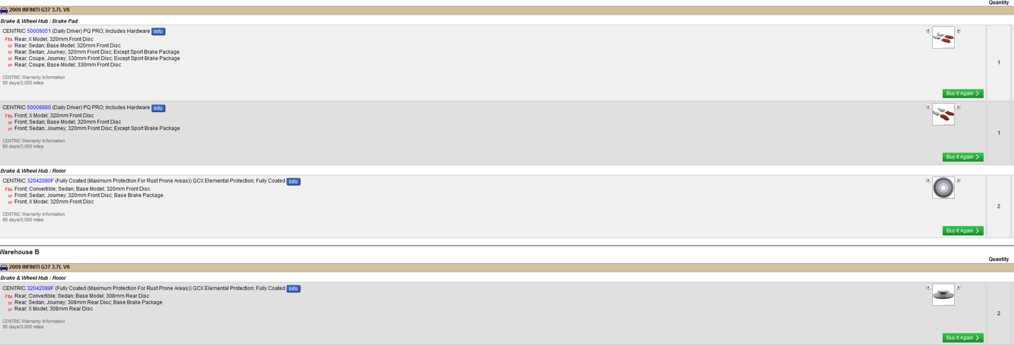

I have been on these PQ pro Centric pads and the GCX rotors and I love this as a OEM plus kit. 2009 G37x sedan here. My Rockauto order.
