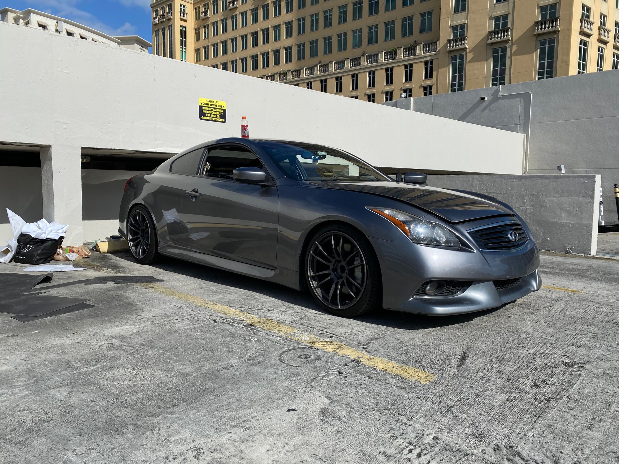

F14s look pretty cool. You know they aren’t forged tho right, Lol? My wheels are 19x9.5/10.5+35 and are a perfect fit. I stressed over wheel size for a while but finally figured it out. Not saying +25 is bad, I dunno. But I know my size is great. Hope that helps.
Pic of fitment for reference.

Below is a pretty dumb pic of my car but it shows the angle you want to see a little better. I had KW coils and swapped them for BC b/ I thought my KWs were bad. Turns out they were fine and it was lower control arm that was the problem. Talk about wasting money to downgrade my suspension.
I’m on 235/35 in the front and 275/35 in the rear. I think the tires on the car you linked (255/40) are WAAAAY too big. I’m really not a fan of the way his set up looks with those tires but that’s just my opinion. I may go up in tire size a smidge as I’m currently gearing my car to be a little more comfortable.

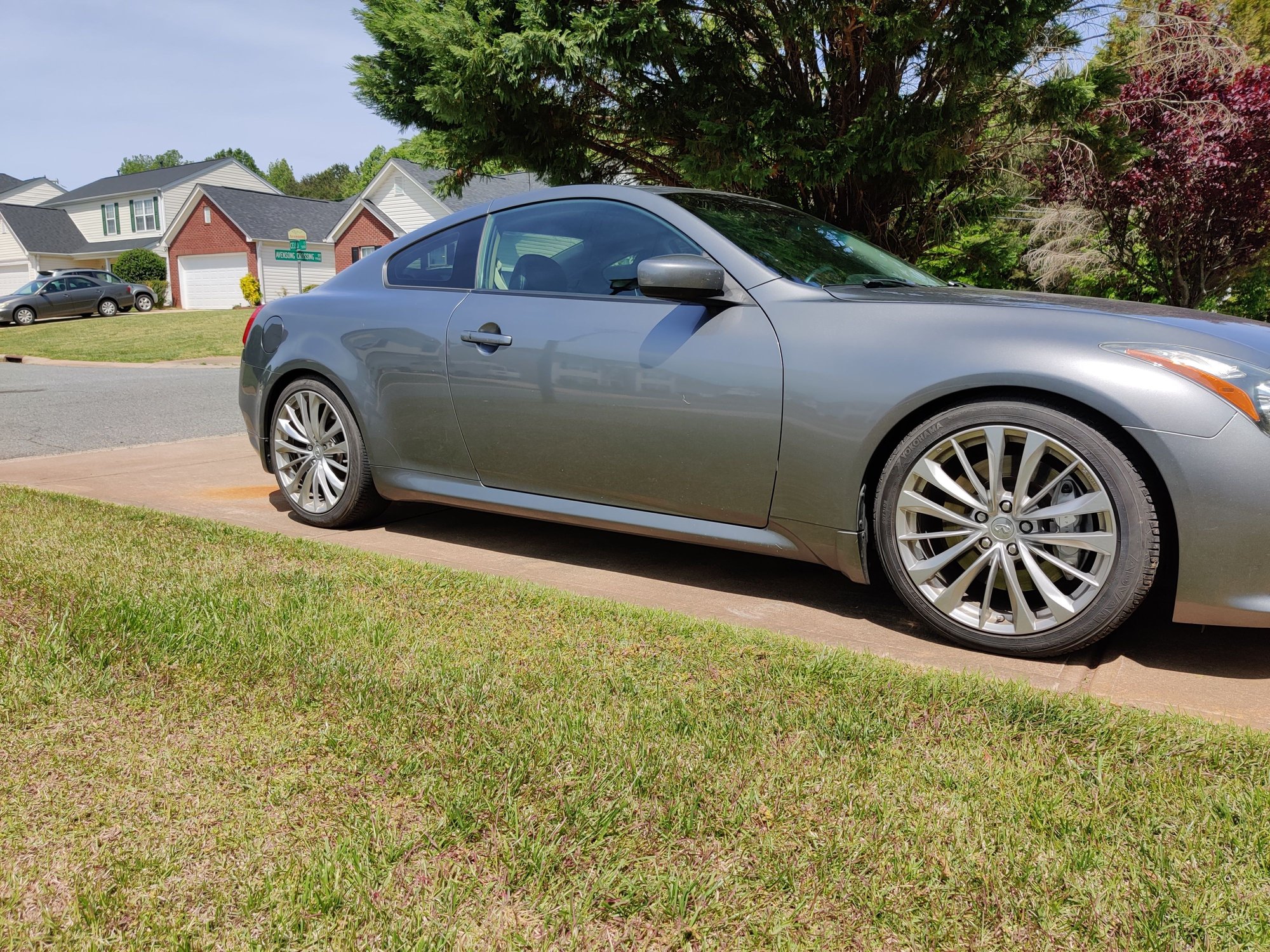

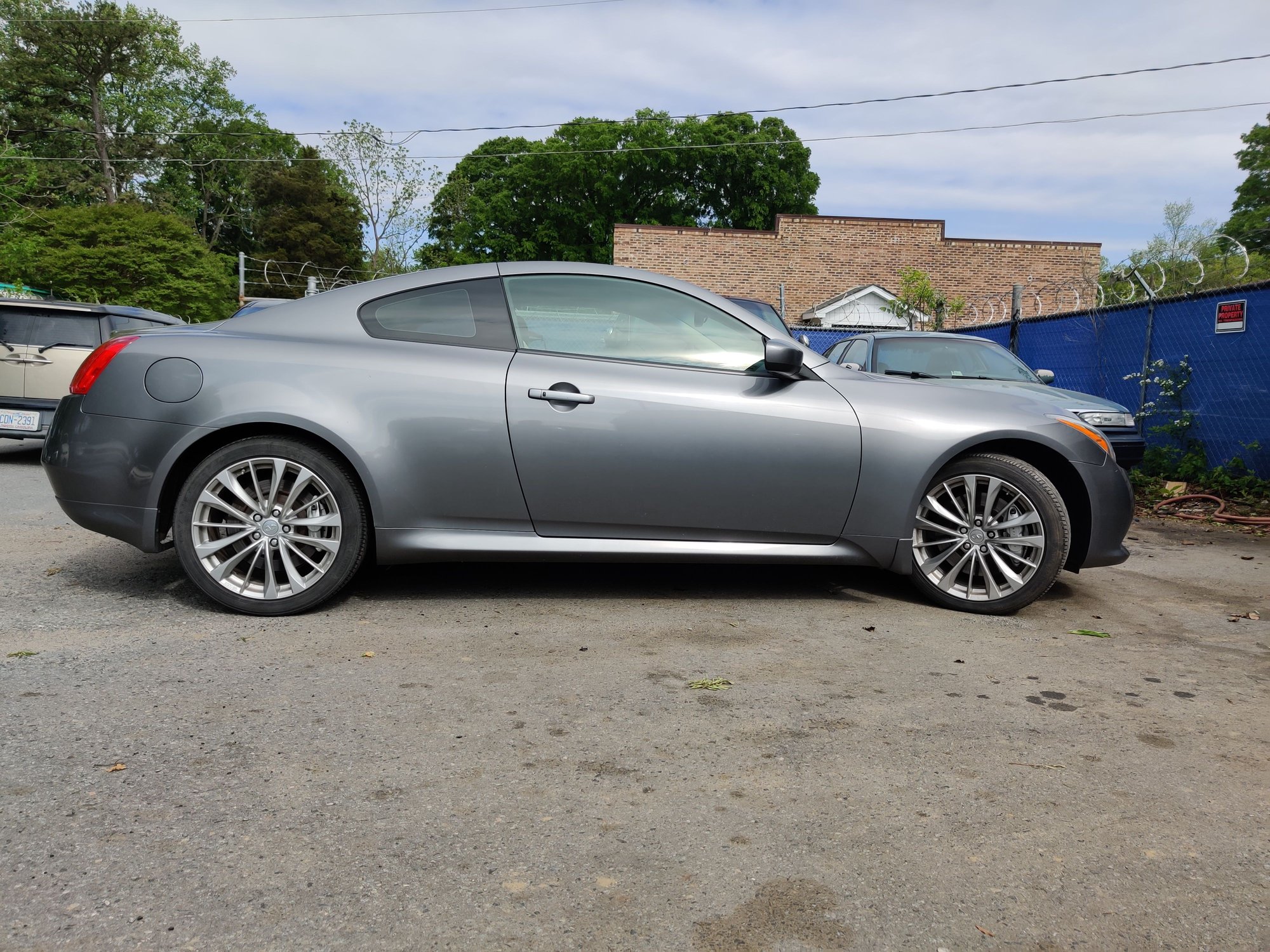

Finally got the work done over the last couple of weeks. First got the Eibach springs and rear G37 RWD sway bar installed, as well as H&R 20mm spacers all around, and a week later I had the SPC Front and Rear Camber kit and rear Toe bolt installed, with an alignment, and had the spacers retorqued. Car drives beautifully, and looks great with the drop. Before the camber Kit install and alignment the front was sitting at about 27" from ground to fender, and the rears were about 26.5". Afterwards all 4 corners are around 26.75".
Here are some before shots
And the After shots
With the 20mm spacers the wheels sit flush enough, with zero rub on stock 225/45 19's. Happy with how it all came out.
