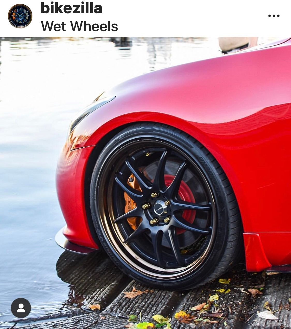

I have the DBA T3 ClubSpec 4000 Drilled/Slotted rotors (I wanted the "bling") paired with a set of Hawk HPS 5.0 pads and am very pleased with the setup. I have good initial bite, very little dusting, and have not had any issues at all.
I, too, have a tendency to get spirited from time to time. However it is important to note that my car rarely gets driven (1-2x/mo. at most). I installed this set 4/30/2017 and they barely have 4500 miles on them. So I can not speak as to how well this setup would hold up with daily use. I do know that they have saved my *** a few times with these idiotic drivers (tourists included) and their backwards driving habits.
Attaching 2 pics. Keep in mind the car hasn't been driven since mid-June so please excuse the surface rust. And, yes, I painted the hats red:
