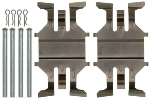

Raybestos Brake Hardware
Front: H18129A
Rear: H18130A
