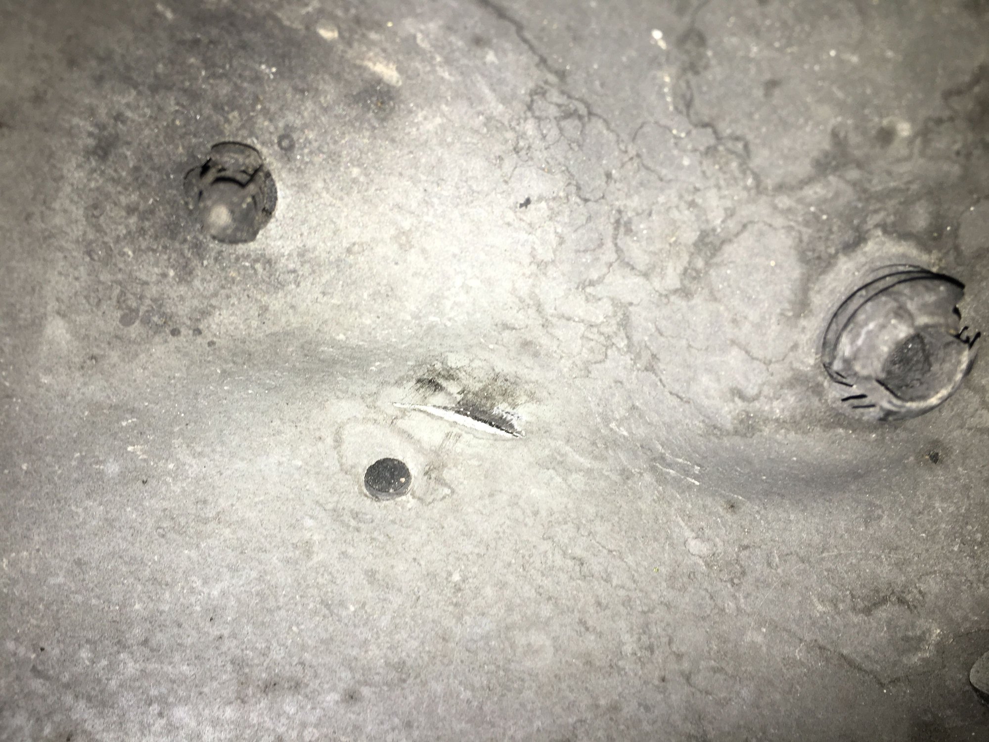

I posted this pic recently in a thread with tein basis coilvers
I have tein basis coilovers 26.25 FTG
front & rear spc control arms & camber kits
that lil Mark is where the top nut part of control arm is hitting that metal - it sounds bad in the car when yr driving & it hits -
Took those pics when car was on lift for rear tires
front right & left side had them
there’s no damage to control arm - just that lil mark & that loud thud sound lol
happens more when I have whole family of 5 in the car & going fast over a small bump or weird part of road
my other buddy say they hammer a little like other guy said or they cut that part out
Old Jan 19, 2018 | 09:28 PM
Kpmikey808's Avatar
Kpmikey808
Joined: Oct 2013
Posts: 273
Likes: 32
From: Vegas
Another option is to replace the SPC arms with SPL. They don't use that lock nut above the ball joint.
Slartibartfast I noticed some members tags spc rear & spl front controls
Maybe the hammer part would work??
Once I saw there was minimal damage & got use to that loud knock here & there
It has grown on me
But that first loud knock I heard scared me lol
