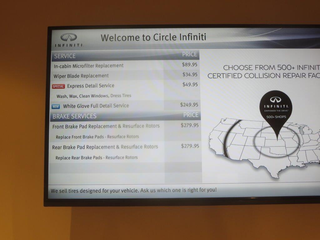

Originally Posted by Jen37S
Was told last oil change I did at Nissan that I need rear brakes done and would be $255. Set a Saturday appt, dropped it off and signed the ok for $255 of work and agreed to the extra half hour it would take for them to get the parts delivered. Get a phone call an hour later that it was going to be $500 and they couldn't get parts til Tuesday. So pick up my car the service managers saying he is sorry but due to my car being the "top of the line" Infiniti (sport) I have rotors that can't be resurfaced and just have to be replaced. I do know the S has bigger brakes but when I told him it was quoted $300 to do it the Infiniti he said to make sure I check with them bc I would run into the same thing. He did also say they would be ordering the parts from the same Infiniti dealership which I have put a call to but would like to be informed by folks here that probably have the skill set to change their own brakes. So am I just being overpriced bc I'm a woman they believe doesn't even realize she bought a sport model? I know the sport model has bigger brakes but does that mean the rotors have to be replaced with the pads seems excessive. Either way they couldn't even have the parts til Tuesday. I have an appointment for Sat the 20th with Infiniti but don't wanna just hear the same thing 2 weeks later. I was always so bad at car maintenance so the fact I was even there ready to drop 250 on brakes that are just lightly squealing was amazing but now I'm not ready to drop 500 before finding out if I'm being conned..
Get a second opinion at an Infiniti dealer
My local Infiniti dealer in NJ charges $279.00 and when I had brakes done on my previous 06 G35 at 86k miles 6 speed they turned the rotors on all four wheels.
